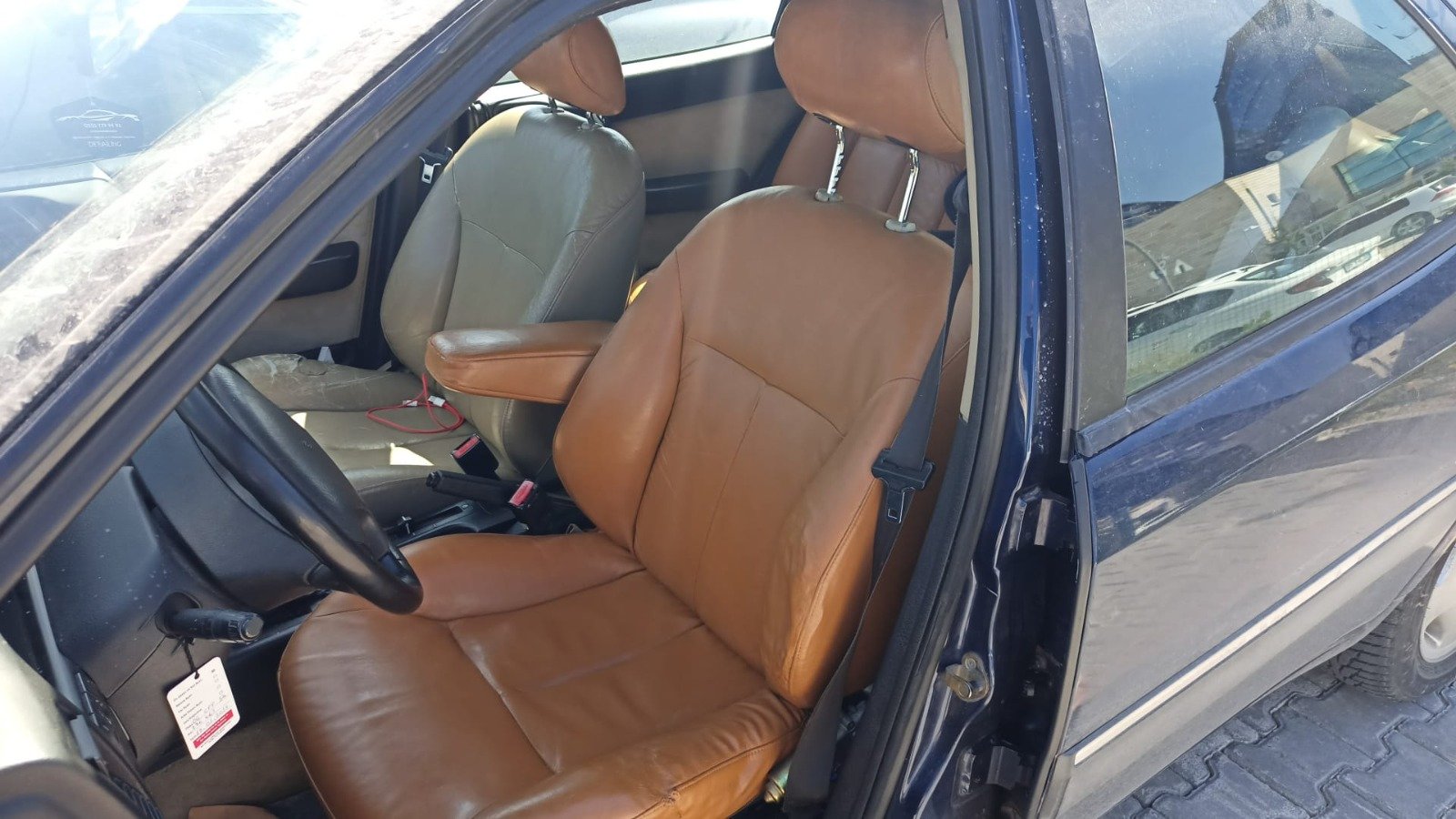

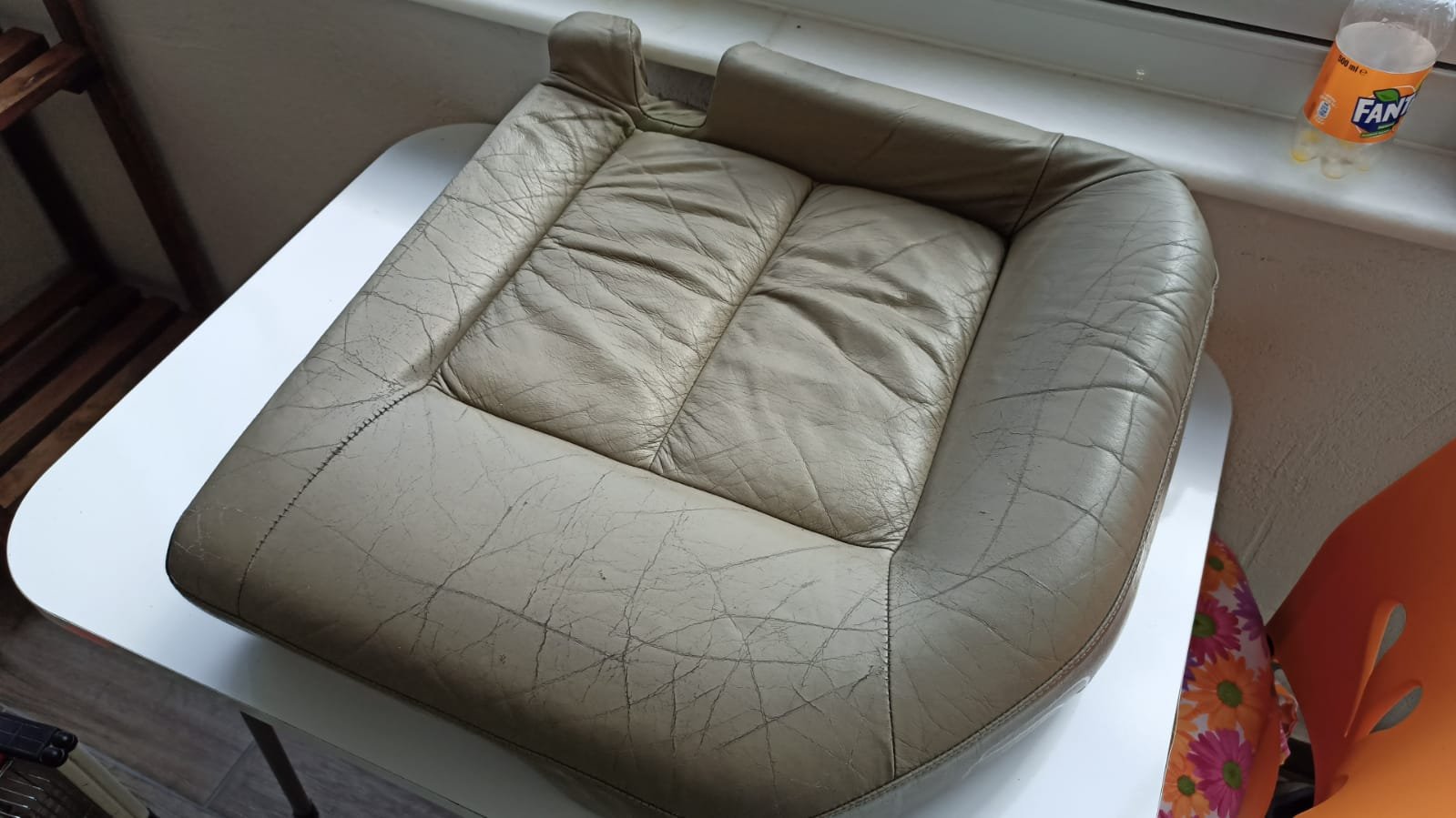

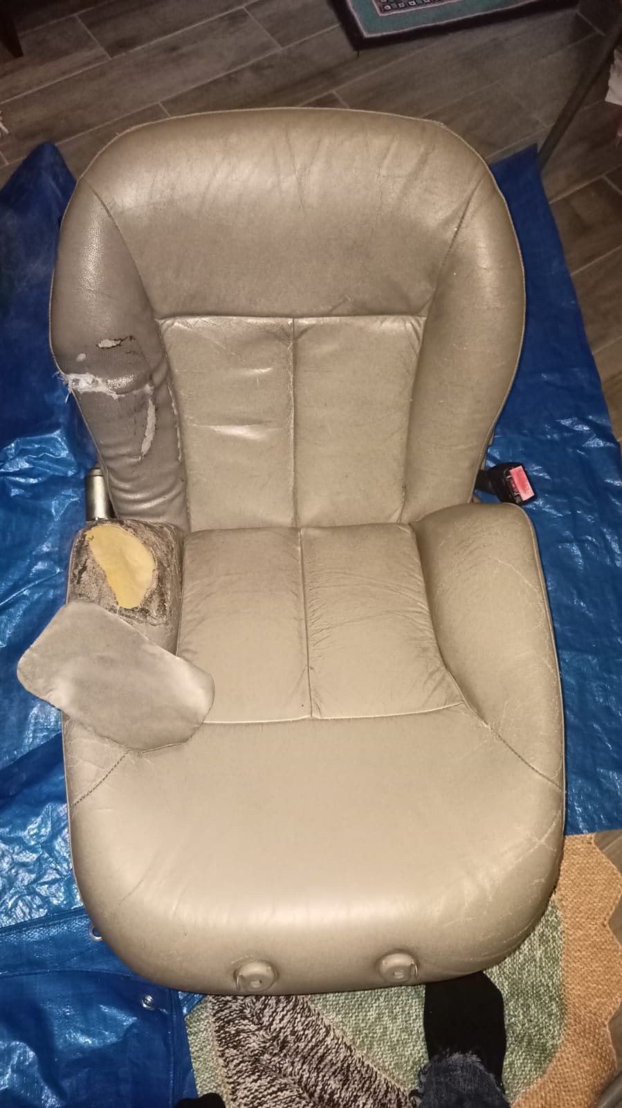

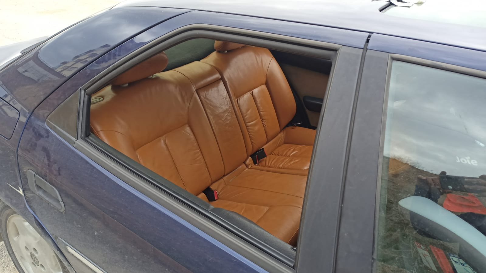

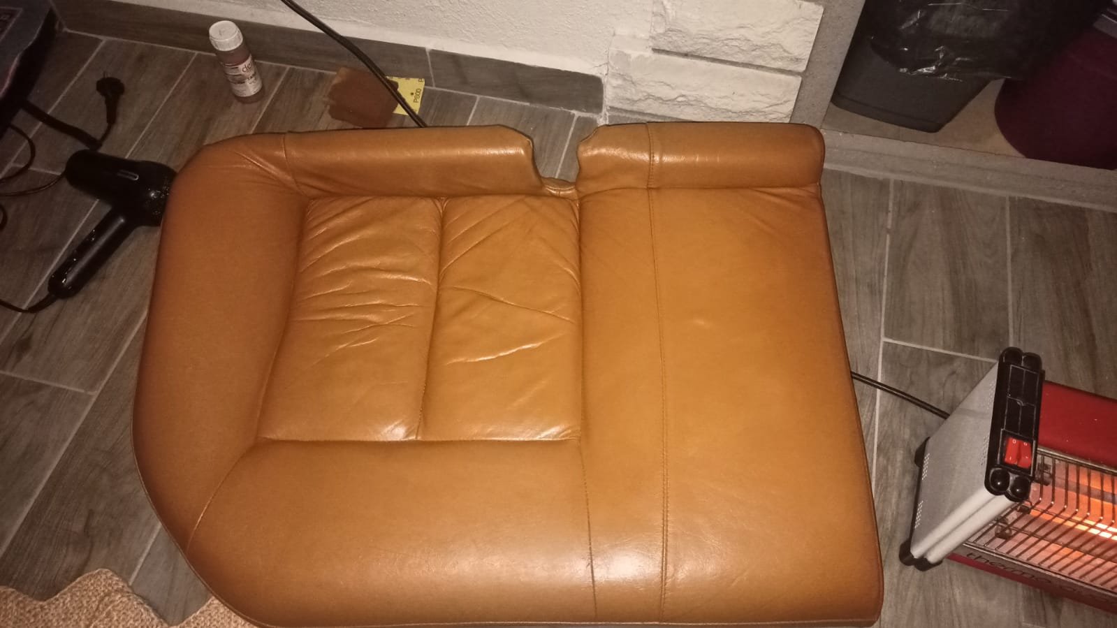

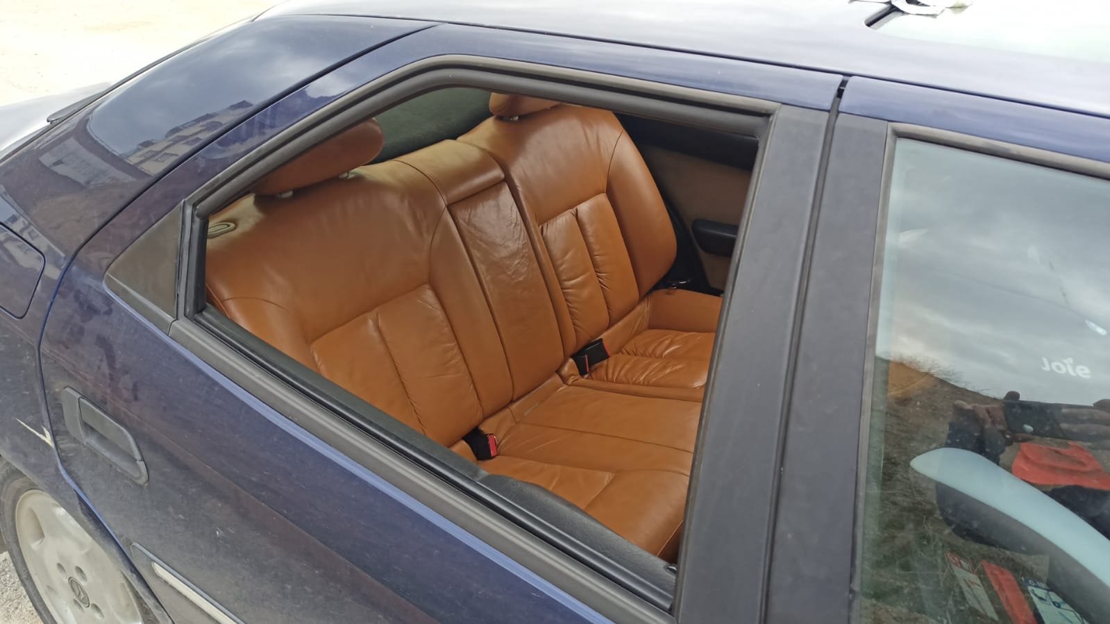

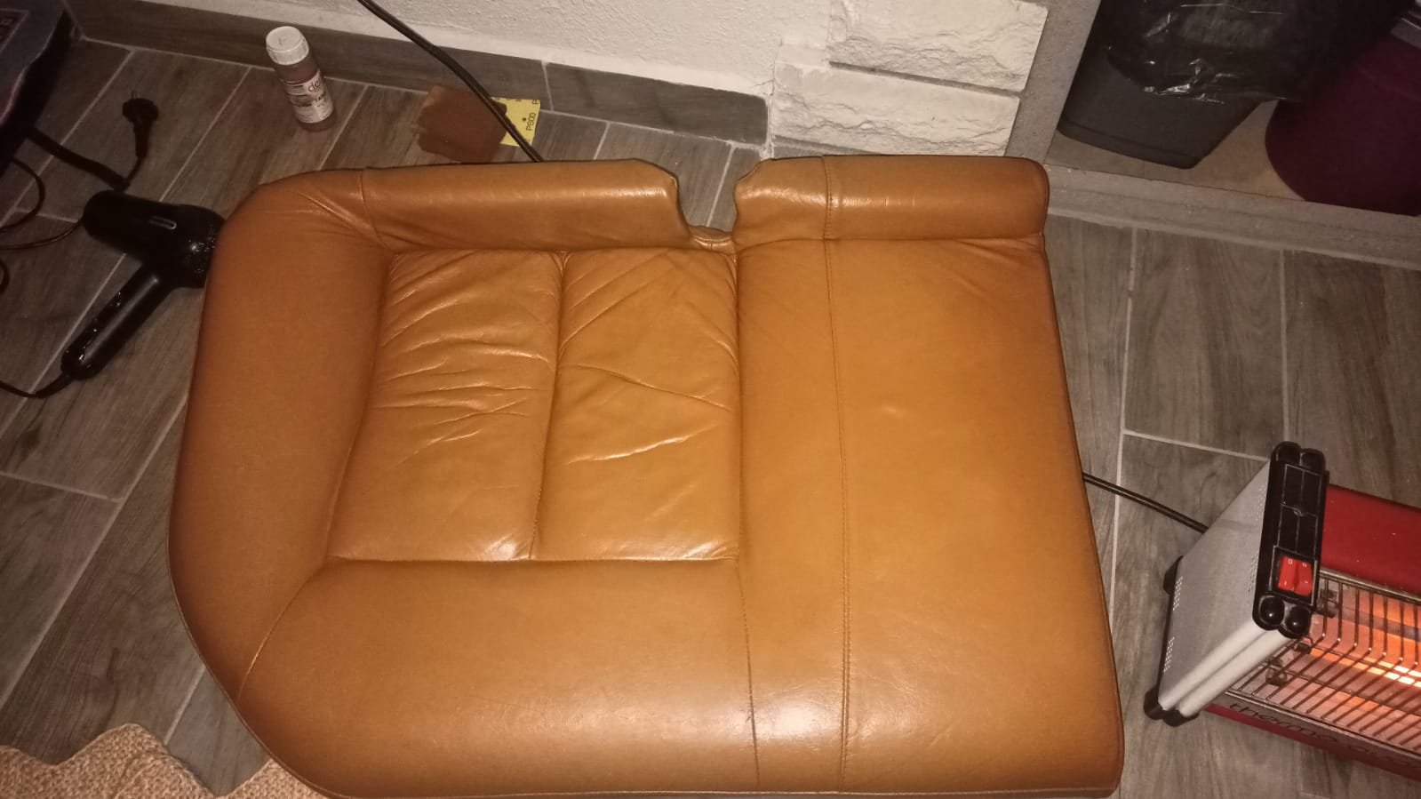

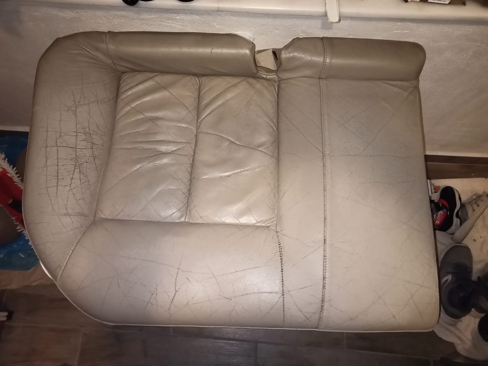

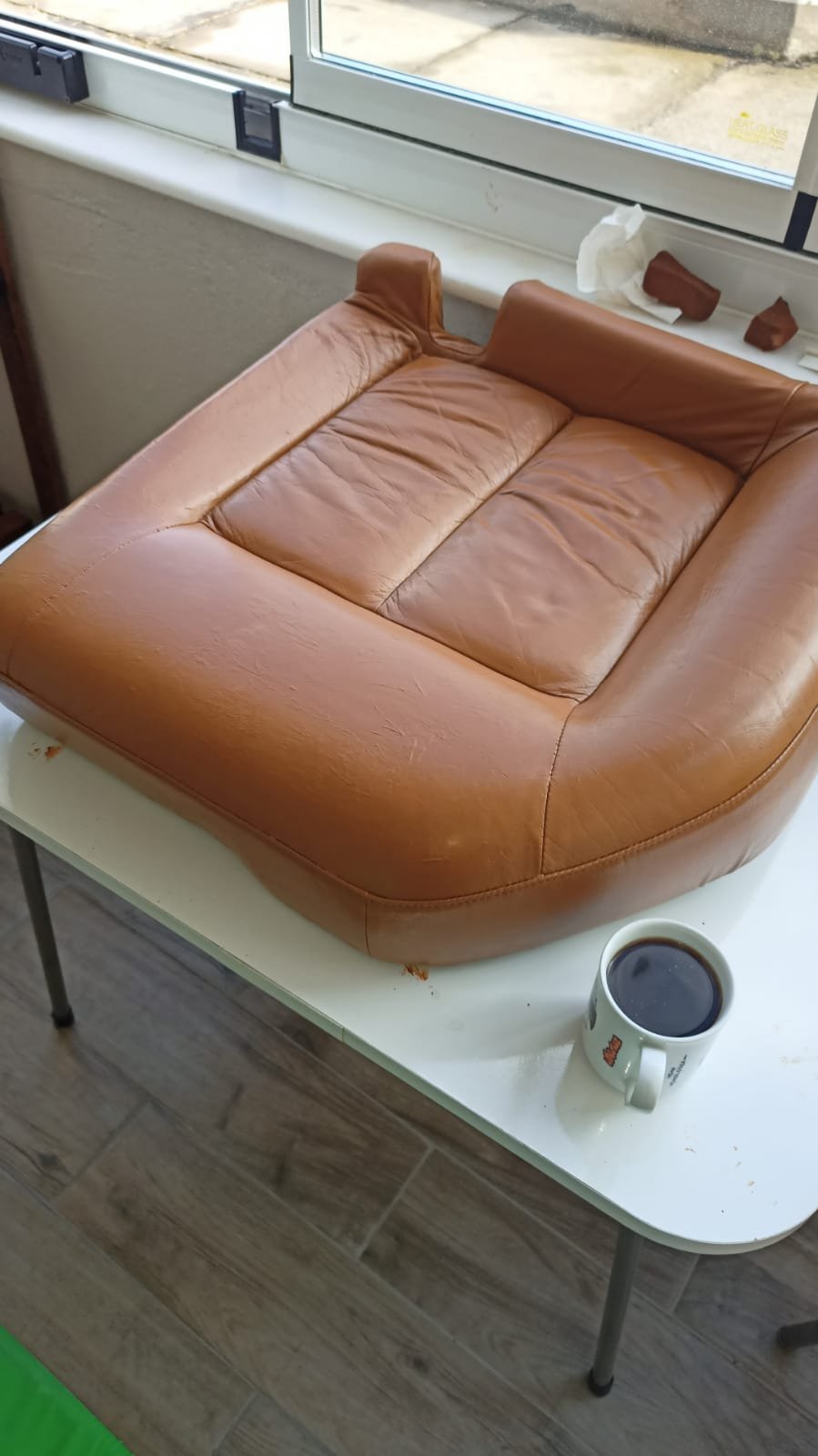

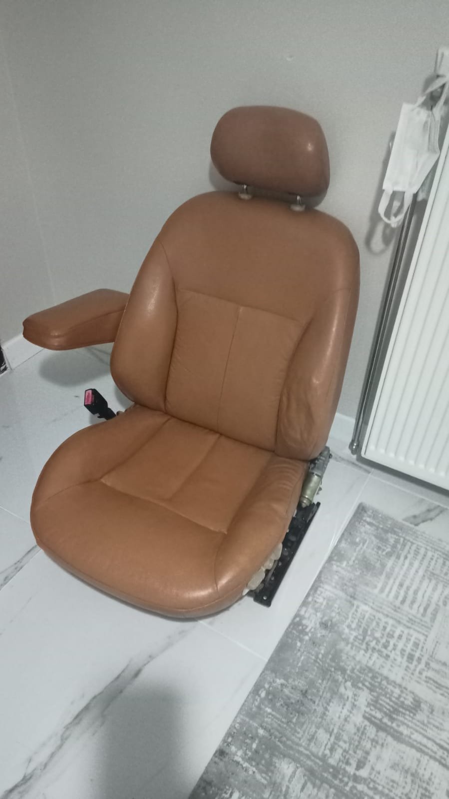

The first adventure, from around 1.5 years back: Xantia's leather seats and interior upholstery, raised from dead. :D
When I got the Xantia, the leather seats were very bad from a combination of lack of maintenance, wrong methods for maintenance when it's done, and I suspect a botched "repair" job which involves painting the seats with some acrylic paint. I asked around and found out that almost all shops where I live just use the paint they use for bodywork on the leather seats. It looks good at first. Then it kills the seats. Like this:

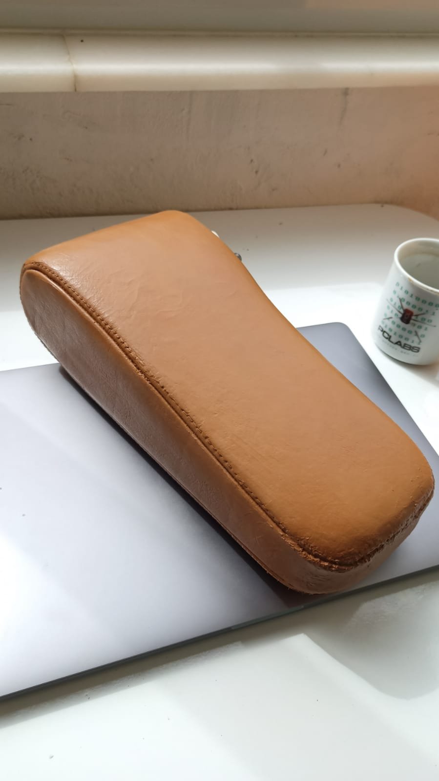

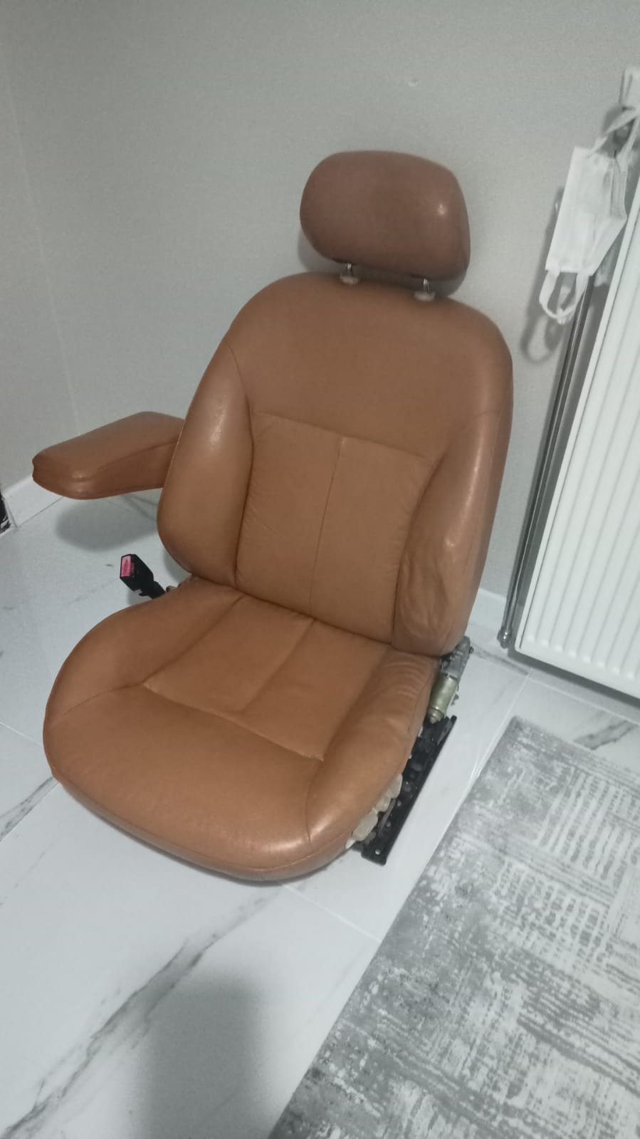

The Alfa's seats also have worn areas, however minor. Fearing someone will ruin it while trying to "fix", I thought I would learn myself on Xantia's seats. As seen on the photos, I didn't have much to lose. Worst case would be getting some good covers and hide my screw-ups. :twisted:
You can see the evolution if you look closely. :) I believe I screwed up every single challenge when I stumbled upon the first time. Stitches were strictly off-limits for me, no intention of going there. I can give some walkthrough if anybody is interested, or if I have some spare time and nothing else to do. :D
Why the color change? It is a standard color from a leather products manufacturer in Turkey. I didn't want to spend time on color-matching, which would double if I fail miserably, to fix my possible failures. This way I can just order more of the standard color to fix my mistakes. It is too "bright" in the photos, it looks more "matte" in real life, and a little "old and used", which I think better fits the car.
The results:

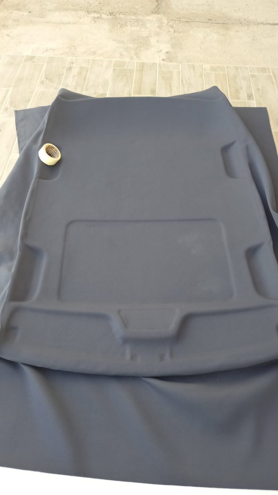

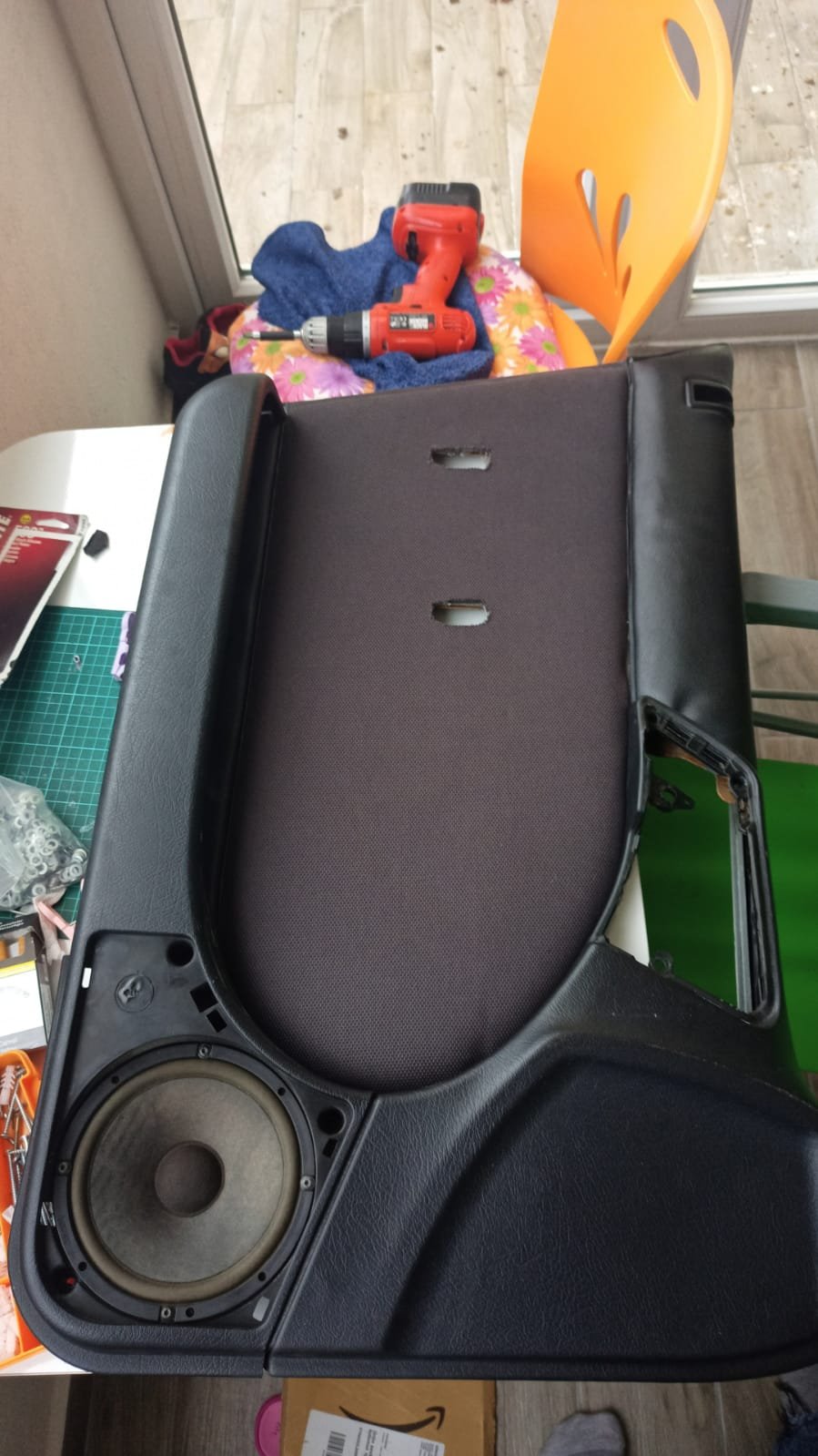

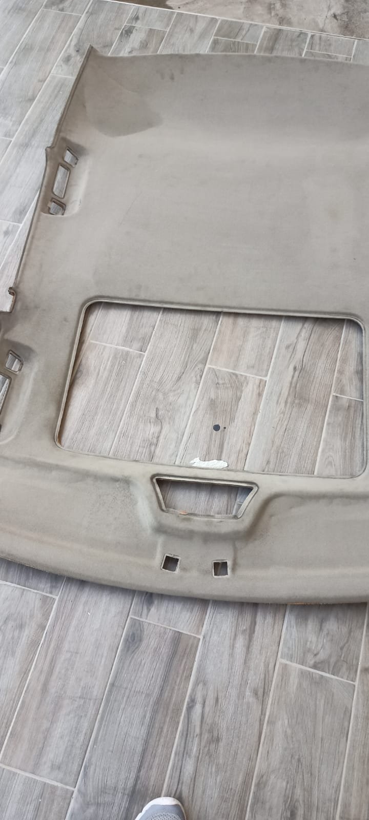

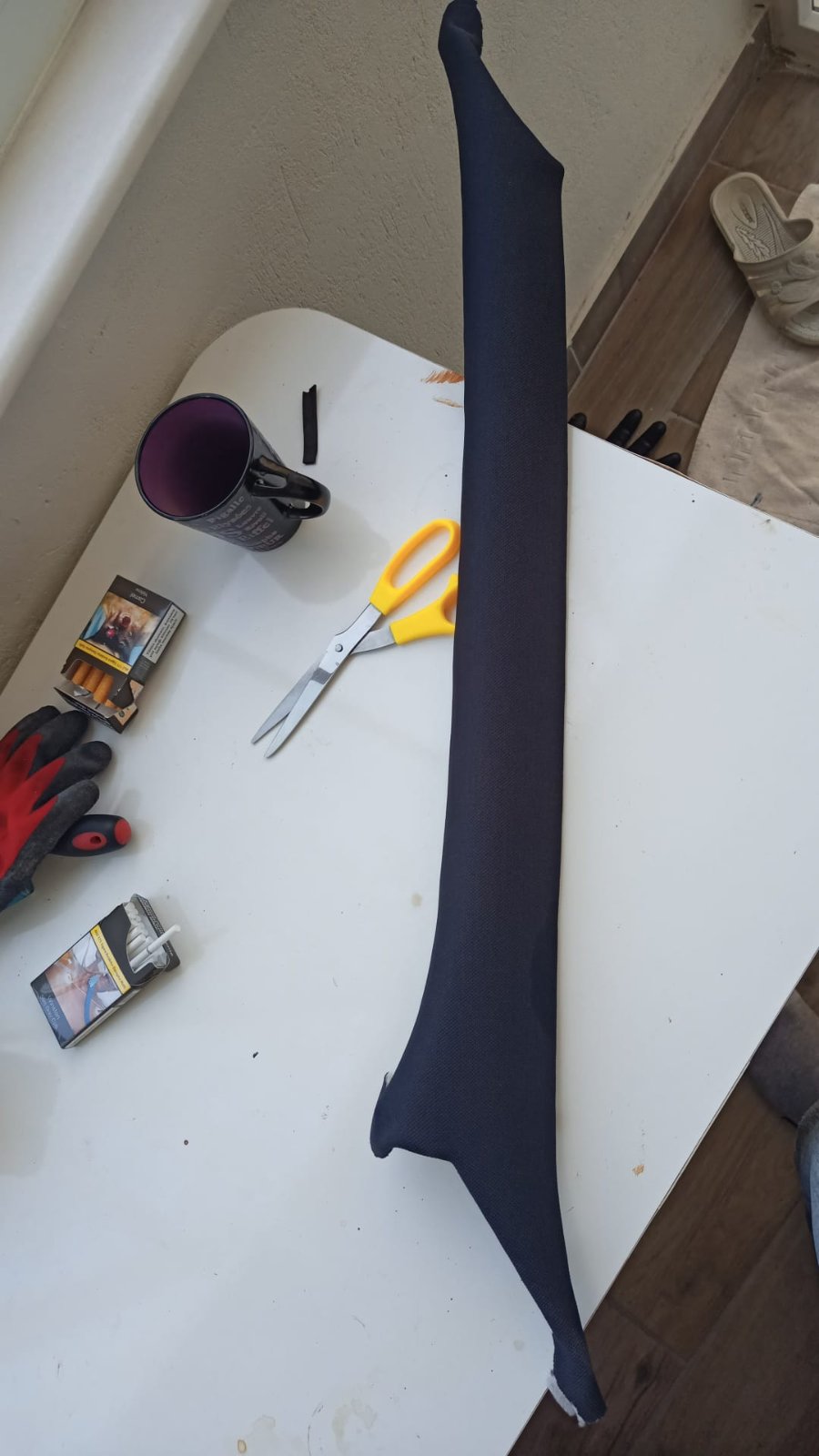

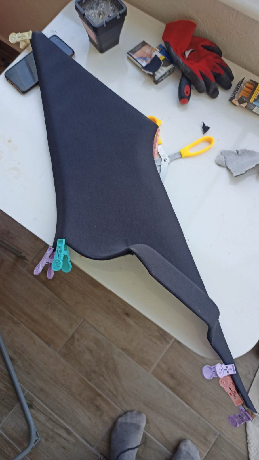

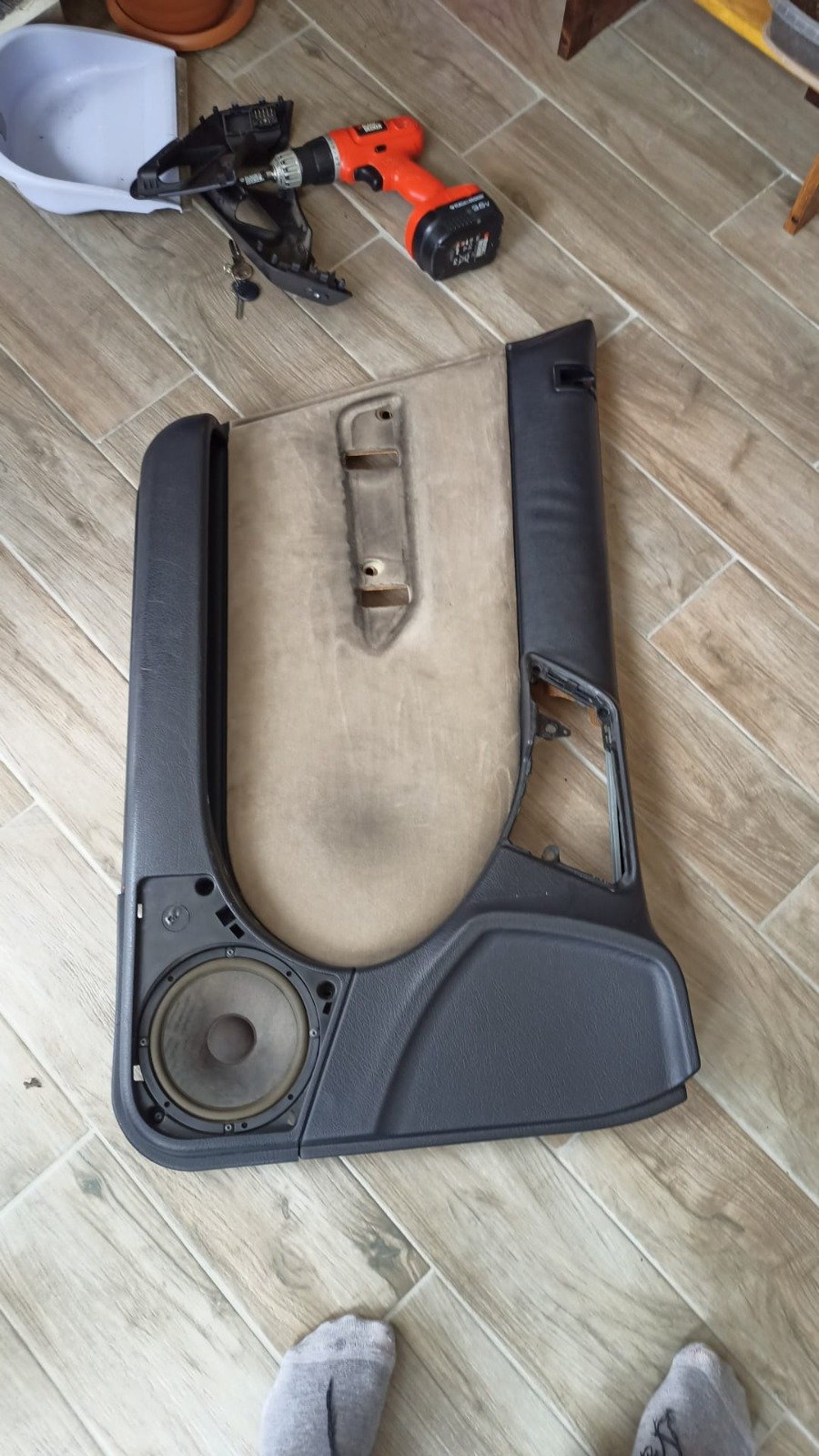

Xantia's leather seats and interior upholstery, raised from dead, vol. 2. :)

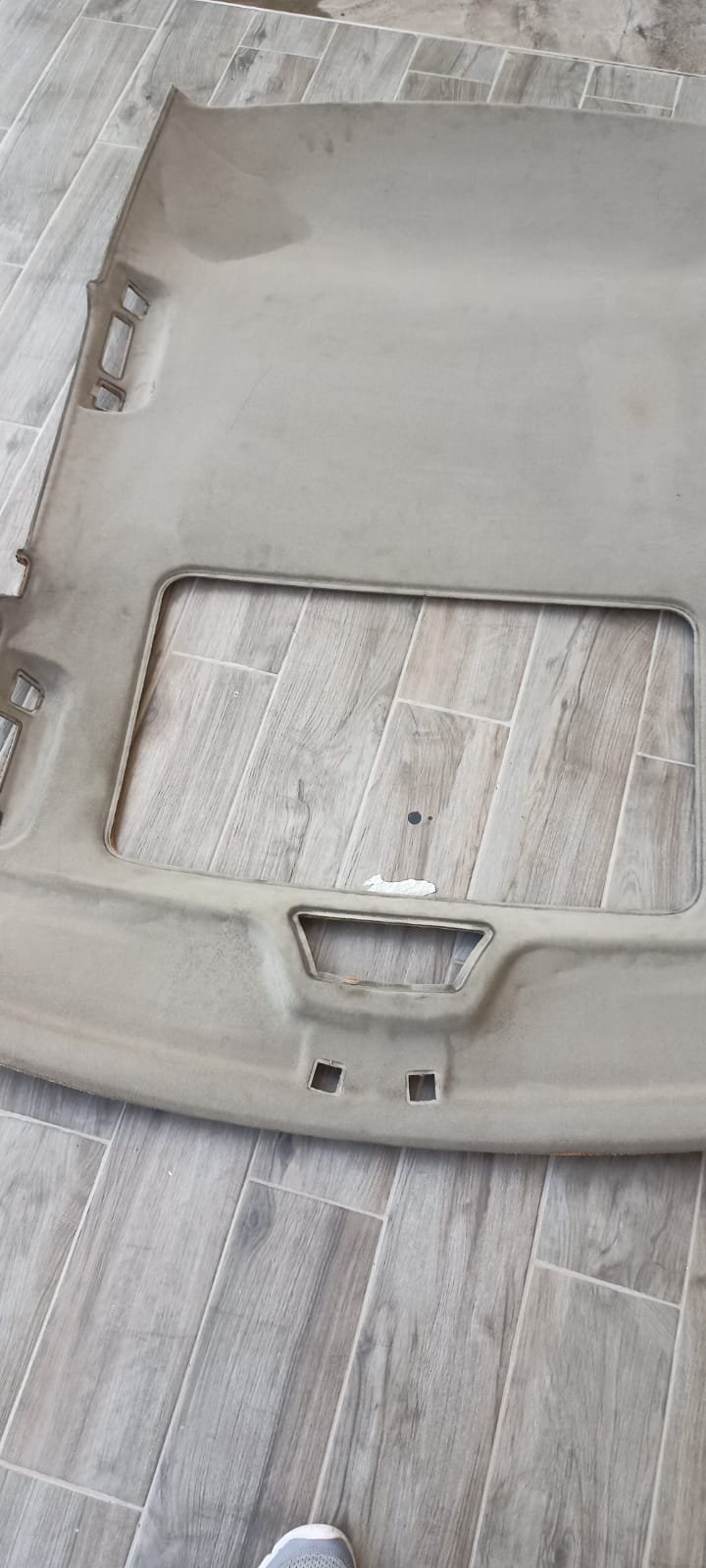

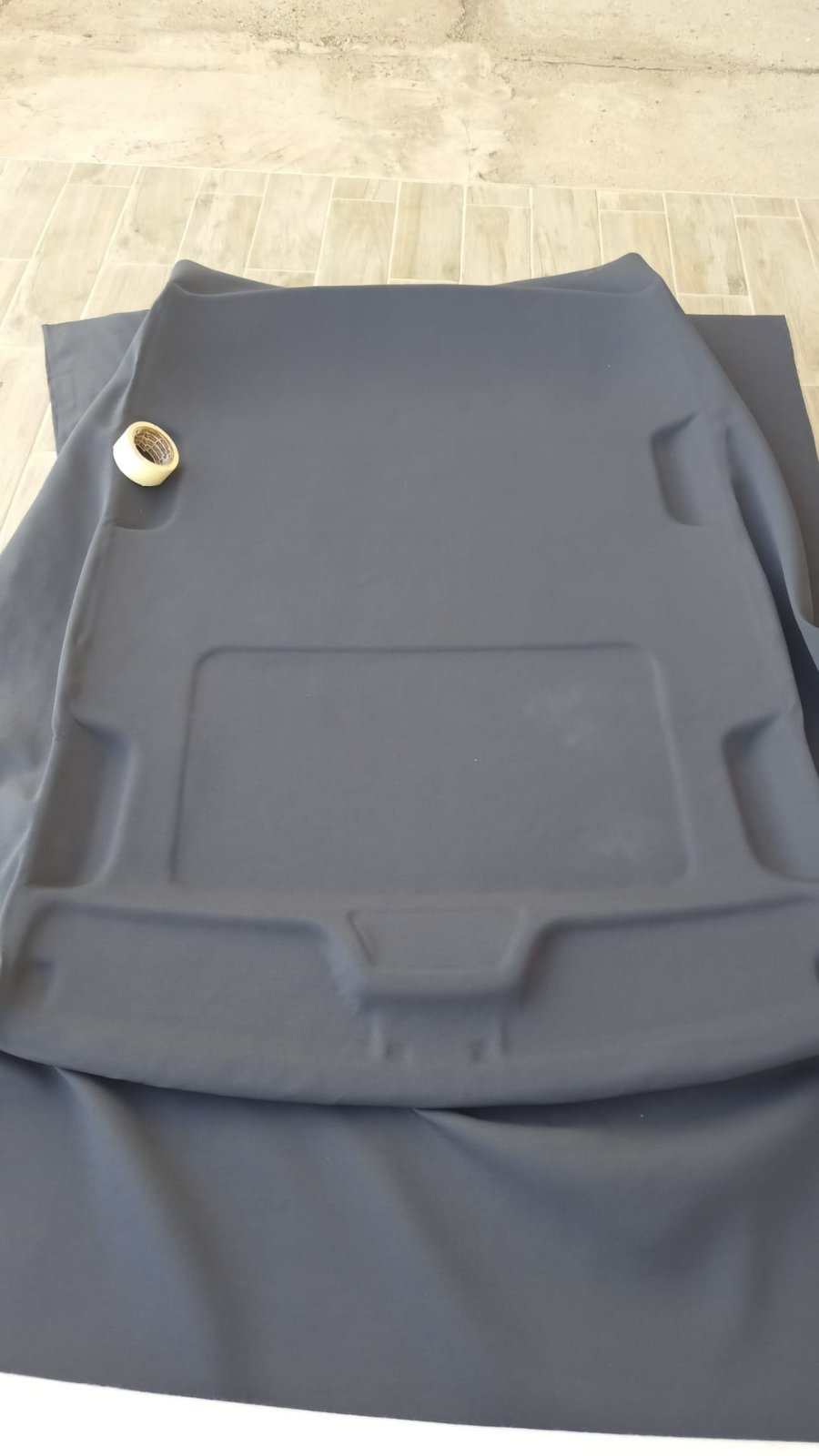

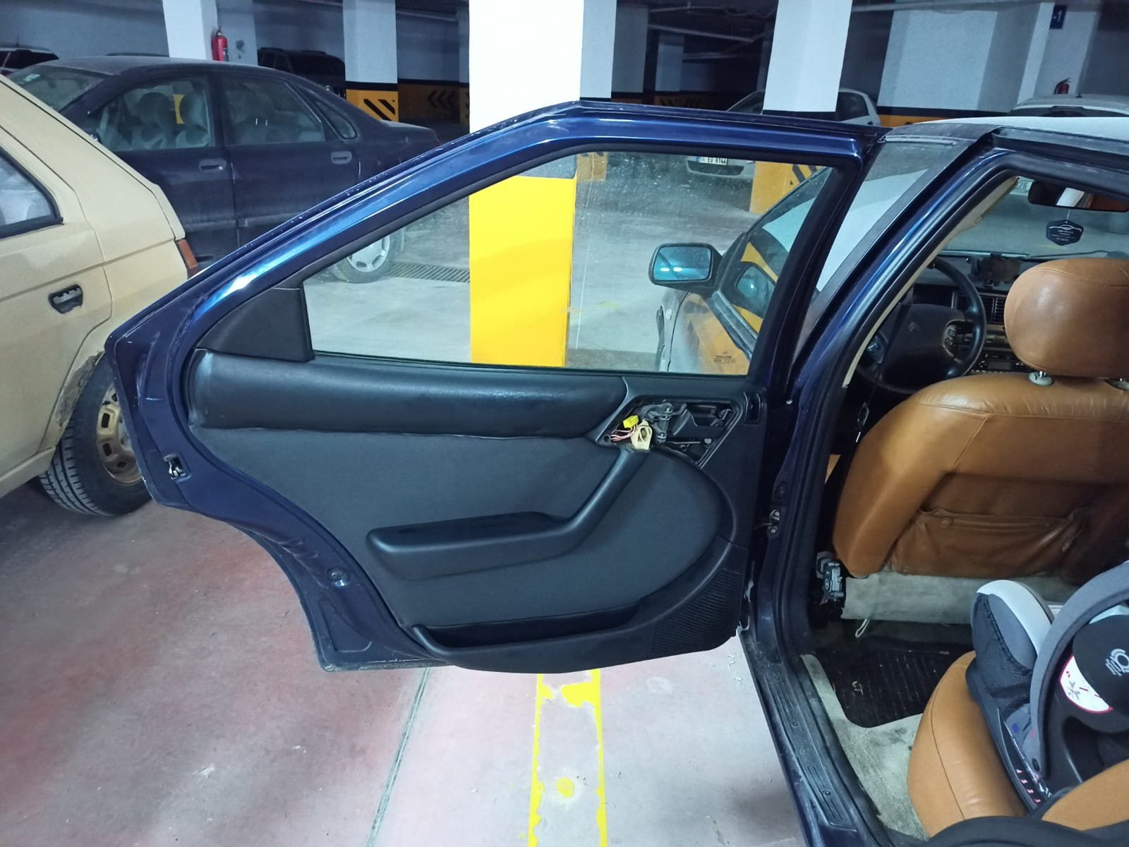

When the leather seats were done, the old, worn, dirty interior started to look odd. That itch started to bother me. After a few days, I found myself talking to a real automotive designer, a friend of mine with whom I worked together when I was an R&D Engineer in a bus/coach building company.
Here's the "before" part. Apart from the headliner, look closely to the door card. I think it had some pattern when it was new, which is completely removed by now.
While I dislike the "dark" interiors (one of my favorite features of Xantia is the large windows), my friend's expertise worked out quite well for this: I went for anthracite. I also wrapped the same fabric on the A pillar trim plastics. All the plastic parts I cannot wrap were painted matte black. These are the handles on top of the doors, the upper part of the C pillar, plastic parts of the sun visors, basically every plastic trim piece that had a light color to match the original interior with matte black. Like the leather job, the first parts I painted were flaky, but it got better as I gained experience. Unfortunately I don't have photos for them, but I would like to share when I have those photos.
The sun visors were wrapped in the same fabric I used for the door cards, with the help of my mother-in-law and her skills with the sewing machine. I haven't installed them yet, and don't have the photos at the moment.
