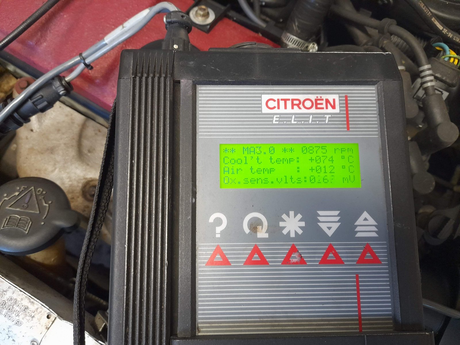

In my experience, a lot of Lexia clones and rip-offs can struggle with an XM (and indeed early Xantis or any other with the 30 pin socket)..
Best for these if you can find someone with a proper Citroen ELIT diagnostic machine...

Yes, I've seen just that a few times when compared to my OE adaptor. All those I tried seemed to be wired differently in every case...
Some of the earlier Lexia clones, again very much in my own experience, could struggle with several variants of ABS units and Aircon ECUs...
I no longer have a Lexia... For my cars and those others I regularly deal with, the ELIT does the job perfectly...
