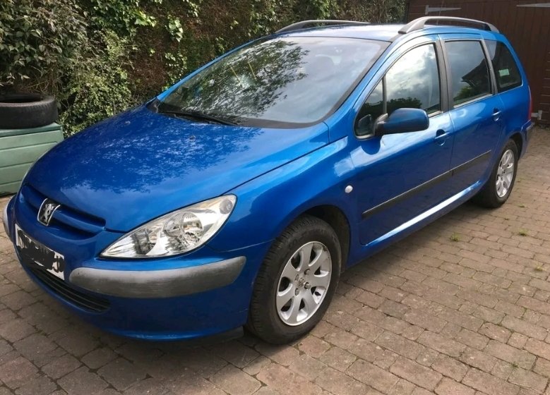

Ok, bsi unit clean
Earth points clean.
Battery earth quick release clamp Lose but now sorted.
So driving this 307sw for a few months my findings so far
Roomy inside , pretty good ride height, driver seat is ok a bit firm after a long trip. The crankshaft pulley is making that wonderful noise so will need replacing soon , an idler pulley has bearings starting to fail near the ac pump so that will need replacing soon . I do find the car feels heavy ,goes great on motorways. It still looks in date for its age . So far im ok with it.
