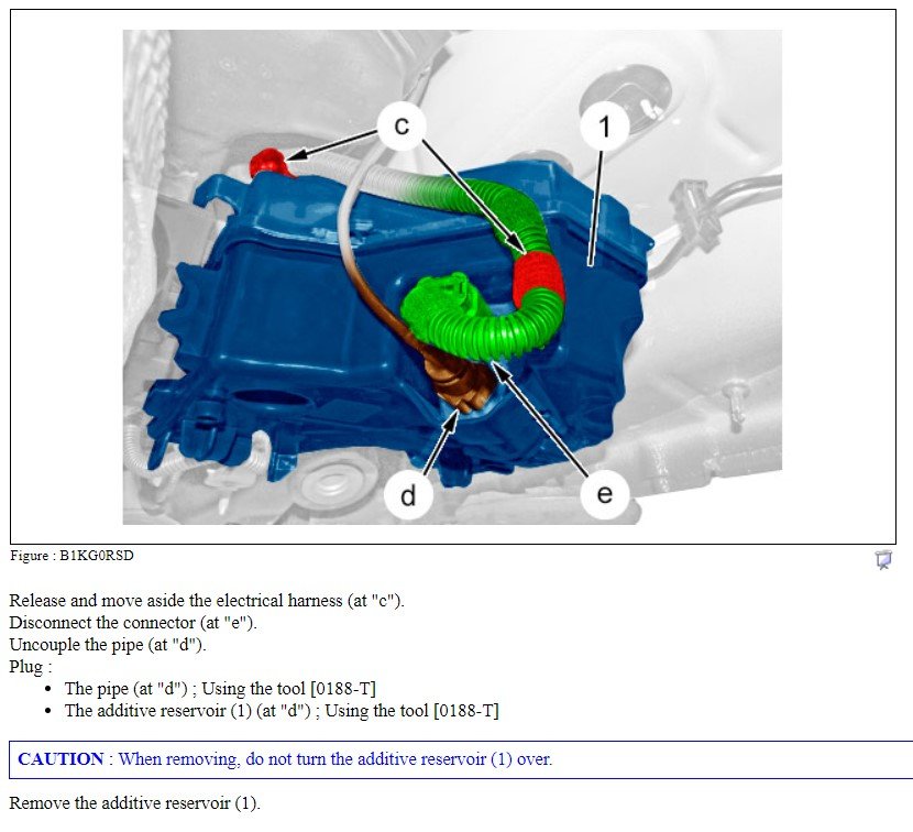

Finally after being off the road 3 months I have the Powerflex and EOLYS Tank & Pump for my mechanic to replace. He's not a specific Citroen mechanic and I know Citroen's can be like a baby deer when it comes to replacing some of the parts connected to the ECU - approach carefully and don't spook!
Is there any particular order or tips/advice on removing, replacing and resetting the EOLYS tank and fluid? The VIN is VF7**************[VIN obfuscated, can be read by forum staff] and the part we are replacing is 9817154080 with Powerflex fluid.

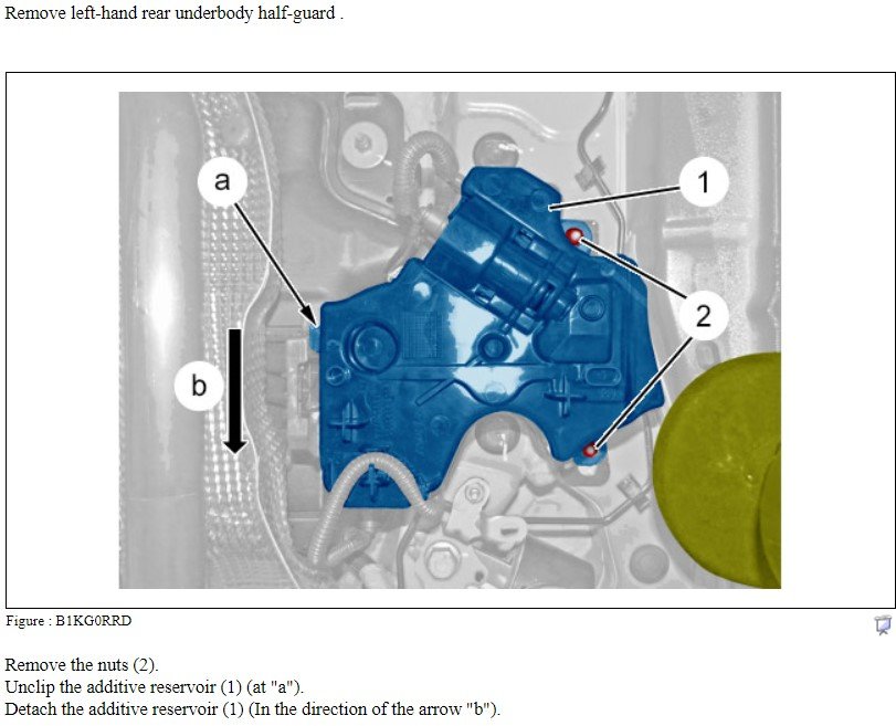

Not really anything special as long as you have decent diagnostic equipment. Should be very straightforward for any mechanic to replace. Remove under gaurd, disconnect pipe &
electrical connector, undo the bolts & unclip tank.
Fill the new tank when its off the car (much easier).
Then with diag follow the new tank initialization procedure.
