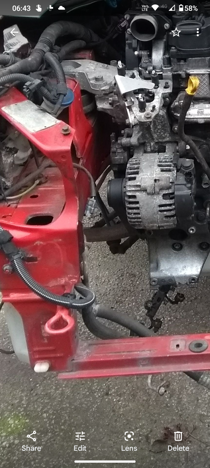

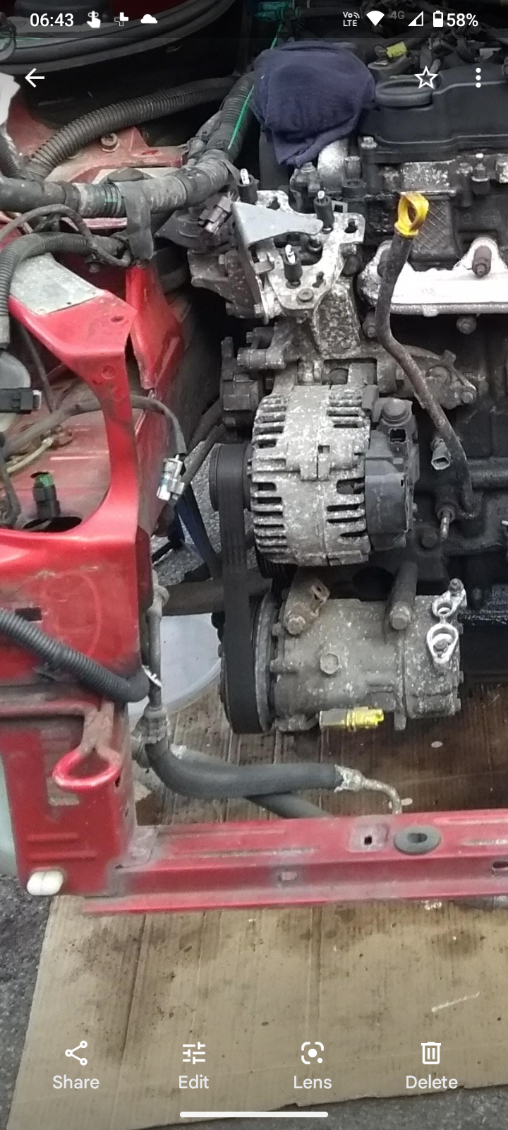

- Posts: 5317
- Joined: 25 Apr 2022, 09:03
- x 2342
Re: Removal of ac compressor
Sorry, it slipped my mind completely to check the belt today
(1.6 HDi in a 206, air conditioning compressor removed = I've done it)
Ross_K
- Posts: 1055
- Joined: 18 Jul 2004, 22:26
- x 110
That's pretty smart...I like thatmickthemaverick wrote: 10 Oct 2022, 19:39 I actually achieved that on a Ford Scorpio by removing the innards of the compressor but leaving the body, shaft bearings and pulley in place.
- Posts: 5317
- x 2342
That is smart.
Doesn't get you the full "performance weight savings" though
I think 8valve 2.0 HDi there's an obstruction that partially blocks the shortened belt route, but no problem on the 1.6 HDi
Haven't written the belt size down (I tend to remember useless information and I think it is 6pk725 but don't rely on my memory, two children is definitely eroding my recall abilities!
Away today and tomorrow, didn't get chance to have a look under the bonnet yesterday, hope to do so Thursday
Matt
Matt
Matt this is brilliant my friend im getting hyper ! Cant wait to do this, also did an oil measurement draining the engine what i was told was wrong , mine holds 3.2L not 4.8 ! No wonder its pushing it out the valve cover !!! I should of trusted my gut feeling 3 months ago. So it should be all good now.MattBLancs wrote: 11 Oct 2022, 06:47 That is smart.
Doesn't get you the full "performance weight savings" though![]()
Matt
Like the photos Matt , very impressed and it works to just look at the space you get back too ! Don't forget the belt length and recheck the number of the belt too , let me know when your free to do so.
