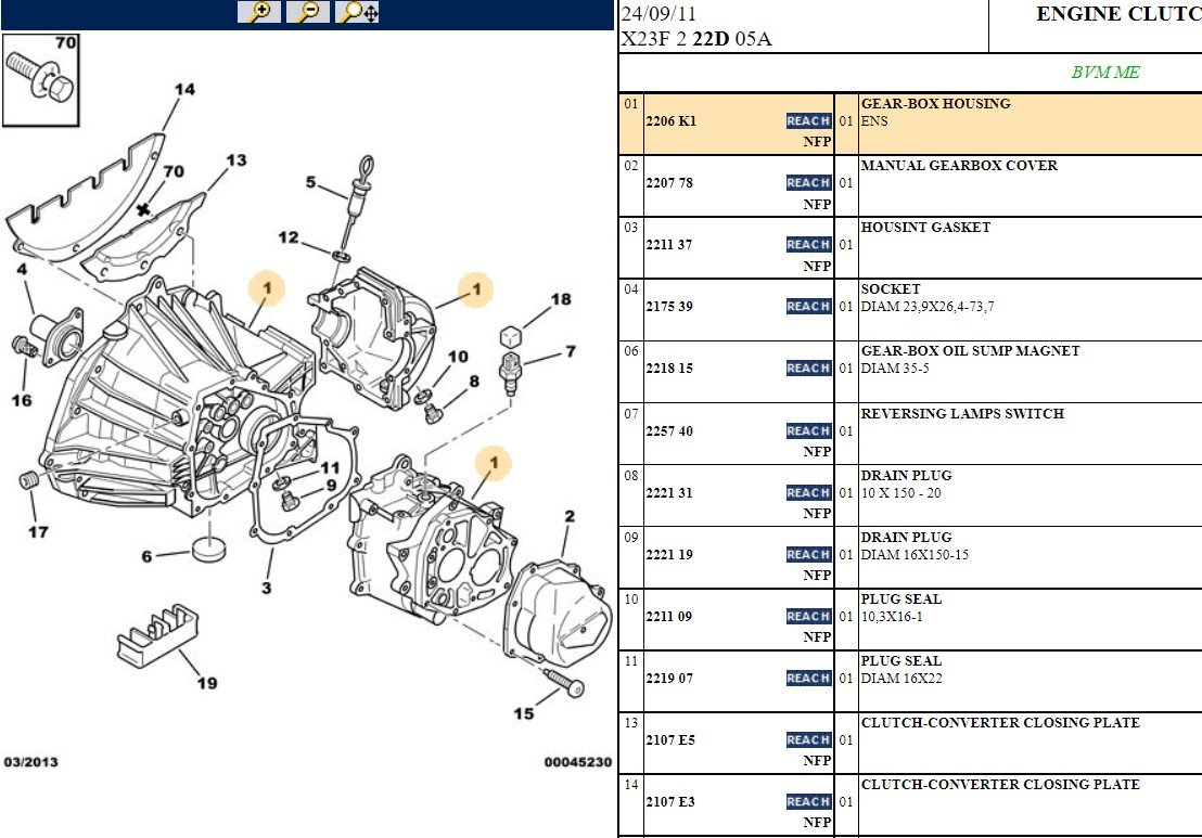

2206K1 is a complete gearbox empty casing??
I go the impression that you were meaning the 5th gear end casing?? (number 2 in the picture)
If this is the case then its's part number 220778.
This is also unavailable to but may help if you were searching for the wrong part number?
