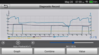

It all started a few days ago when I noticed some fluctuations in the temperature gauge. Thought that maybe there was not enough coolant and topped it up to max.
Drove the car and it heated pretty quickly(blowing hot air inside) but the gauge was still fluctuating. After driving for some time I stopped and opened the hood. Then I noticed that the level of coolant in the expansion tank was slowly rising and it started overflowing. Checked the cap and it was tight.
Checked with Diagbox if there were any fault codes and found a P0598 "Controlled thermostat signal" fault. So I started suspecting the thermostat.
But it's strange. The car starts blowing warm air in about 3-4 minutes after starting to drive from cold and it does not overheat. I thought that if the thermostat would fail in the open or closed position, the car would either overheat or get warm slower.
Today I cleared the fault, topped the coolant halfway between min and max levels and drove on the highway for about 40 min with diagbox recording the coolant temp. oil temp, piloted thermostat reference level and measured fan speed. While driving, the fan did not start and the temp of the coolant was maximum 96 degC while the oil temp was maximum 95 degC. All while driving the thermostat reference level was set to 99% which i found strange(but i'm not sure if this is normal?). When i stopped and left the engine idling, coolant temp went up to 103 degC, but the fan did not start. In the meantime, the coolant level started increasing as well and overflowing.
Did a test on the fan and it only works on high speed. If I test it on low speed, it does not spin at all.
Do you know what it might be? I don't want to start swapping parts without a possible cause.
Your help would be greatly appreciated.
Thank you!

All those temperatures are fairly normal for the situations that you describe, however;
At 103' the expansion tank shouldn't overflow.
At 103' the radiator fan should be running.
I know that in PP the "low speed fan test" doesn't work on some car models, but I don't know if it should work on yours.
So, on the surface I would guess that you have a combination of a bad expansion tank cap and a failure of the radiator fan to run at low speed.
I don't know about the P0598 error. It could be that the engine ECU is whinging that the coolant temperature is not tracking the thermostat position. If the radiator fan is not running in low speed, the engine ECU may be commanding the thermostat open (further) but the coolant temp is not going down?
If you clear that fault does it immediately come back? If so, I would say that the thermostat is faulty. If it only pops back up after running the car for a while, then I would say it's the other factors.
