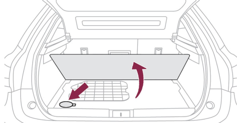

Of course. All DS5 Diesels have a DPF system and therefore have a DPF additive used with it. Being a 2017 model, your DS5 will almost certainly have in addition to the DPF system, an SCR (Selective Catalytic Reduction) system to treat NOx. So you will have separately, and in addition to, an Adblue tank for this purpose.
The filler access for the Adblue will be under the boot floor on the rear left hand side if you have the Blue HDi engine, shown here:

How do you fill it is that the filling cap on passenger side carpet has a flap with a green cap under it

@mkjohns2012: Unlikely in your case, as yours is a 2013 model, based on the vehicle in your profile. If this is the case it's too early to have a SCR system fitted, but your VIN will confirm.

You have a 2012 (Dec. 2012) build so too early for the SCR (Adblue) system to be fitted, so ignore the diagram above.
