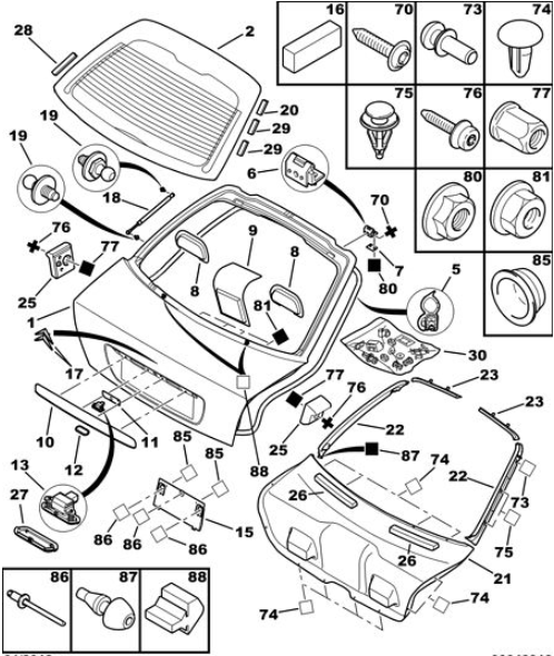

There are multiple parts to the trim, if it's any of these parts you need, but the screens themselves are like the front windscreen and are actually bonded to the vehicle, so not sure what you want. The old bonding need cutting off before the new screen can be re-bonded and will need new clips.
The weatherstrip seal is item (5), part: 870774, £92.89 from Citroen and still available.

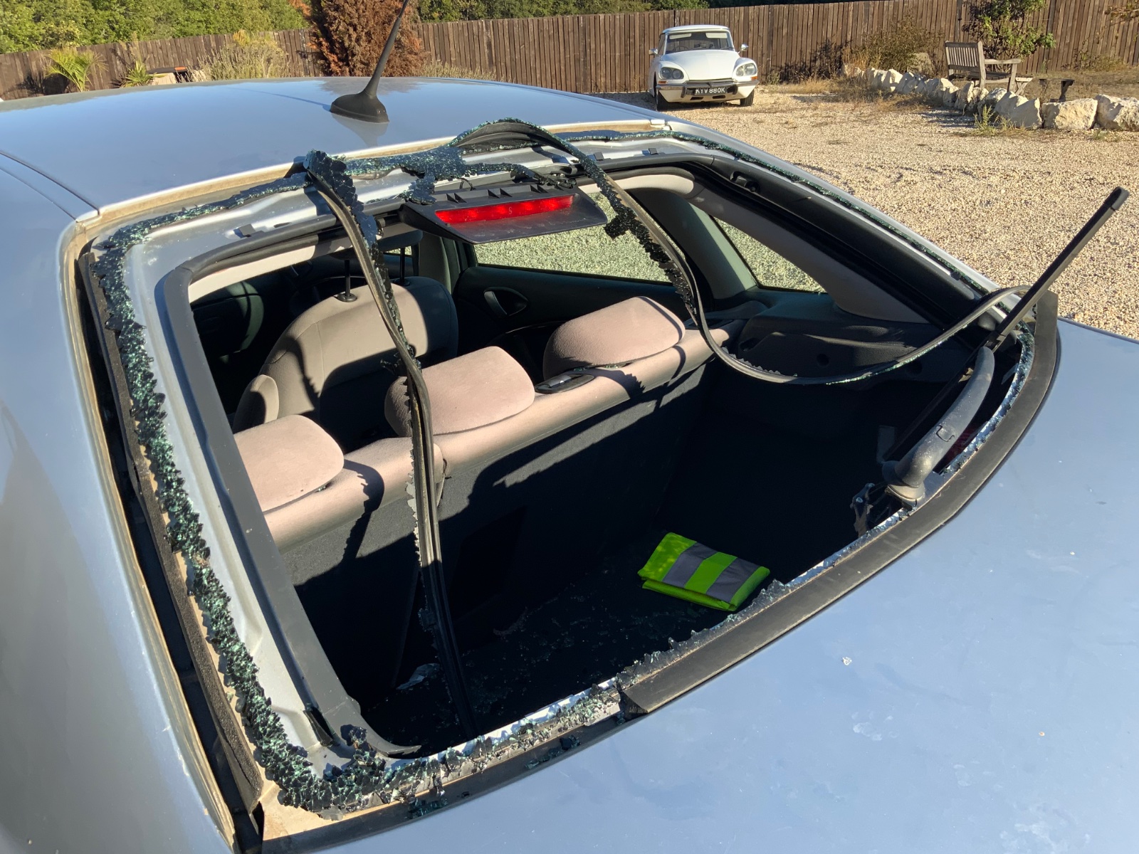

Thanks Marc. The seal I need is the chunky one you can see broken here

Re: Rear window seal p/n C5 2001 Hatchback
That looks like the one I posted - item (5) in my post above.

Hmm, now I’ve found number 5, it looks more like the seal for the whole boot?
x 6950

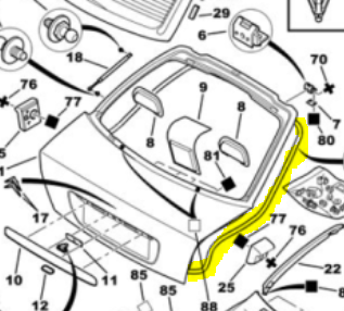

Correct, the glass is bonded on as you can see in your image where all the gunk is and the weather seal goes along the top and all the way down the side of the boot as seen where I have highlighted it:

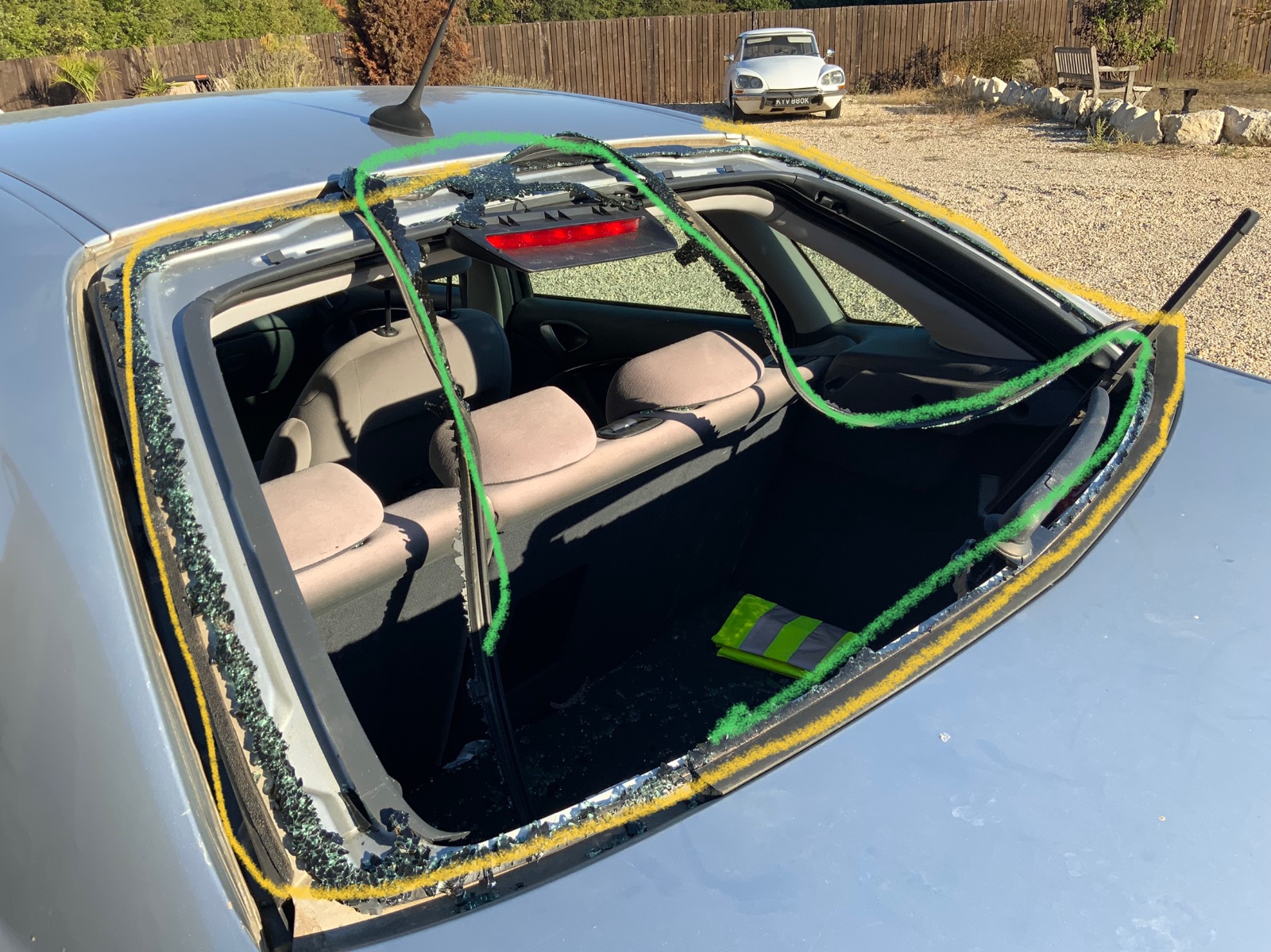

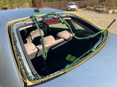

it goes only round the contour on the glass, see here, yellow is where the seal goes, green is the seal itself
x 6950
