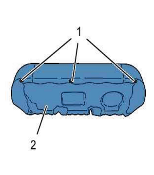

I'm trying to remove rear seat swab to access the fuel tank. It seems fixed in. Any ideas? Pluriel 2004.

To access the fuel pump / gauge you need to:
Remove the bolts (1).
Pull and tilt the rear seat (2) towards the front.
Remove the rear seat (2).
Of course this is just for access to the pump - removing the tank is another operation.
