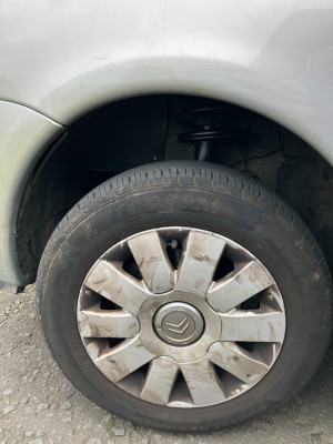

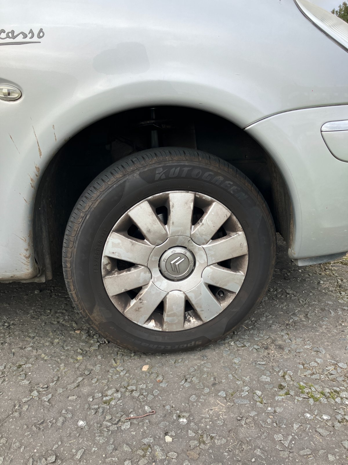

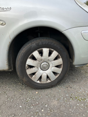

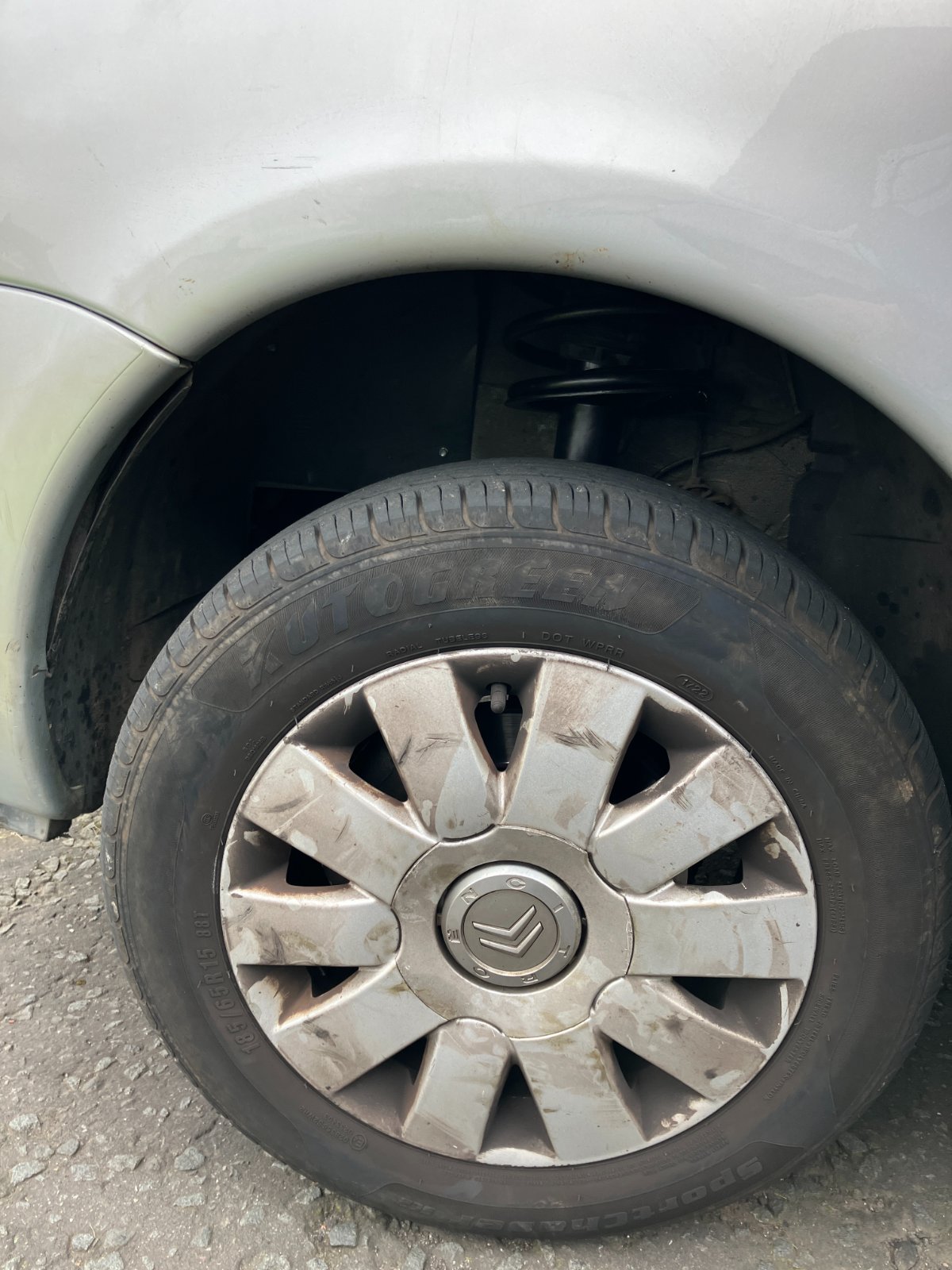

Hi guys,
I have just replaced the front shocks and coil springs on my 2007 Picasso, they are the correct parts but the gap between wheel and top of the arch looks way too big.
It drives fine with no pulls, knocks etc.
Is this normal? If not, any ideas?
Thanks
Tam

- Posts: 28692
- x 5674
Re: Xsara Picasso Shocks and Springs
There is a guide to uploading images here
Tam
- Posts: 100
- Joined: 09 Apr 2016, 10:05
- x 10
- Posts: 28692
- x 5674
That does look to be a very large gap.
Tam
- Posts: 100
- x 10
That's what I was thinking, no noises, rubbing etc and it runs fine, handles as it should. Strange.
Did you check your had the correct like for like shock absorbers and not just 'compatible' ones? Same with springs.
Your new ones may be slightly longer.
Or it could just be because they're new and sitting higher than normal and will settle down over the next few hundred miles.
Once settled into the correct position - the standard gap is roughly the same in the whole arch (nice even semi-circle curve).
Yours currently has a wider gap at the top than the sides of the wheel.
