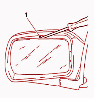

Hi, my S2 Xantia, I am about to replace the temp sensor inside the wing mirror. my question is; how to do take the mirror glass out, without breaking it? are there hidden clips. thanks in advance Terry.

With the help of a screwdriver, disengage fixing circlip (1) from behind the glass.

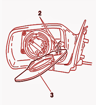

Disconnect the pins (2) supplying the adjustment motor.
Remove glass.
