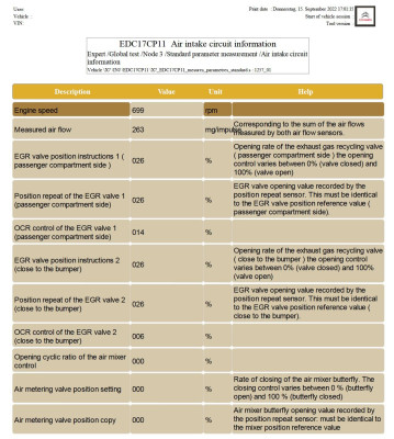

Re: Engine jerking when accelerating very softly at 1500 rpm
Your symptoms could be a failing EGR valve. I've experienced this with the 2.7HDi engine, which is similar to your 3.0HDi.
There are two EGR valves. Diagnostic tests may show airflow faults.

Hello hattershaun,hattershaun wrote: 13 Sep 2022, 13:51 Your symptoms could be a failing EGR valve. I've experienced this with the 2.7HDi engine, which is similar to your 3.0HDi.
thanks for your reply. I got some information on the EGR which I placed in the below picture. It tells me nothing much, though.
Should I make the test with a running engine ? Which speed ?
Have a nice evening
Hartmut
