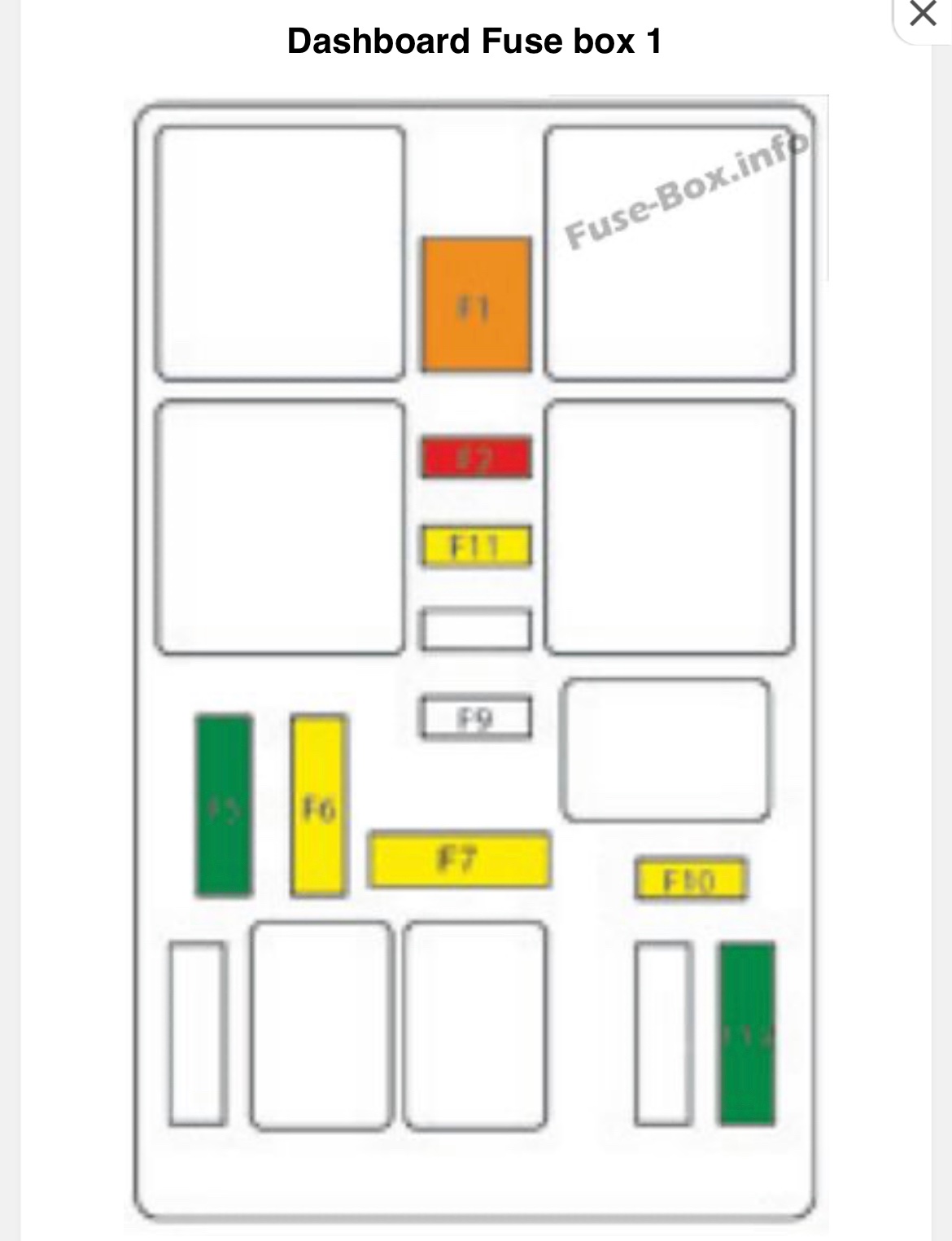

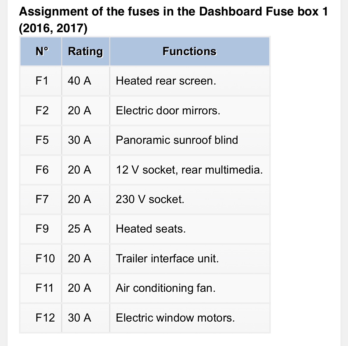

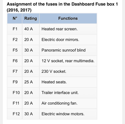

Here is the details of fuse board 1; which I can’t seem to find behind the glove box.
Fuse box 2 seems to be behind a load of connectors but I can’t find 1.
Attached pictures
Thanks in advance
