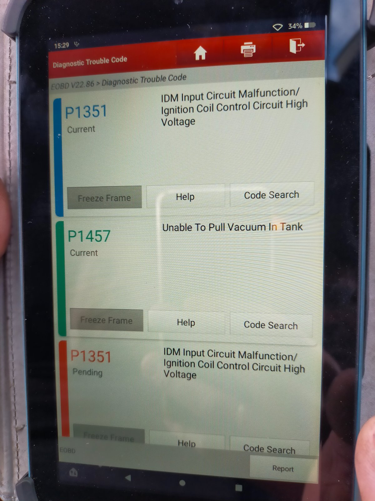

To my knowledge EGR was just cleaned few weeks back. Now car saying again, that Antipollution system Faulty and loosing power in same manner as it would have difficulty getting fuel from tank...
Fault codes made even mechanic to do some research, as he could not make anything out of them ...
Any idea what could be wrong there?

Pop your VIN up for me, those codes descriptions are entirely wrong on first look, I'll have a better idea when I have your VIN.

Here I see that first one gave last time completely different comment.
P1351 Preheating Relay Circuit Relay Supplied and Plugs Never Supplied - Permanent Fault
They did replace glowplugs just recently.
