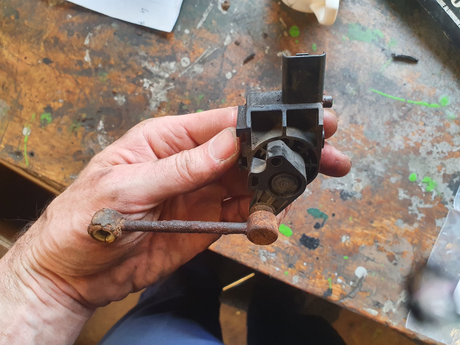

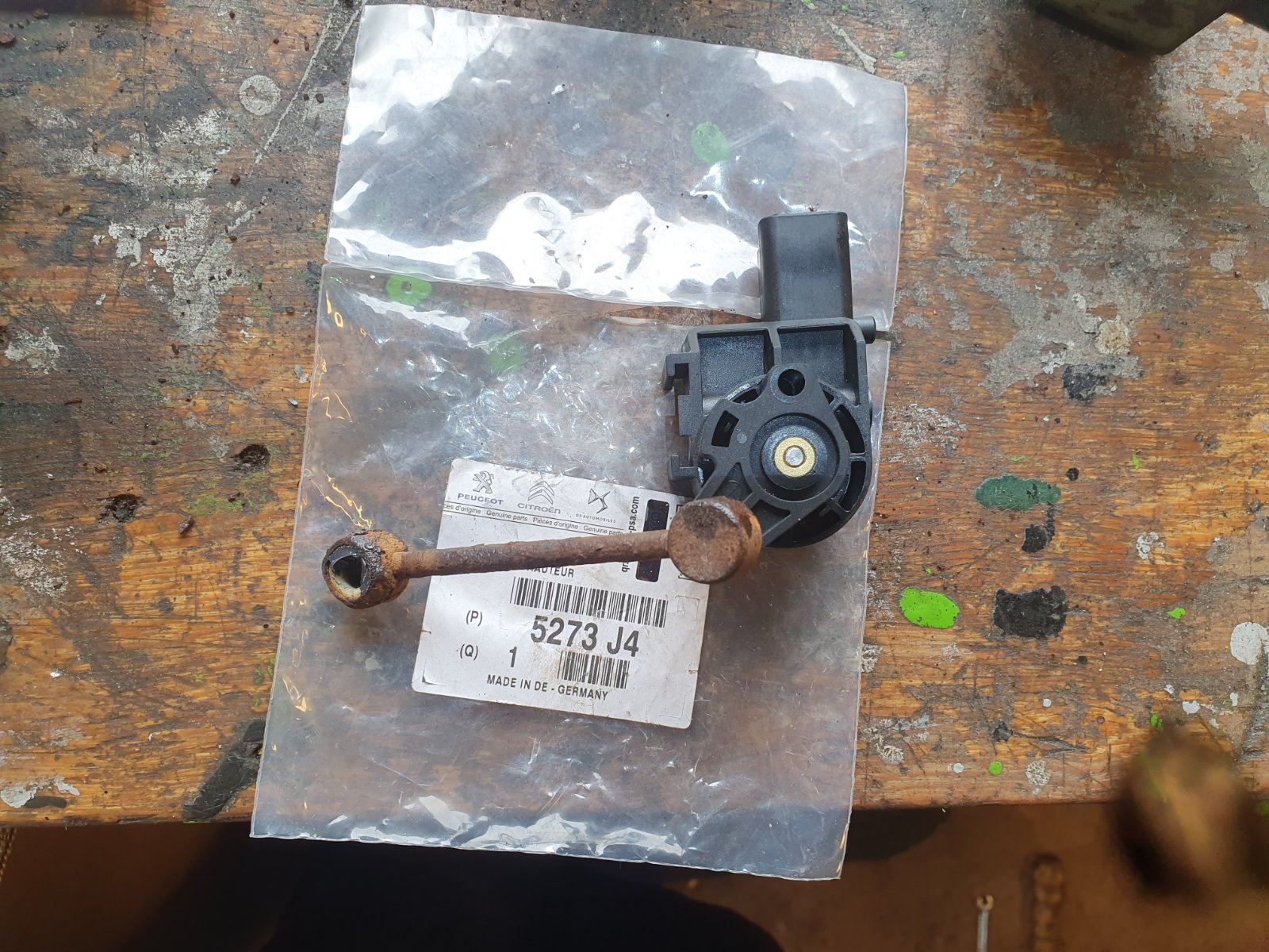

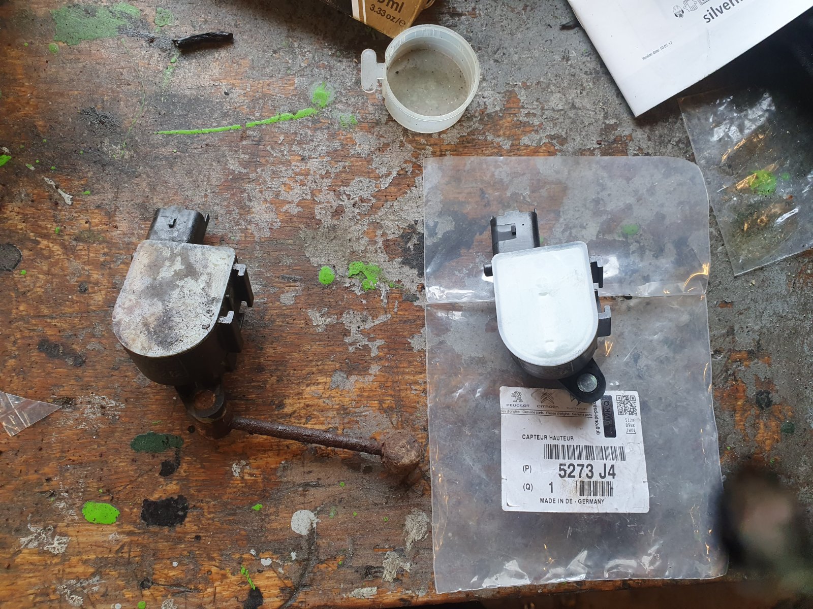

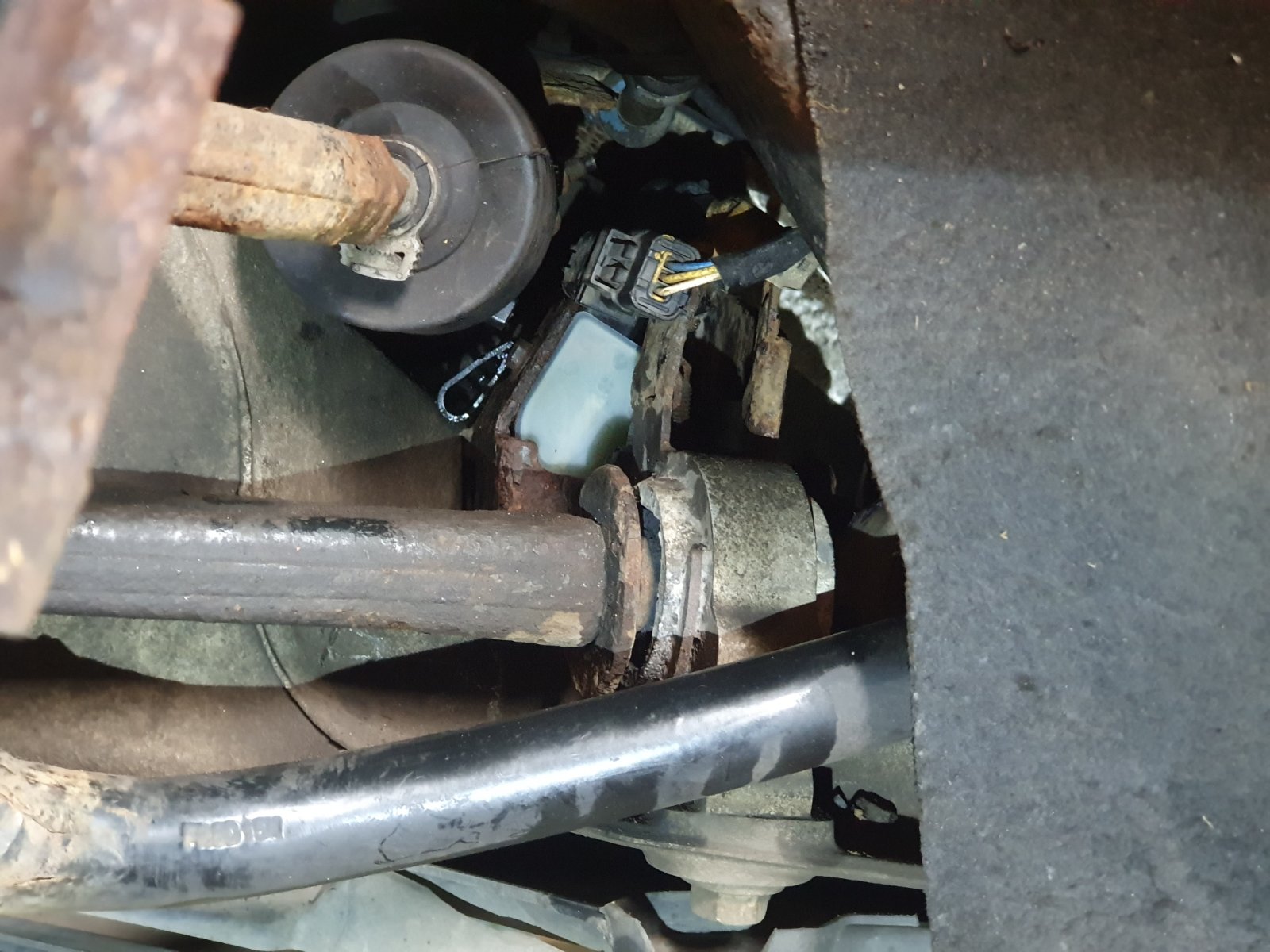

I had sourced a new height sensor and decided to see if fitting this at the front would change anything. A reasonably straightforward job apart from the actual lifting out and disconnecting of the rod has to be done blind and the refitting too..
Unfortunately this has made no difference to the height issue and I am wondering if anyone has an idea of what it might be. There was obviously no problem with the old sensor or the rod sticking. Is there a calibration for the intermediate and maximum heights required? If so, how was this lost in the first instance especially since the low position works normally.
