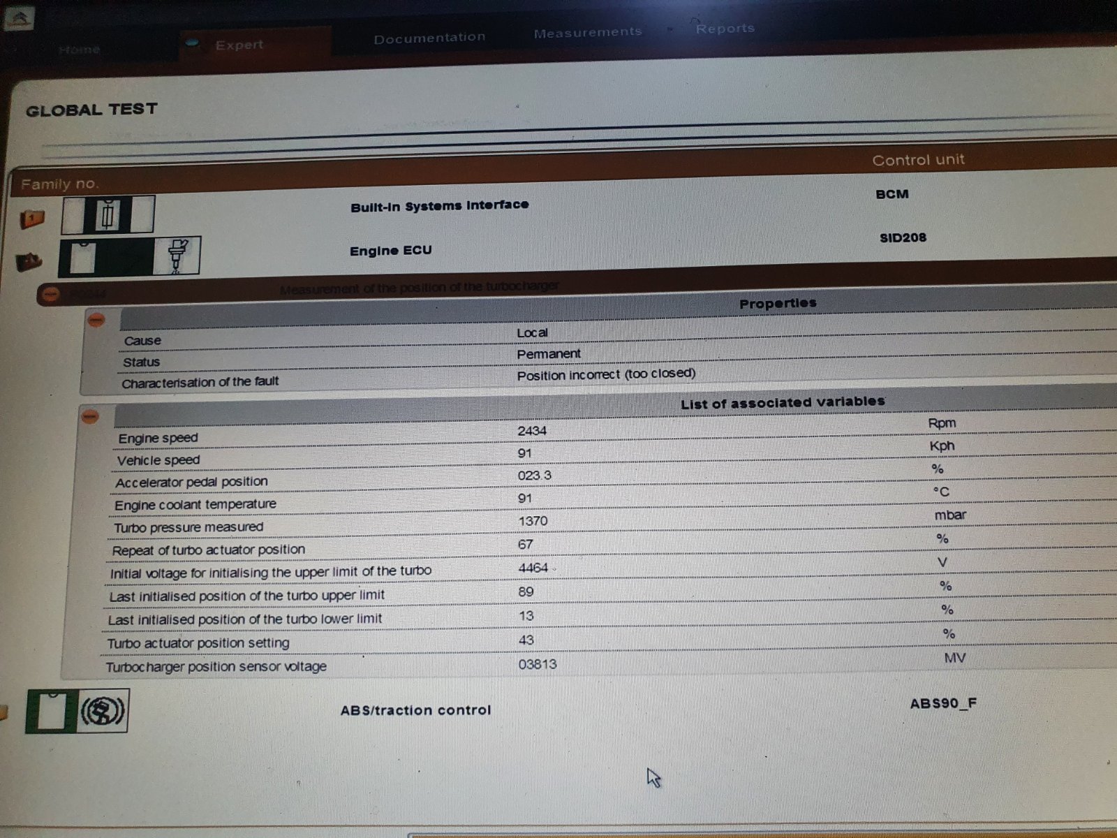

During my first run out I had the engine management light come on and entered limp mode. Limp mode reset when I restated. This generally happened on long hills on the motorway in 6th gear at around 65 mph. I found that doping a gear on the hills generally seemed to prevented the fault from occurring. Following the trip out of about 300 miles, a scan reviled the flowing codes:
P0489 Measurement of the position of the EGR valve
P0244 Measurement of the position of the Turbocharger
P0299 Charge pressure regulation
P0234 Charge pressure regulation

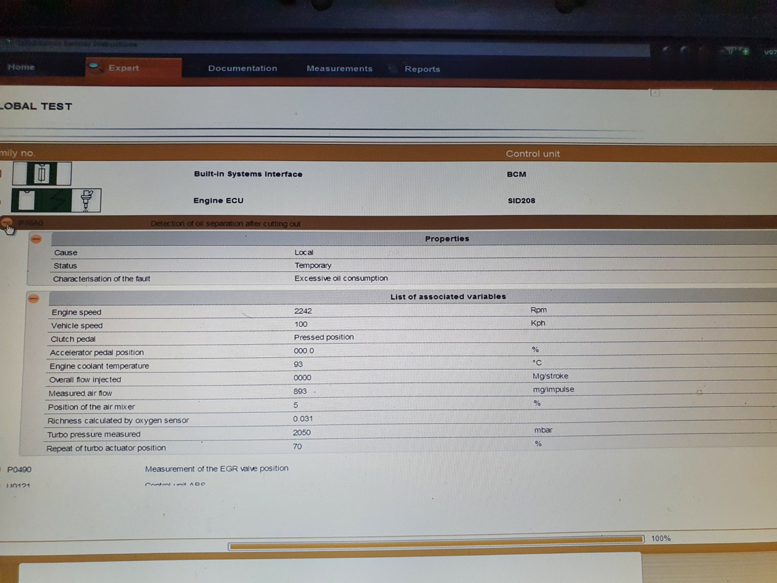

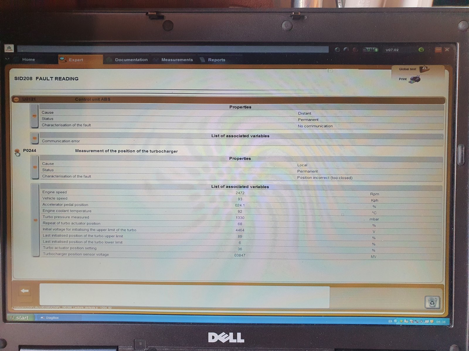

I drove the van carefully and didn't have to much trouble. It only faulted a couple of times on the long drive from MK to Cornwall. On the last leg of the return journey it played up repeatedly and actually become undrivable at one point. I got the laptop out and run a scan which reveled all of the above, plus:
P16A0 Detection of oil separation after cutting out
U0121 Non conformation of engine torque
I cleared the faults and managed to get home with only a couple more hiccups, I scanned both times and got P0244 - position of the turbocharger.
