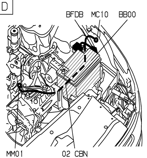

There is the main fuse in the unit next to the right side of the battery (BFDB) shown below, that supplies the relay that in turn supplies the pump motor. But if that had blown you wouldn't be getting anything from the pump at all.
A pump motor fault won't necessarily bring up a fault code. There's no ECU in the pump motor, only within the BHI itself and as far as I can see only 1 possible fault relating to the Electropump assembly motor (C1125) which is open or short circuit.
It is quite possible that the motor is starting to get affected by the conductive carbon paste build up and that will soon lead to overheating and blowing the fuse.
If it is starting to get too hot, it may temporarily cut out, until it has cooled, so I think I would be following the Elis's guide and get that cleaned up.
If the strut is leaking, then it's a new strut I'm afraid, these are not repairable unlike the previous generation of C5. This is the first one to go usually.
