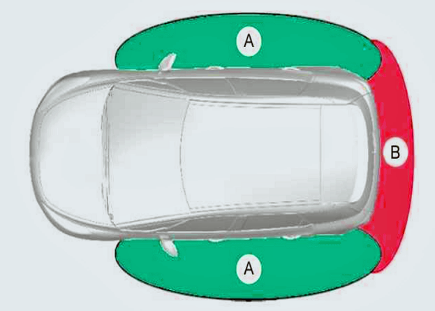

For the Hands Free Access part, the areas of detection are:
Definitions of a transmission zone "A":
Length: 3 metres
Width: 1,60 metres
Height: 1,60 metres
Definitions of a transmission zone "B":
Transmission beam: 1,60 metres
Height: 1,60 metres

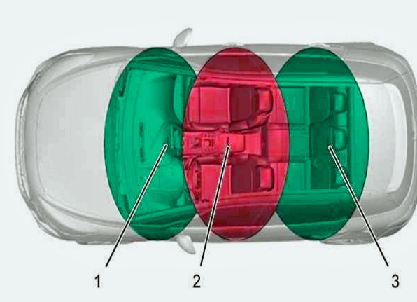

For the Hands Free Starting, the fob must be in the detection zones shown below:
If the hands-free identifier is not detected by the cabin low frequency aerials, a message displays on the instrument panel matrix screen indicating the procedure to be followed for forcing the stopping of the engine.
In this case, a press of 3 seconds is required.
I can't see anything mentioned about automatically stopping the engine if the fob is missing. The reason I can see are safety concerns - if for example a passenger threw the fob out the window - you would not expect the engine to cut out on the motorway....
