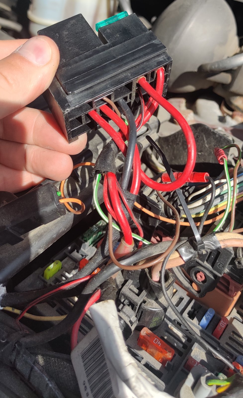

The cooling fans high speed stopped working (again) on my holiday trip last week. As the fan is quite new I looked for the issue elsewhere. A faulty 30A fuse turned out to be the culprit! Changed it and it started working again.
I just went for a test drive while looking at the parameters on Diagbox (laptop). I noticed that the high speed now works as it should, started to cool down after temperature rose above 96°C. (Checked out of the car to see if the fan really blows) This could be seen from "required cooling fan speed" parameter as it rose between 20-45%, the fan seemed to follow this parameter precisely. Also the "Coolant temperature" was shown correctly.
The actual "Cooling fan speed" remained zero the whole time as were "Cooling relay status" as "Inactive" at all times! Could this point to a direction to solve also the slow speed side on the cooling fan and by doing so solving also the issue on AC system?

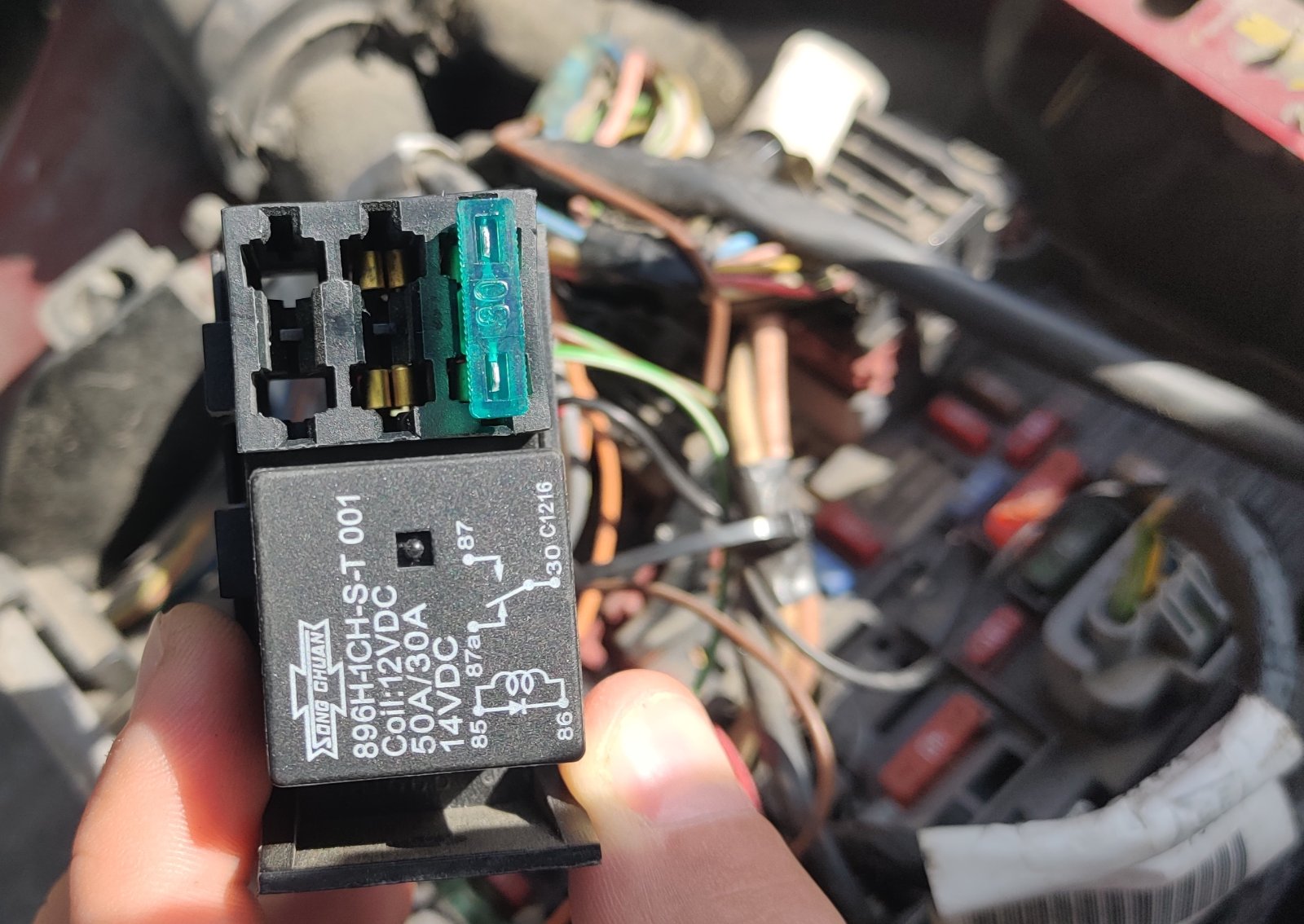

Could a faulty relay cause this and if so where is it located? I tried looking for it under the bonnet and one relay next to the 30A fuse was a 50a/30a switch relay. (896H-1CH-S-T 001) I tested the resistance between pins 85-86 and it was 90 ohms as the datasheet says.
Or is the issue caused by fan speed not being transmitted to ECU?

Re: Citroen C5 X7 A/C not functioning (heater blower inconsistency)
Worth a shot to be honest for the price of a relay.

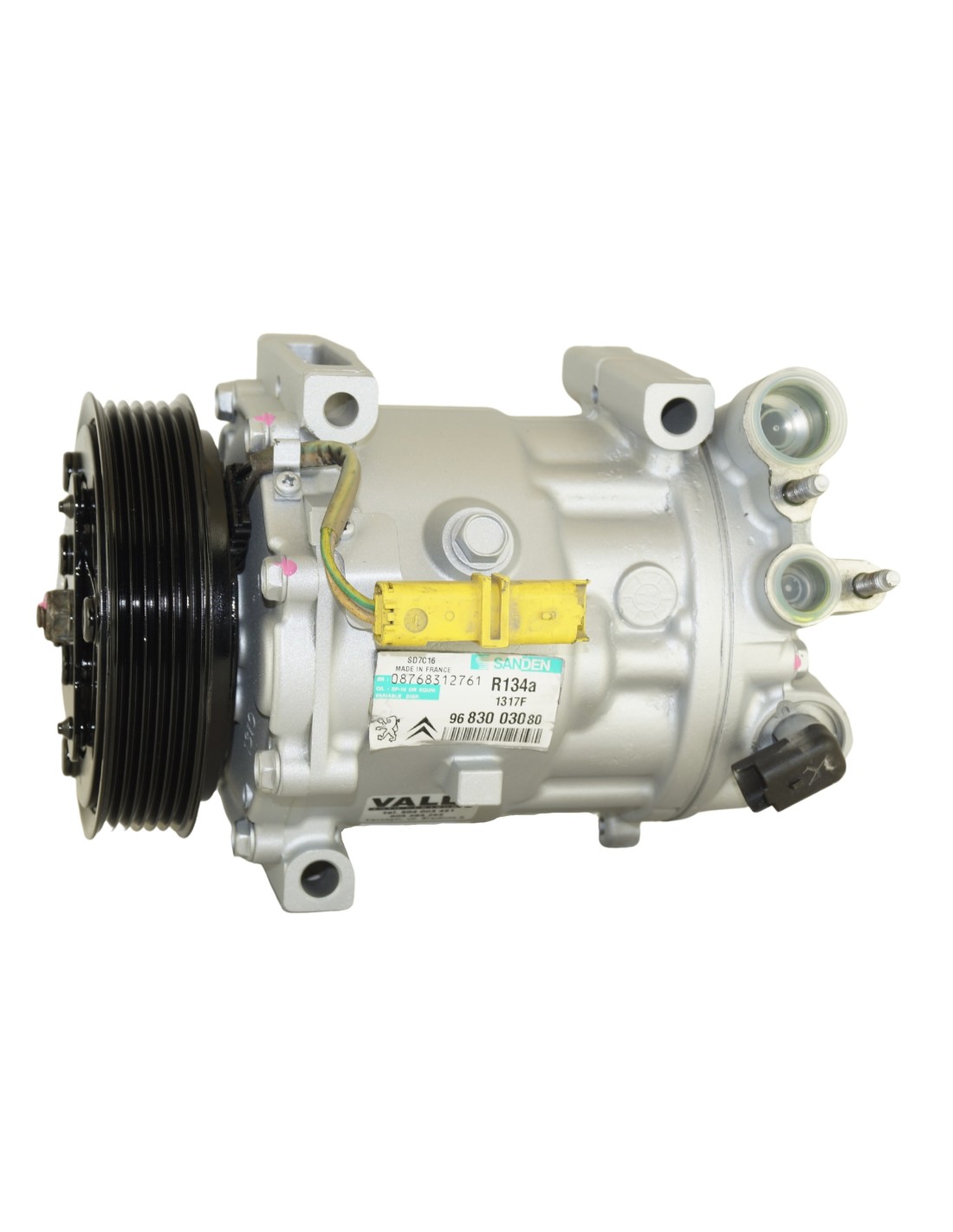

Sorry for resurrecting old thread.
It could be weak compressor solenoid that varies its duty cycle. It seems that it has it, black plug on bottom right
https://kompressorenklimaanlagen.de/en/ ... 11426.html
It's common problem on VAG cars but those don't have magnetic clutch.
