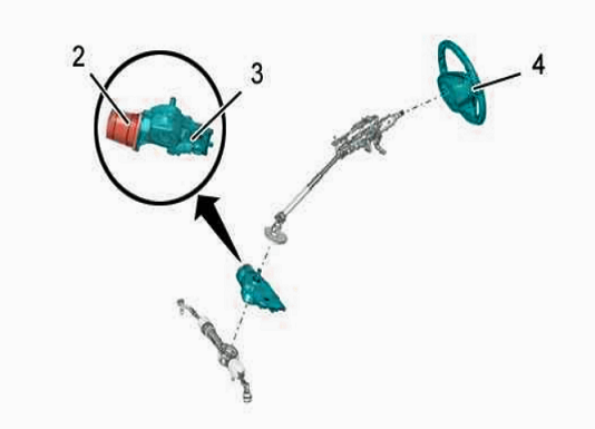

Re: Citroen DS3 HDi 90 Steering Angle Sensor Location
Ok, so on your vehicle uses a specific type of Electric Power Steering, the Torque and Position Sensor are shown below along with an explanation of the components and the working:
(2) Power steering electric motor.
(3) Electric power steering ECU - Torque and position sensor.
(4) Steering wheel.
"a" Power steering electric motor.
"b" Steering wheel torque and angle sensor (Absolute steering wheel angle) (*).
"c" Electric power steering ECU.
"d" Steering rack.

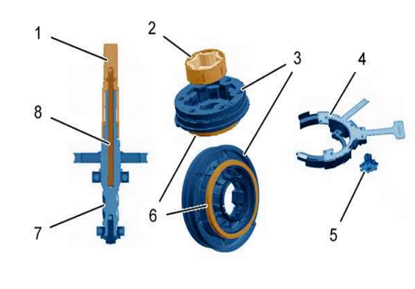

The torque sensor permits continuous measuring of the torque applied to the steering wheel.
The torque sensor determines the following parameters:
The electric power steering then has the job of sending the steering wheel angle information on the CAN once the engine is started.
Funtion
(1) Pinion stem.
(2) Upper rotor.
(3) Lower rotor.
(4) Hall effect sensors support.
(5) Geneva wheel (*).
(6) Steering wheel angle sensor magnet.
(7) gear.
(8) Torsion bar.

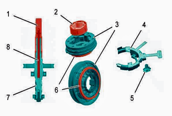

The Hall effect torque sensor has no contact.
The torque sensor located on the pinion shaft is used for measuring, in real time, the torque applied to the steering wheel by the driver (Value of the torque between + 10 Nm and -10 Nm).
The pinion stem (1) is linked to the pinion (7) via a torsion bar (8).
Each rotor consists of an opposition of South/North magnetic poles:
The angular offset of the 2 rotors produces a variation in the magnetic flow which is converted into an electric signal by 2 Hall effect sensors.
For vehicles that have ESP, the torque sensor is complemented by the following specific components:
The Geneva wheel (5) gears onto the tracks of the lower rotor (3) in such a way that it turns 1/10th of a rotation for every 180° of rotation of the upper rotor (2).
The Geneva wheel (5) measures the steering wheel angle on starting.
(4) Steering wheel.
"d" Steering rack.

(1) Pinion stem.
(2) Upper rotor.
(3) Lower rotor.
(7) gear.
(8) Torsion bar.
- The upper rotor (2) is solid with the pinion stem (1)
- The lower rotor (3) is solid with the pinion (7)
- Geneva wheel (5)
- 2 Additional Hall effect sensors

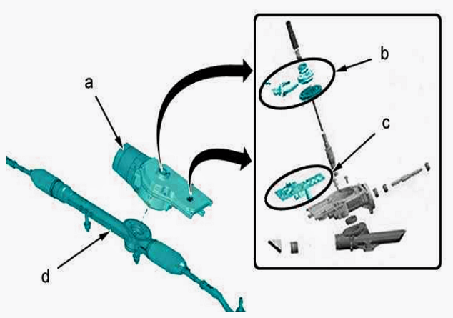

Hi
It all depends on the vehicle and the type of power steering / engines fitted etc. I have included the specific info as it relates to your DS3 below as there are some differences:
In your case the Steering Wheel Angle Sensor is located in the electric power steering system fitted on the steering rack itself.
If the rack is removed and refitted, the steering wheel angle sensor must be calibrated.
"d" Steering rack.
"d" Steering rack.
