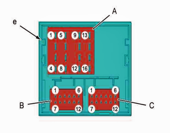

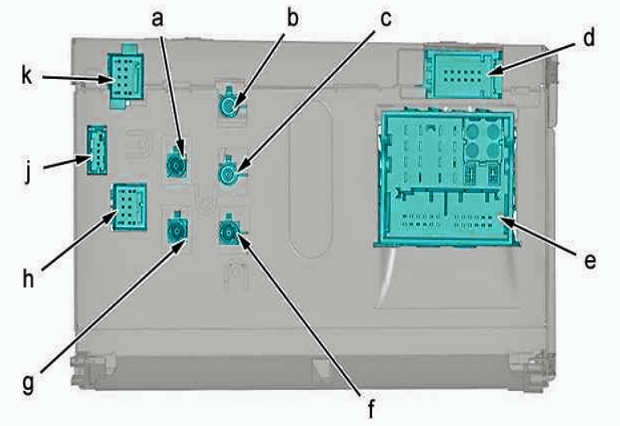

Ok, so here are the main pinouts. The Microphone is in 'Part 'b', however, be aware that your vehicle, like mine has the service module installed. This is essentially similar to an independent telematic unit (similar but not the same), so for emergency services (SOS and Citroen Services) functions to work it uses the SIM card to make these emergency calls and geolocation features. The Services module therefore takes a lot of connections first (including the microphone) and then passes these on tot he NG4. So you won't be able to trace the wire from the ceiling as it will disappear into the loom and then go to the Service Module before being wired back to the NG4 via the quadlock.
"a" Aerial FM2.
"b" Aerial TV2 (for Japan).
"c" Aerial TV1 (for Japan).
"d" MQS cable connector.
"e" 3-part connector.
"f" GPS aerial .
"g" Aerial FM1/AM.
"h" LVDS 2 cable connector.
"j" USB socket connector.
"k" LVDS 1 cable connector.
"d" 12-way Blue connector
Part "A": 16 way connector
Part "B": 12 way connector
Part "C": 12-way black connector (*)
"a" Aerial FM2.
"f" GPS aerial .
"g" Aerial FM1/AM.

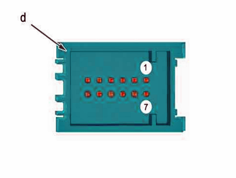

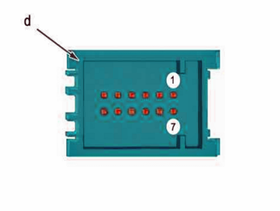

| Channel number | Allocation of channels of connector |
| 1 | Audio signal + (Service module) |
| 2 | Audio signal - (Service module) |
| 3 | CAN High |
| 4 | Channel not allocated |
| 5 | Channel not allocated |
| 6 | Channel not allocated |
| 7 | Channel not allocated |
| 8 | Channel not allocated |
| 9 | VAN Low |
| 10 | Channel not allocated |
| 11 | Channel not allocated |
| 12 | Channel not allocated |
| 1 | signal: Right hand rear speaker |
| 2 | signal: Front right hand speaker |
| 3 | signal: Front left hand speaker |
| 4 | signal: Rear left loudspeaker |
| 5 | Earth: Right hand rear speaker |
| 6 | Earth: Front right hand speaker |
| 7 | Earth: Front left hand speaker |
| 8 | Earth: Rear left loudspeaker |
| 9 | Supply: Screen DG4 |
| 10 | Comfort CAN High |
| 12 | Battery + supply |
| 13 | Comfort CAN Low |
| 14 | Channel not allocated |
| 15 | Earth: Screen DG4 |
| 16 | Earth |
| 1 | Video input no 1 + |
| 3 | Earth: Microphone |
| 4 | Right-hand audio auxiliary |
| 5 | LIN bus for screen DG4 |
| 6 | Video input no 2 + |
| 7 | Video n°1 - |
| 9 | Input: Microphone signal |
| 10 | Left-hand audio auxiliary |
| 11 | Audio earth |
| 12 | Video n°2 - |
| 1 | Earth: CD changer |
| 2 | VAN Low: CD changer |
| 3 | Permanent +: CD changer |
| 4 | Right audio system: CD changer |
| 5 | Rear socket LH audio output signal |
| 7 | CAN High: CD changer |
| 8 | Earth: CD changer |
| 9 | Rear socket RH audio output signal |
| 10 | Left audio system: CD changer |
| 12 | Rear socket audio output earth |
