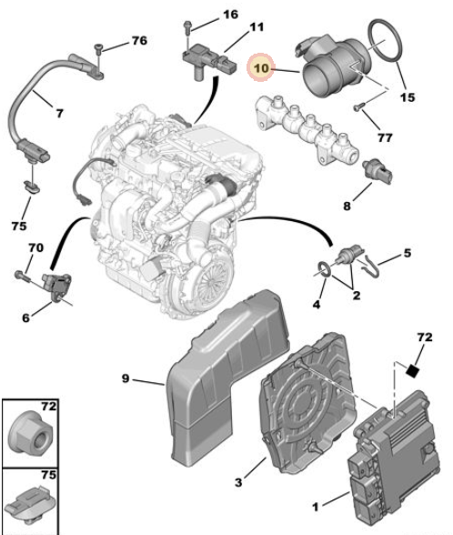

Item (10), Part: 1920RA, £231.91 inc VAT direct from Peugeot.
Be aware if comparing, you may not find this same part number on the MAF as this is an internal PSA part number.
