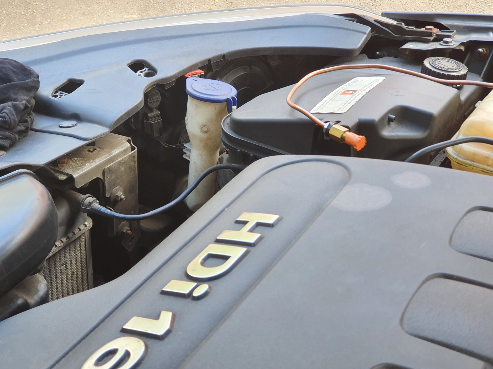

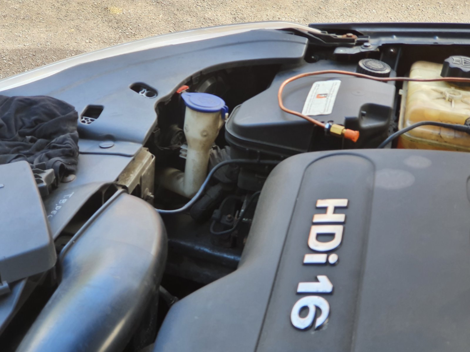

You can see the LDS gubbins is taking up space but you can still reach in

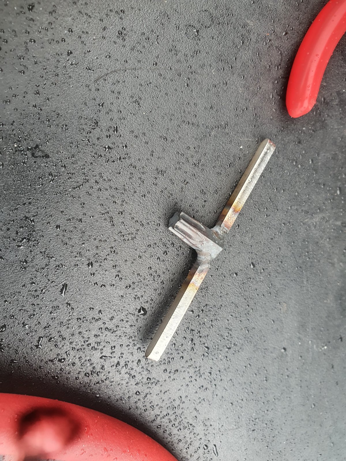

It's such an awkward job I attempted to make a little tool for't..
T40 with a short bit of steel attached
Did it work?
Too right!
Still a real struggle with the ever present danger of dropping things to disappear intothe bumper..
It was actually quite easy to engage the tool and turn the bulb 90 deg but actually pulling it out was difficult and I resorted to needle nose pliers at 90degrees. They were tight despite only going on a few months ago.

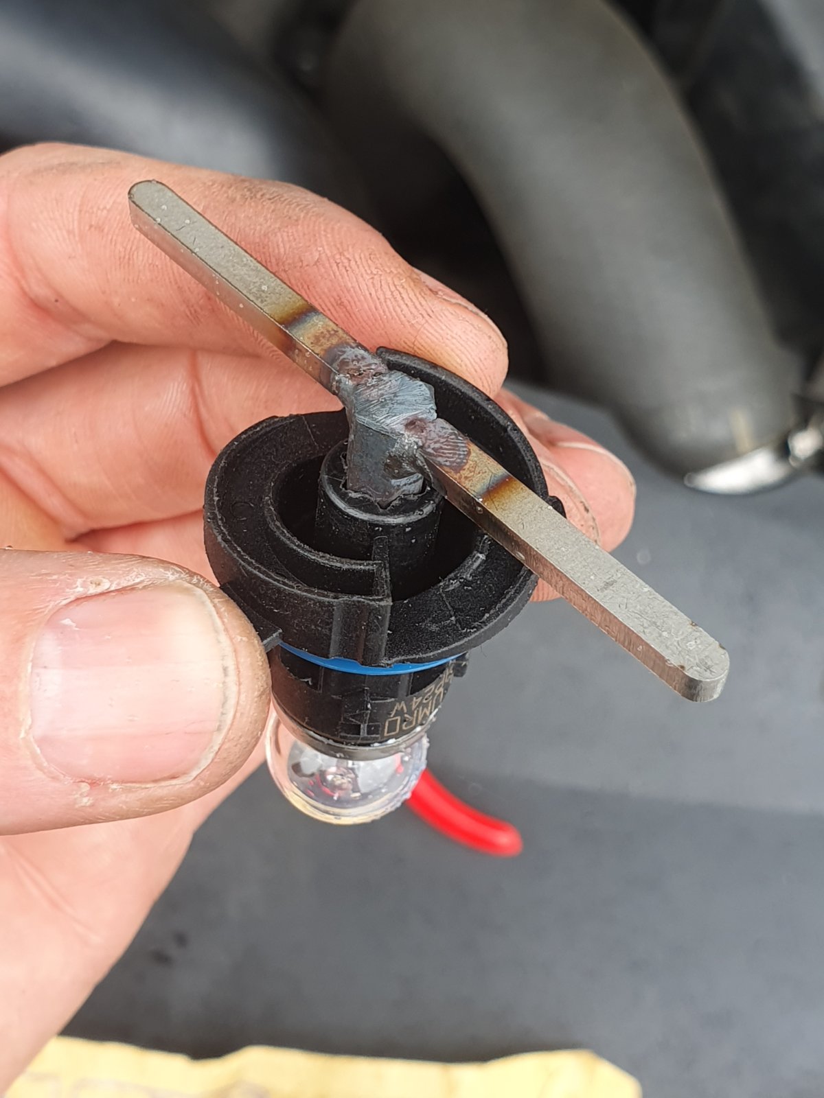

Here's how the tool locates (on the old bulb)
