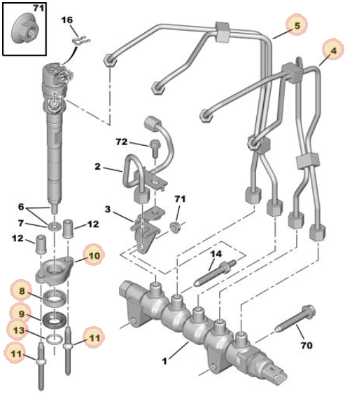

Re: Fuel Leaking At Injectors
I've only just seen this, but can confirm what Richard has said about replacing the injector pipes when replacing the injectors, as they become compressed when tightening, so when removing and then reusing them they can become deformed, leading to issues.
Also, as far as the injector holder components are concerned, there have been quite a few replacement parts for these as you can see:
Item (4) Cylinder 1 & 2 Pipe Harness, part: 1570G4, £74.27
Item (5) Cylinder 3 & 4 Pipe Harness, part: 1570G5, £74.27
Note RP = Updated / Replacement Part
Item (8) Engine Injector Protector, Part: 1609848080 (RP), £5.64
Item (9) Engine Injector Seal, Part: 1609848280 (RP), £3.89
Item (10) Fork, Part: 1609848680 (RP), £21.97
Item (11) Injection Holder Clamp Pillar Screw, Part: 198283, £2.83
Item (13) Circlip, Part: 1609848880 (RP), £0.42p
Doo
(Donor 2022)
Posts: 490
Joined: 09 Sep 2019, 16:53
x 121
Unread post by Doo »
Hi Marc, thanks very much.
I can confirm I have replaced parts 7, 8, 9 & 11.
Parts 10 & 13 came with the replacement injectors.
I have a horrible feeling I may have suffered a problem when they dressed the injector seats in that they may have gone too far. But I fear I have no redress as I paid for a casher #-o
So, if this "is" the case, am I to understand the only fix will be a replacement head and all that entails :bigcry:
I am 100% that 2 of the seats are mis-shapen :roll:
But this has to be a known issue and there "has" to be a fix.... :?
