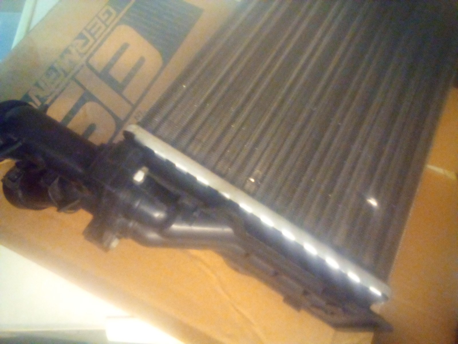

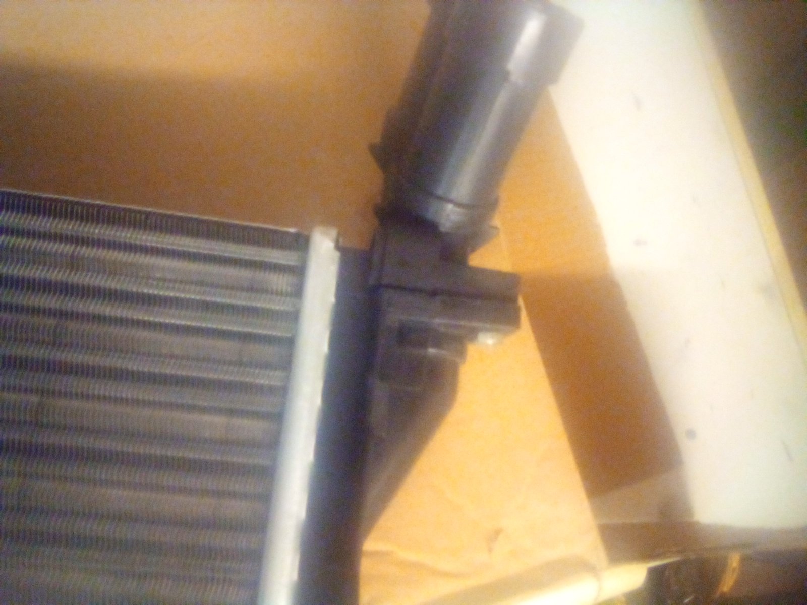

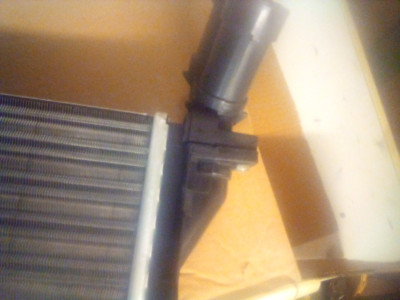

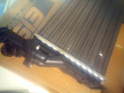

Matrix ordered and arrived Monday...
See pictures and tell me what you think please...

Not very good images I`m afraid, it looks like a 306 matrix. What make is it?
picassodad
- Posts: 251
- Joined: 04 Oct 2018, 14:26
- x 15
Re: Dash removal
Hi oldpug, EIS but think it's made by valeo...
My concern is the poor fitting bolt on plastic heater pipe stub.
Two bolts hold it on. One side is flush but the other side has a gap.
Will it leak I wonder !
Going to ecp tomorrow to compare...then take it from there....
