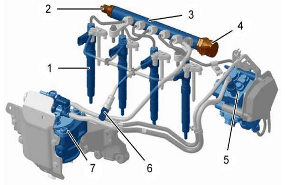

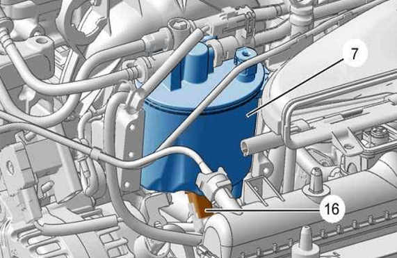

Possibly, lots of later vehicles also don't have the sensor anymore, to save money, but the connection is officially shown on your 2.2 (DW12BTED4 FAP) at (16) on the second image.
(7) Fuel filter.
(16) Sensor for presence of water in diesel fuel (4050).
| Reference | Designation | Part number in the electrical diagrams |
| (1) | Piezo-electric controlled diesel injectors | 1131 - 1132 - 1133 - 1134 |
| (2) | High pressure fuel sensor | 1321 |
| (3) | Fuel high pressure common injection rail | - |
| (4) | High pressure fuel regulator | - |
| (5) | high pressure fuel pump | - |
| (6) | Diesel injector return 10 bar valve | - |
| (7) | Fuel filter and water in diesel fuel sensor | 4050 |
(7) Fuel filter.
