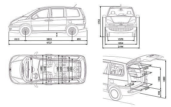

This is all I have onthe dimensions, so probably not much use:

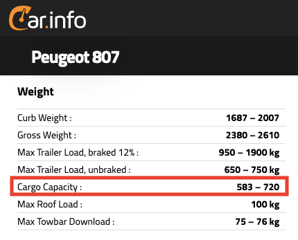

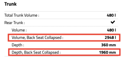

If you take the dimensions as provided by Marc and the capacities which you can find here you should be able to work it out as long as the diagrams are to scale

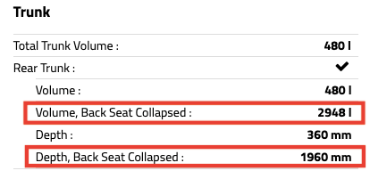

Approx. 2m x 1m x 1m ?
