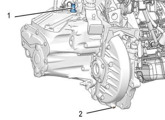

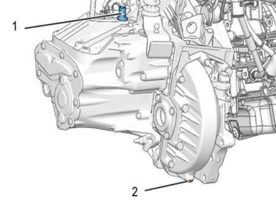

Here you go, you have an MLUC gearbox on this model, so not the same as you expected.
(1) Filling and venting hole.
(2) drain plug.
Always fit a new seal after draining at (2)
You refill it via the venting hole (1) using a gravity fed container and tube.
Recommended oils:
ESSO 75w80 EZL 848
TOTAL 75w80 H 6965
Quantity of oil to be replaced:
After draining: 2,1 litres
After overhaul: 2,4 litres
(2) drain plug.
Recommended oils:
ESSO 75w80 EZL 848
TOTAL 75w80 H 6965

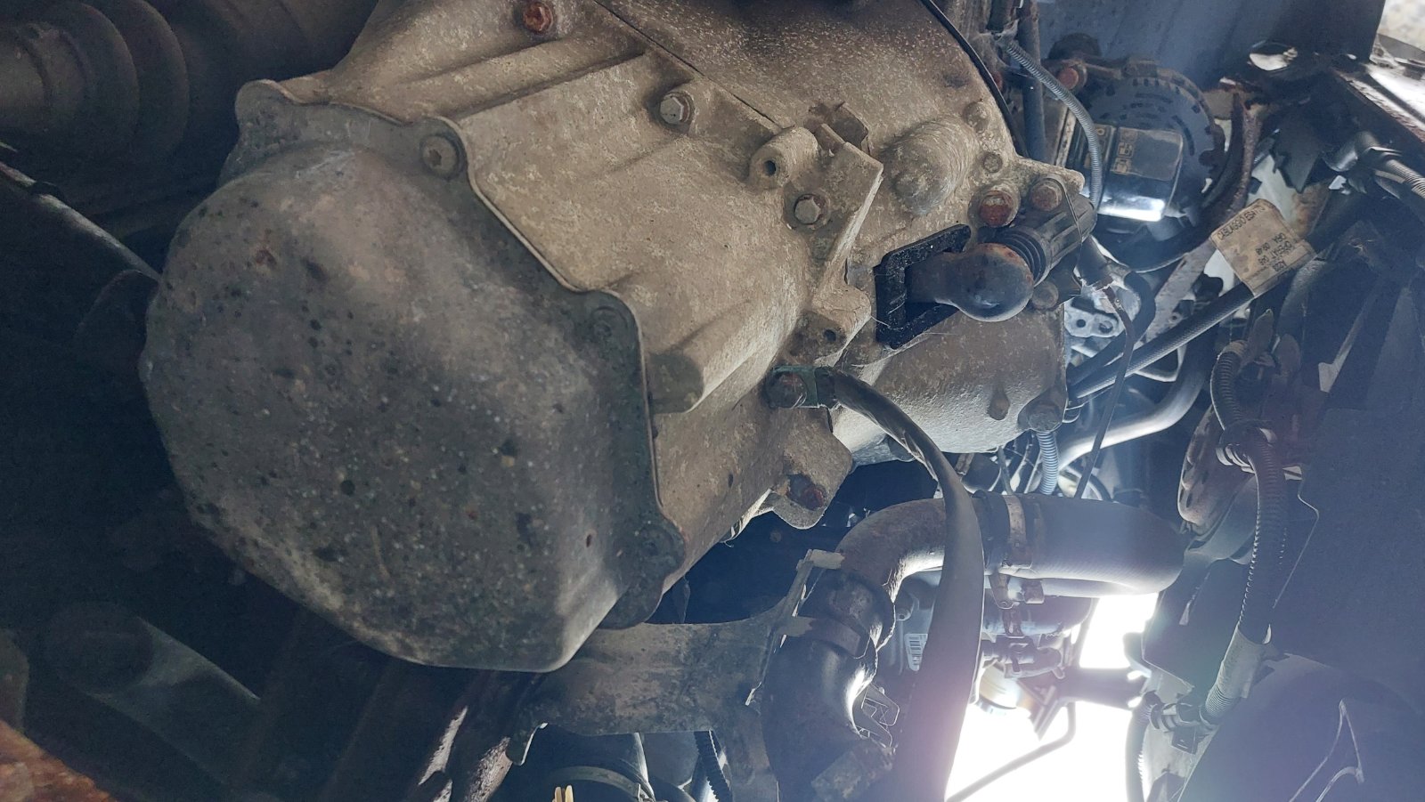

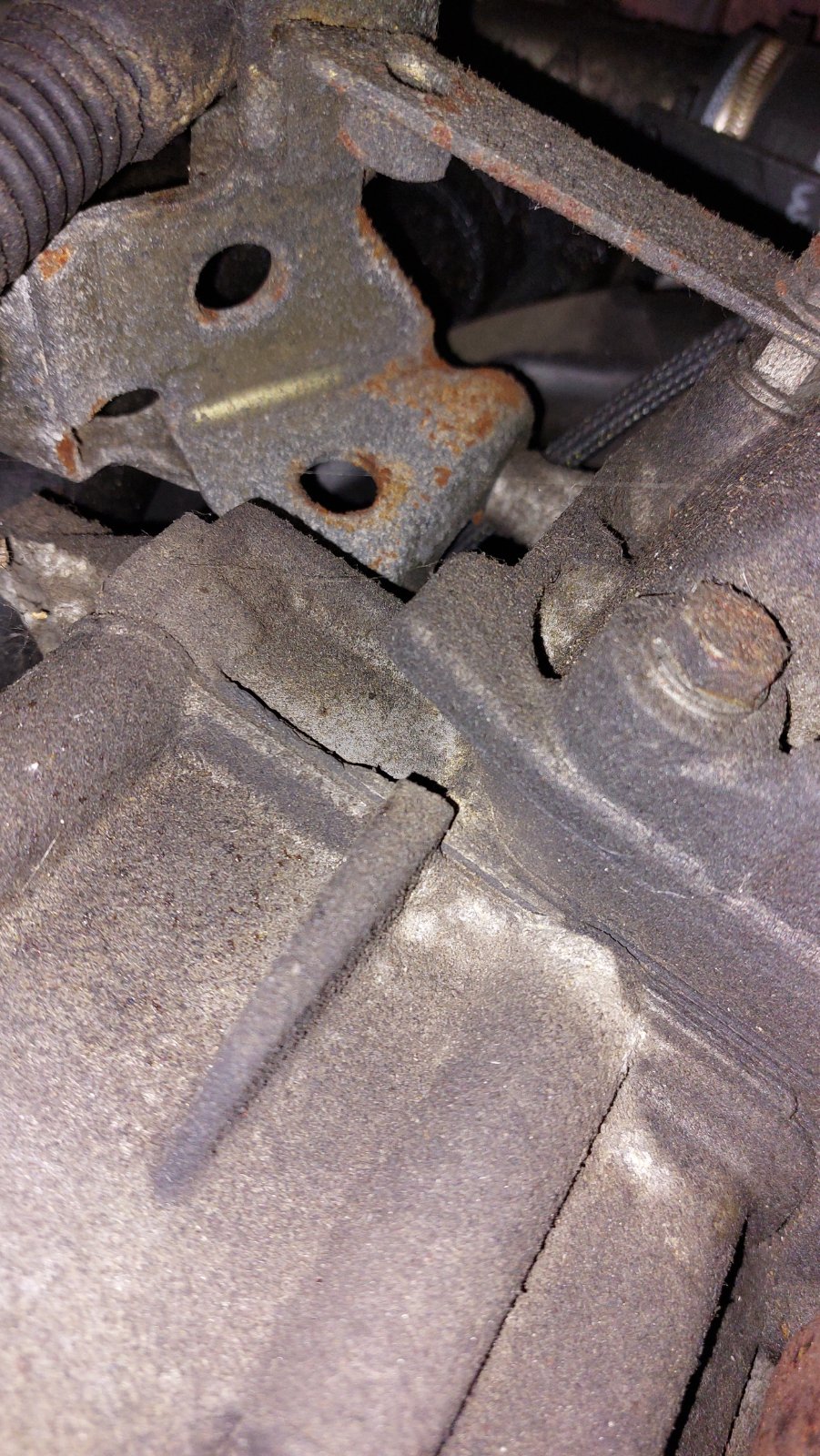

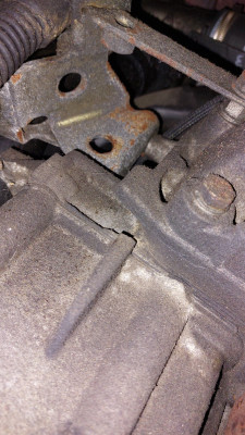

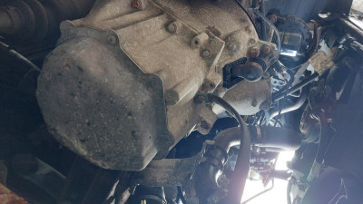

Thanks muchly for your input but I think it's different. I just crawled under and took these pics. One shows the end cover which is significantly different to the illustration and I think the other picture shows the top of the box. Difficult to say as it was at arm's reach between other bits. Whiich leads me to the next question; how on earth do you get to the top of the box to find the refill point? I tried taking the air filter off but it doesn't help at all and taking the air filter canister off is difficult in the extreme as the three bolts in the bottom of the canister are pretty rusted up. (The main pic seems to be upside down until you click on it to enlarge)
Edit; I can reach the breather from the front by fumbling about with my finger tips. Getting a tube into that is going to be fun.

As far as you are aware, are there just these two gearbox options? My gearbox certainly has the appearance of the second example as the steel end cover is so significantly different. Using my reg number only, the local Peugeot main dealer has told me capacity is 2.1 litres but if they have assumed I have the MLUC gearbox that would clearly leave me with a gearbox that is inadequately filled if it really needs 2.7. I'm concerned as much about overfilling as I am underfilling. Arggh!

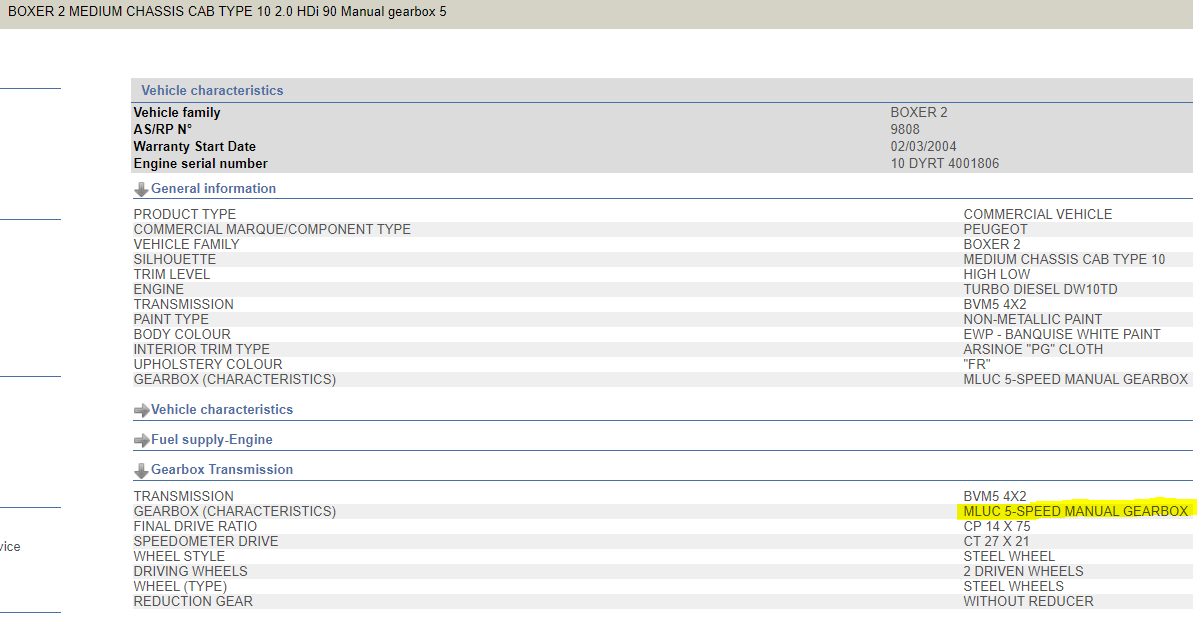

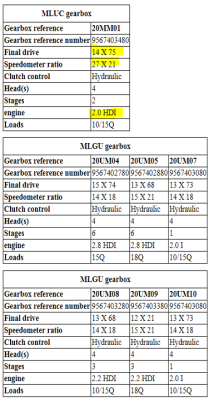

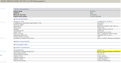

The dealer would be seeing the same info as me - see below extract from PSA's own server based on your VIN - as you can see where I have highlighted, it clearly states MLUC, which is why I put the original picture up. The only other thing I can think of is if the gearbox has been replaced at some point with another version.....

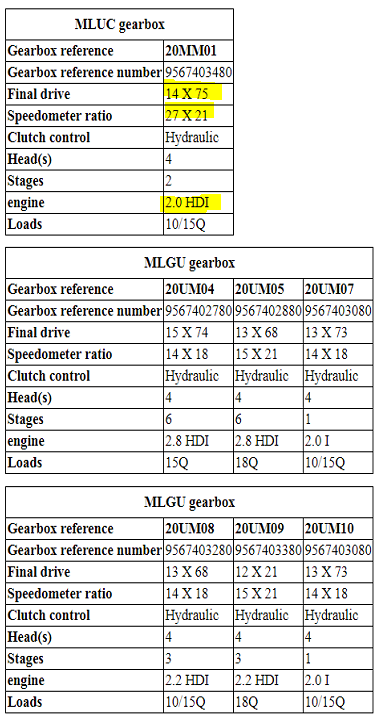

Click Images to Zoom Again, if we look at the specs of the available gearboxes below for this Boxer, you can see that only the top table refers to the 2.0HDi engine and also the final drive and ratio data also corresponds with the specs extract above. The other tables and gearboxes are only relevant to the 2.2, 2.8 HDi engines and the 2.0 petrol.... so in other words the MLUC gearbox was only fitted to the 2.0 HDi (90 BHP) version.

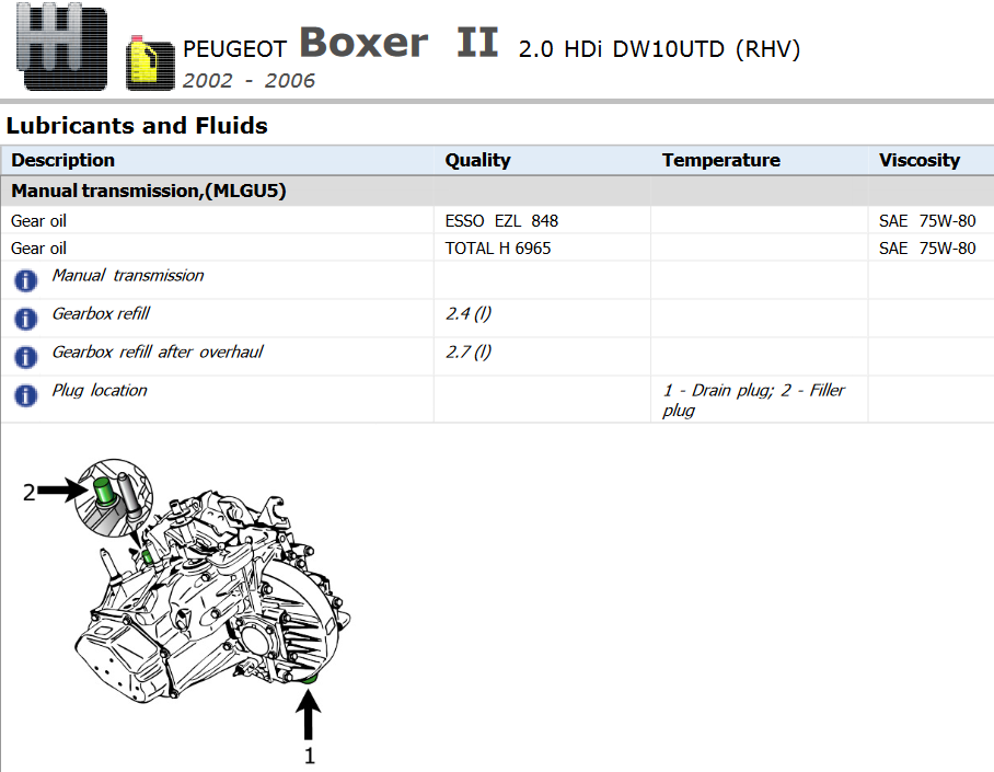

EDIT: I've also found the attached now that refers to a gearbox of my visual type. Maybe MLGU5 or MLUC5. Maybe I should play safe and just go for 2.4 litres. In my position, what would you go for lol.

I would stick to 2.4l - down the line as it's not technically an overhaul where the gearbox has been out and disassembled - only drained. So there's 300 ML in it really.
