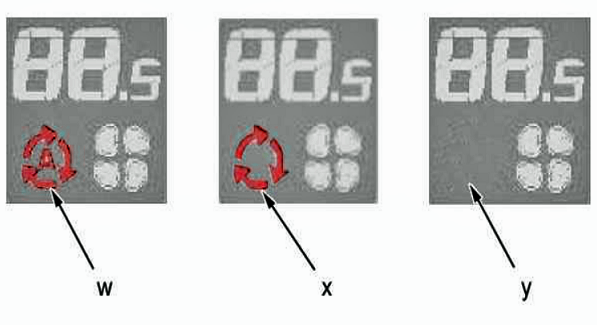

In AUTO mode the system controls partial or full air recirculation mode. When this happens, will depend on what the air quality sensor itself is detecting. Mostly these are oxidising and reducing gases (NOx & CO).
So it is autonomous in AUTO mode.
Air intake function in AUTO Mode
  • The air conditioning system can control partial or total air recirculation.
  • The air conditioning system does not force the intake of exterior air at 100 %.
  • The passenger compartment air recirculation control is pressed, the AUTO mode is not deactivated, the control of the air intake alone is modified.
See below for what the different modes are depending on the mode of the recirculation button when pressed:
"w" Symbol for automatic control of the air intake with taking into account of the air quality.
"x" Symbol for forced recirculation.
"y" Symbol for automatic control of the air intake without taking into account of the air quality.
Also, note:
When one of the two "AUTO" mode buttons is pressed, both the driver’s side and the passenger’s side switch to "AUTO" mode.
When both sides are in "AUTO" mode, pressing one of the "AUTO" mode buttons only permits the resumption of manual control on the side on which the button was pressed, the other side remains in "AUTO" mode.
