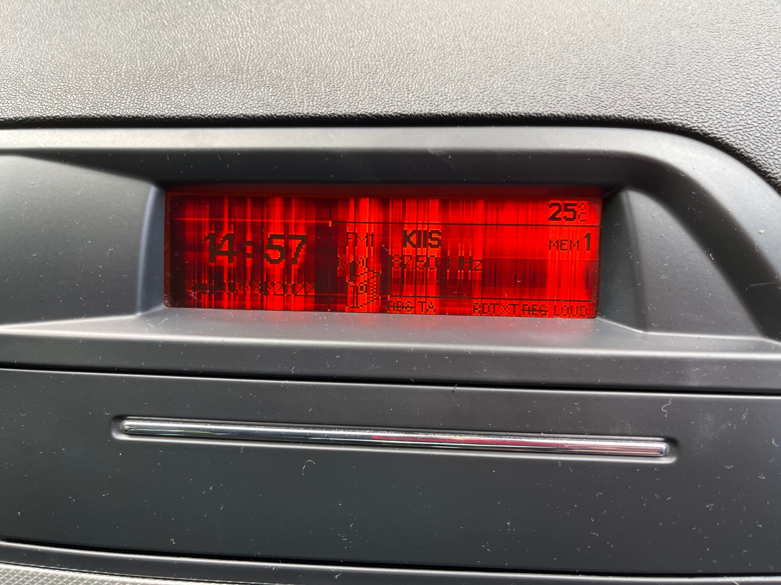

Hi all, my EMF-C display is unreadable at this point and needs replacing.
Only problem is that breakers and sellers on Aliexpress are looking for ridiculous money (£70-100) for second-hand units. As I'm quite frugal :-D I was wondering if it's possible to fit an EMF-A display (as these can be had for under 20 quid from Aliexpress, including delivery)? My radio's an RD4 by the way (hw ver d02v01, sw version 40.35)

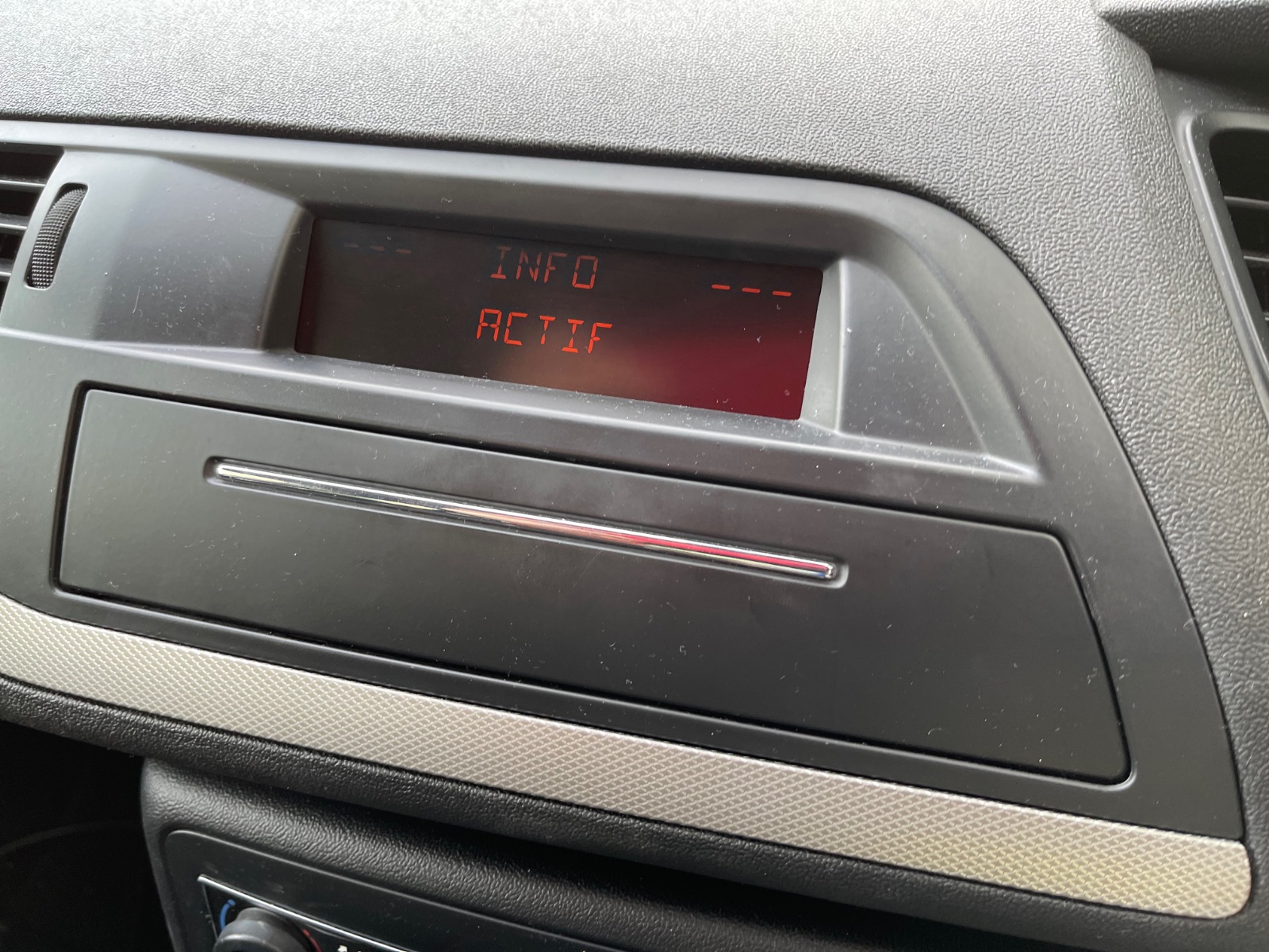

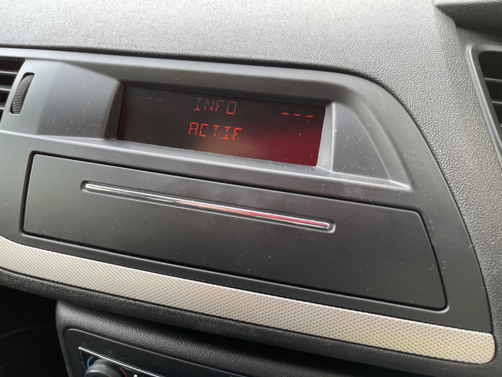

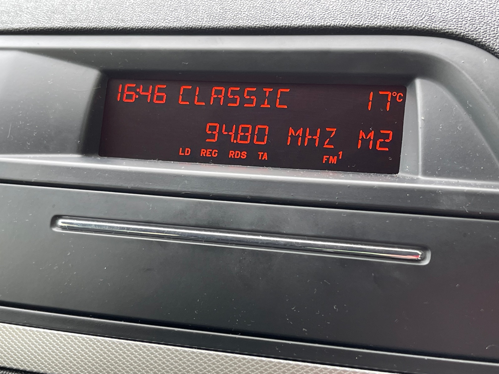

So my €20 (including postage) Aliexpress display arrived from China after nearly a month.
Time to say bye-bye to the old faulty display…
Pull off the silver trim piece to reveal three T20 screws which, when removed, will allow the central dash panel to be taken out. Mine needed a lot of encouragement - use some plastic trim tools if possible.

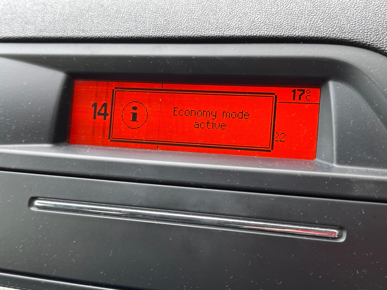

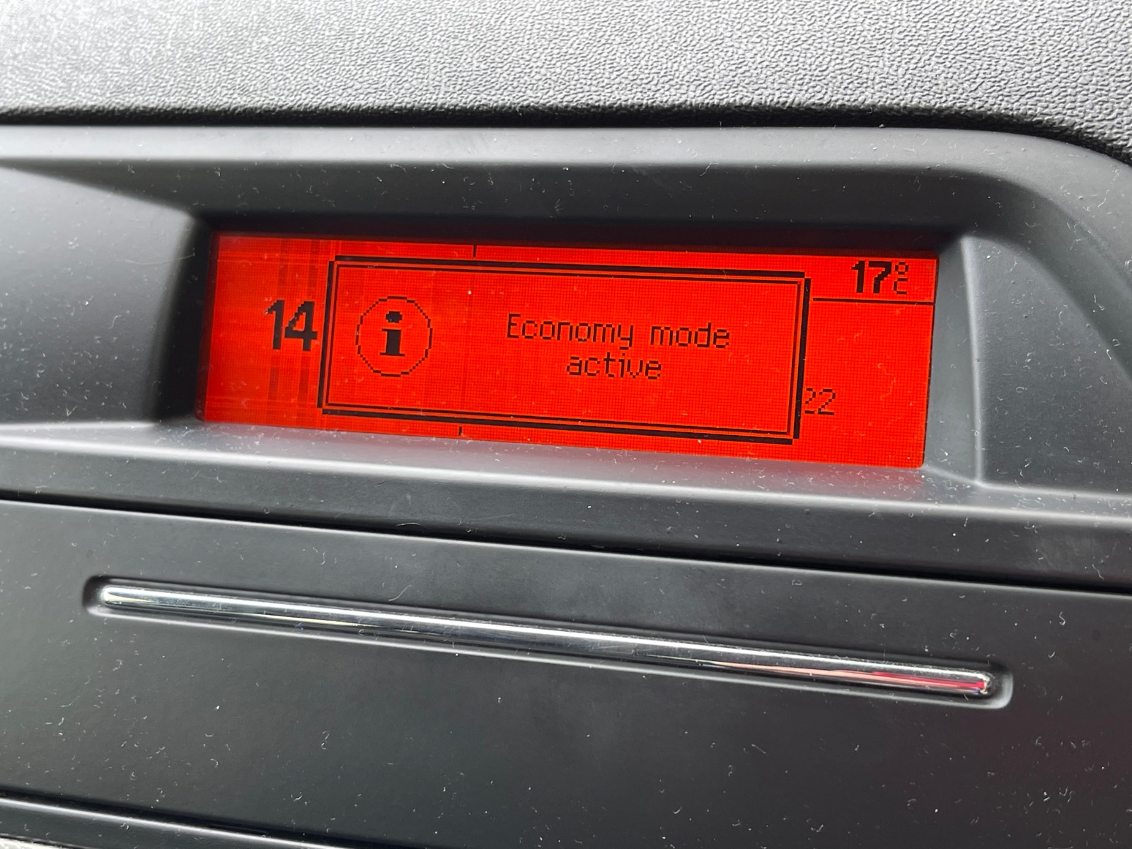

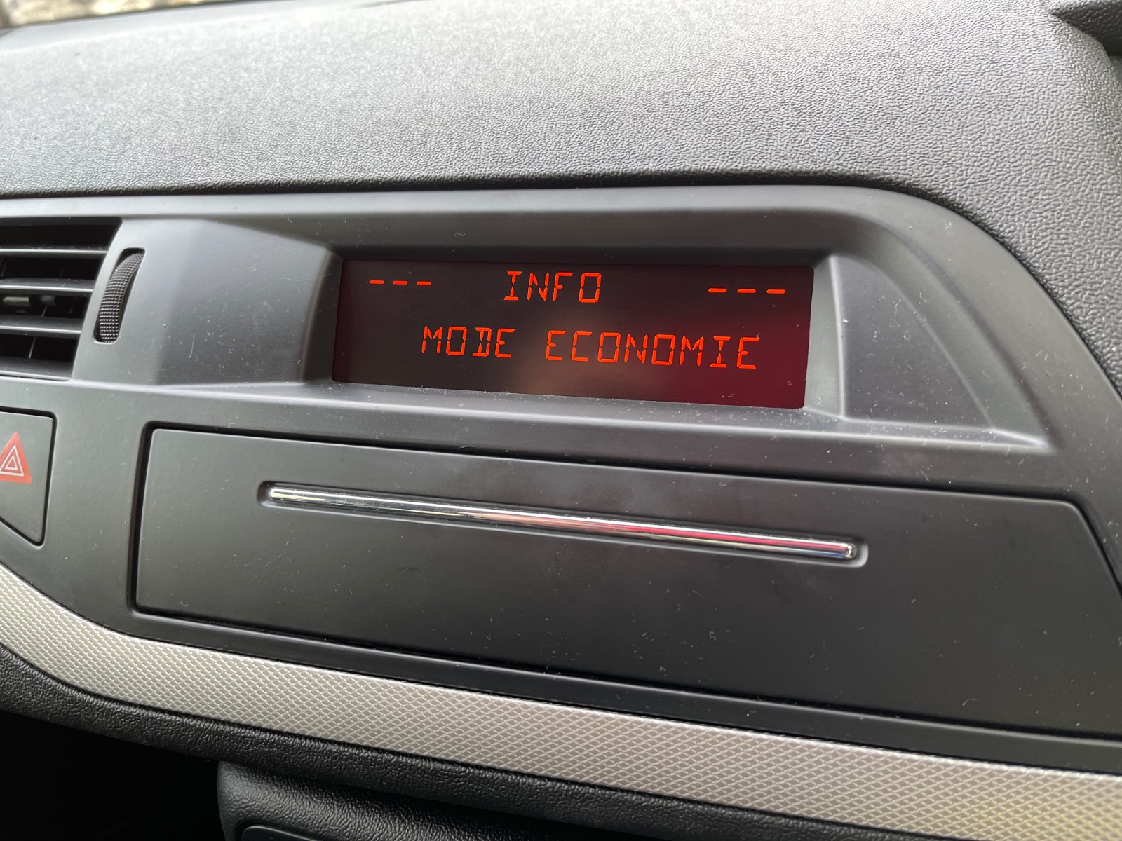

10 minutes later - “Mode economie actif”

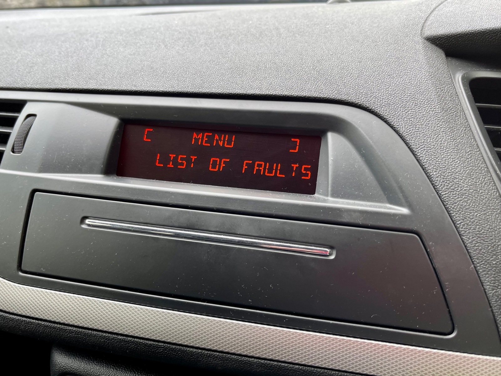

A few minutes later, after changing the language and setting the clock (which had been two hours slow since I bought the car 😄). Perfect…
I don’t seem to be missing any features since changing the display (actually I think I gained some new ones)

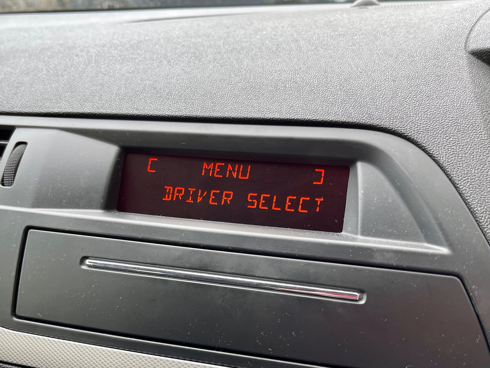

"Driver Select" seems to be a duplication of the speedo menu option to unlock the driver's door only, or all of the doors.

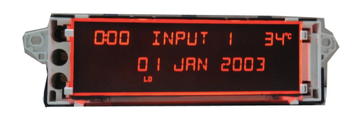

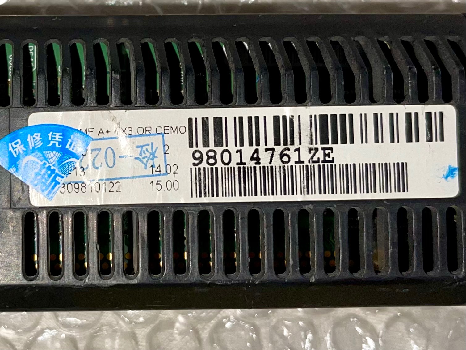

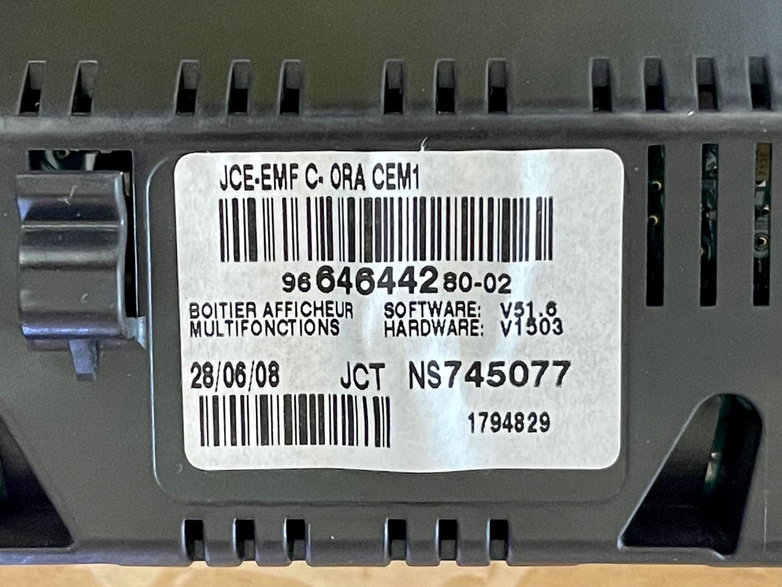

Old EMF-C display (part number 9664644280):
New EMF-A display (part number 98014761ZE):
I hope this helps anyone reluctant to spend 100 quid on a replacement EMF-C display.
