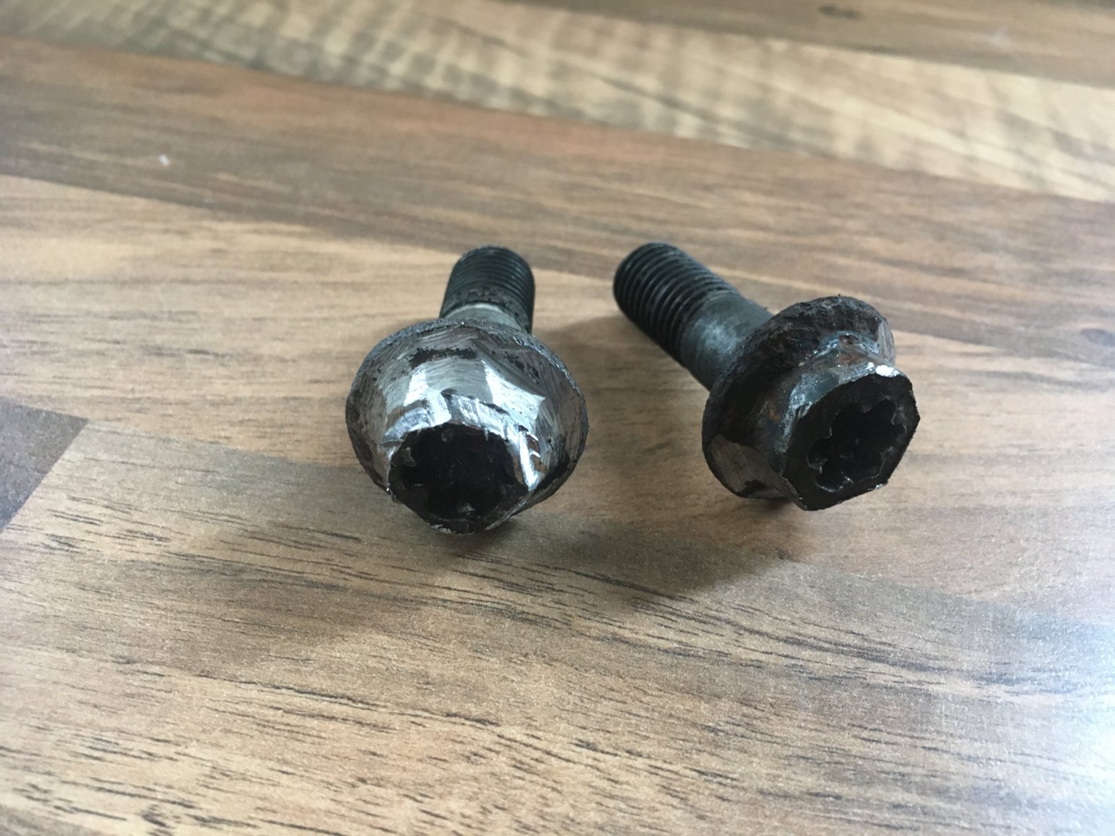

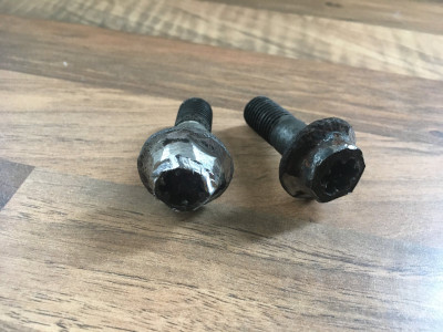

Rounded torx bolts
Used the grinder to flatten the sides and used a long reach 16mm spanner and block mallet to get it moving. It shifted slightly but then rounded off, so ground it down to around 15.5mm, hammered on the rounded bolt extractor, used a 22mm socket and my 650Nm mains torque wrench to release the little pest. Ground the other one down to allow me to drive a 17mm socket on and again with the impact wrench.
Calliper hub bolts 0 - Impact wrench 2 I've not yet found anywhere other than a dealer who sell these bolts for quick purchase, so may just have to be patient. I've forgotten the part no but they're M12x1.5 36mm long. Landrovers and Golf Mk2s use 35mm which would probably do the job with a proper 17mm hex top.
