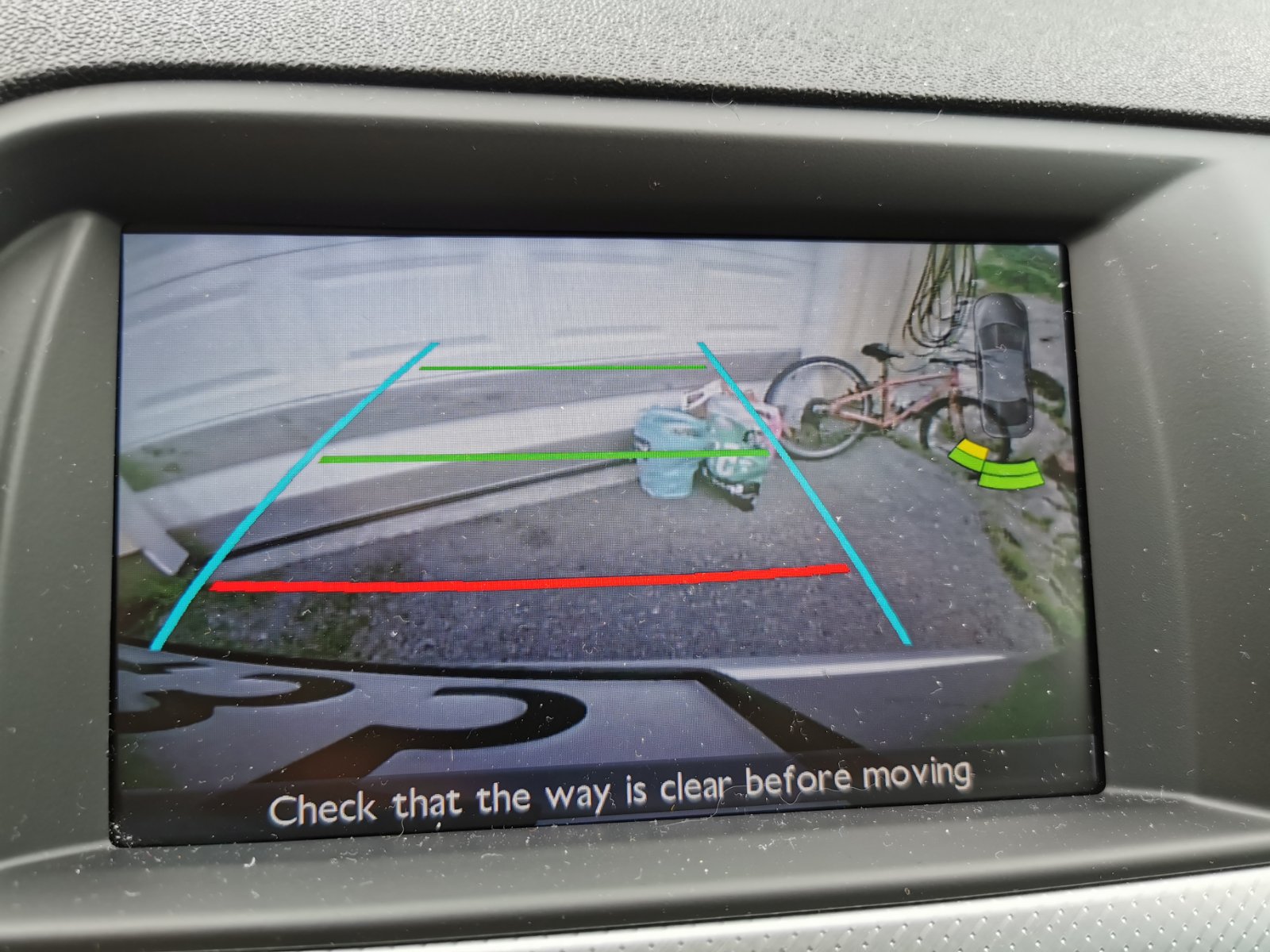

Nice one Marc! Great info. I'll talk with dealer. This car was a demo at this dealer, and not registered until 30.12.2014, when a family member of the owner of the dealer bought it. I bought it while it was just passed 5 years, so I've not used dealer for any service, as I do all myself. But I got replaced the wiper motor for free, even if the warranty was expired.
Since I got the car I think the image is angled a bit low, as you see in picture here quite a portion of screen shows the car itself.. No big deal, but... Anyway pretty useless in dark 🙄😬

Re: RT6: Any point to upgrade 2.8 to 2.86?
fikse wrote: 11 Aug 2022, 13:17 Nice one Marc! Great info. I'll talk with dealer. This car was a demo at this dealer, and not registered until 30.12.2014, when a family member of the owner of the dealer bought it. I bought it while it was just passed 5 years, so I've not used dealer for any service, as I do all myself. But I got replaced the wiper motor for free, even if the warranty was expired.
The image looks ok to me as it's really only for the parking assistance, so shows the grid line range ok and close obstacles. I don't think there are any options for positioning as it's a pretty standard fit Fikse. :wink:

GiveMeABreak wrote: 11 Aug 2022, 13:52 The image looks ok to me as it's really only for the parking assistance, so shows the grid line range ok and close obstacles. I don't think there are any options for positioning as it's a pretty standard fit Fikse. :wink:
OK. Thanks. Talked with dealer. As it was no callback, just a note that IF they got complaint about weak sensitivity in dark areas, the camera is to be replaced. So if I had made a complaint before 5 years... Hehe.
So. About £250,- for the camera and eventually £50 for installation. Hmm. When its no more than 250 for a new unit, here in Norway, I suspect I might find this for a better price other places... OK.
Ill stick with 2.8 firmware, so Im not messing too much.
