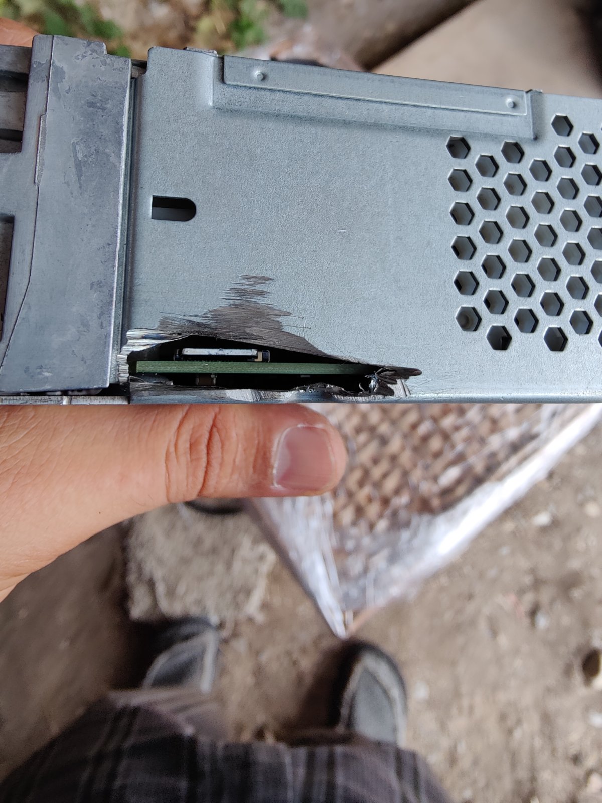

Hello. Please excuse me if the topic does not belong to this part of the forum, but Im fairly new with french cars. Long story short: I own Citroen C4 Picasso MK2 2013 (Avangard I think) and a few days ago the touch screen that is used for controlling everything in the car just froze on the Citroen logo and nothing more. Sometimes it turns itself off then tries to start again but only reaching the Citroen log, something like boot loop of a phone. I took to Citroen dealer, but they told me there are some cuts in the casing of the radio and you need to look for a new one and thats all. I took the car home and decided to take the radio out and see whats going on there and found this(In the attached picture). Honestly Im speechless how someone can cut the casing to reach the SD Card inside when it has some screws and the warranty stickers are torn apart. Inside there is 16GB Kingston Micro SD card. And finally, my question is there something I can do check or I will have to by a new one? Thank you in advance for the help.

It looks like somebody has been there before you!
Possibly to resolve some issues, they replaced the flash memory card. It looks like a butchers job on it though, so either the unit was difficult to open, so looks like they cut into it where the flash card is stored to replace it. Kingston is definitely not an original - they usually use a brand like Sandisk or similar. The dealer will not get involved with repairs - they will only send the units off for a cost, or suggest you source a new unit as you have been told.
I'm not sure whether you can extract the card (usually pushing it in slightly first to release it) and then examine it on a PC in an attempt to copy all the partitions off first, before trying a new card in there after you have formatted the new card to FAT32 and then copied the partitions back (without any hidden windows system files).
The issue is that if the flash card has already started to fail (as they have limited write cycles to the memory cells), then the data may already be corrupt if there are no free memory cells to write to. In that case you may just be copying the faults over.
You may be able to try replacing the memory card, and then copy the partitions over first (without the windows hidden files). Then install the flash memory card back into the unit and update with the latest firmware on the new card.
If everything is working but there are some options missing (reversing camera or other features that are not functioning, then it needs configuring from the dealer. You can ask them to reconfigure the ECU from their servers which should restore the options, but they will charge you diagnostic time for this.
That's all I can suggest to try. Failing that you will need to source another unit and get that VIN coded and configured for the options on your vehicle.

THANK YOU SO MUCH Marc!!!
The SD card goes freely as it should be
At least this is ok and there are no visual traces over the PCB from burnt marks or physical damage.

Hello,
That type of job... i'm shocked
I have changed my micro sd card to 32gb and clone the data from the old to the new one.
It's great to upgrade because the space to have all maps installed and a bigger Jukebox.
But i open and close the radio by the normal way and without making strange holes
My original one its from SanDisk 16GB.
