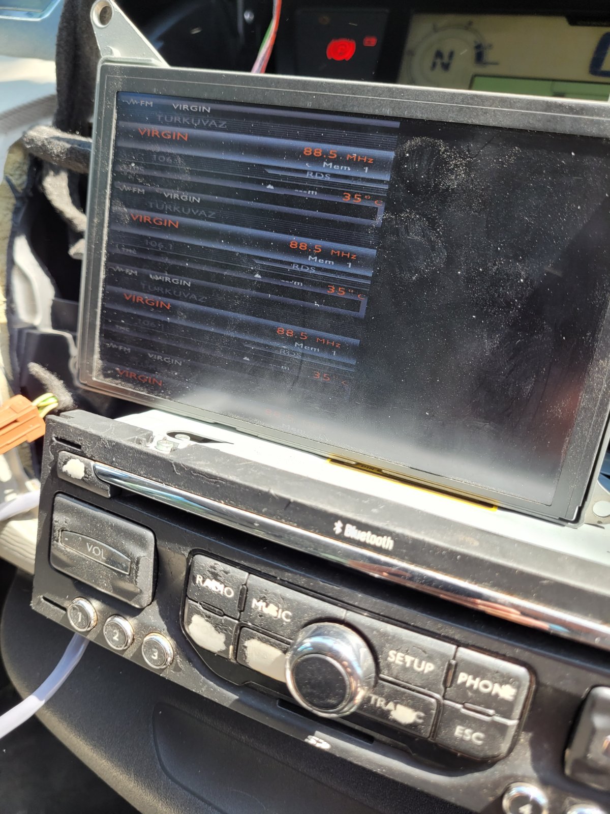

Hi and please forgive me if mi english is bad and if I posted in wrong place, I have a Citroen C4 Grand Picasso and I want to swap monochrome display to multimedia Navi display, I have all the components but something is wrong and I don't know what, the display is from a C4 grand picasso and the radio/Navi unit is from Citroen C5 rneg unit, also the lvds cable is from C5. The resolution is very bad I can't see anything on display.

There could be a number of issues.
The display screens are specific to the telematic units. RNEG (MyWay) uses a low resolution display. If you have a different screen (Hi resolution then it won't be compatible.
Next you may have the incorrect configuration in the BSI, depending on what system you had in the C4 Picasso before. There are a lot of configuration changes that may need to be made to upgrade from a non telematics system to a telematics system.
