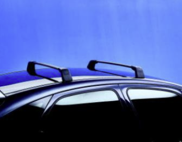

Citroen do a set of roof bars for Picassos with Vinyl sunroof, but the sunroof must not be operated whilst these are fitted: This is the official part for your vehicle from your VIN. There are other accessories like roof boxes and bike mounts, but these are the only bars listed for your vehicle. Relatives had this exact one fitted to their Picasso with electric sun roof.
Part Number: 941556, £160.68 inc VAT direct from Citroen
"For vehicles having a vinyl sun roof, it is recommended to use the bars only with the roof closed."
  • Set of two transverse roof bars in anti-corrosion treated steel covered with a black PVC sheath
  • Secured on the anchoring points on the roof.
  • Maximum load : 75kg.

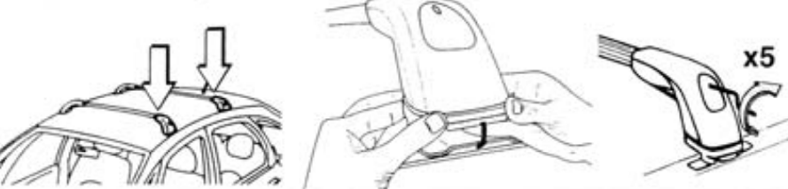

An extract from the fitting instructions to show the fitting type
They fit directly into the vehicles roof bar slots and are then just locked into place and tightened up as shown.
