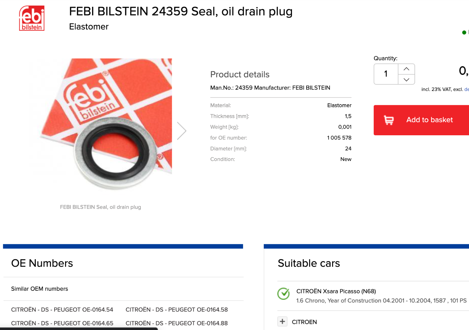

Citroen part no. 0164.88:

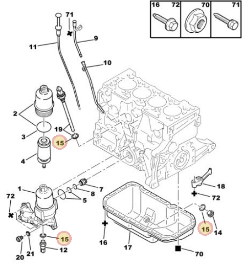

They are dowty type washers on the TU engines & can normally be re used several times if you needed to.
x 6950
Re: Sump plug compression washer? Xsara Picasso 1.6?
Item (15) Seal (16X24-15), Part: 016488, priced £2.11 inc. VAT from your Citroen dealer direct.
