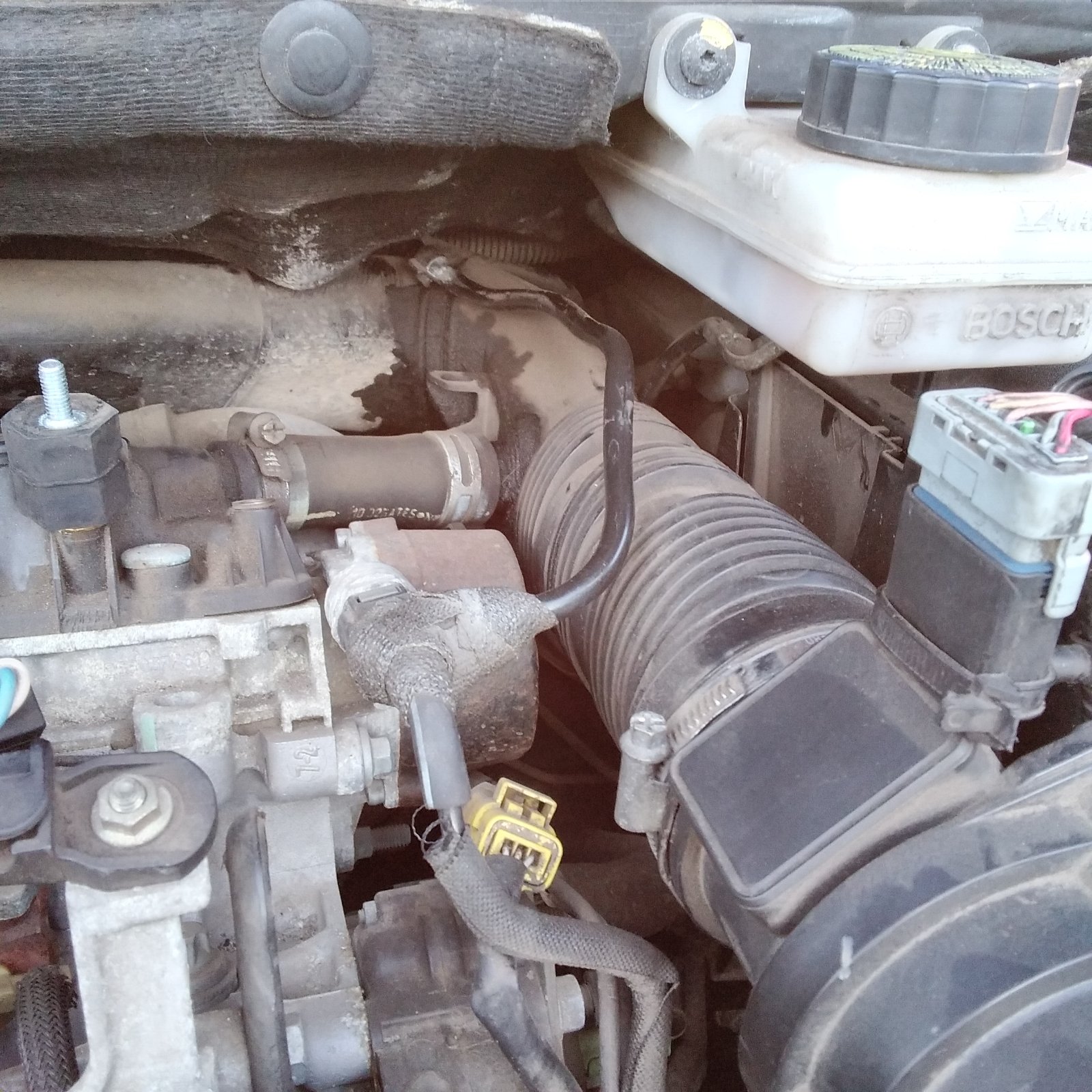

Yesterday 307 ran like a teenager not wanting to get out of bed.
Then the anti pollutant fault with engine check light came on
So i stopped popped the bonnet saw the plug to maf wasn't on properly pushed it back home everything fine , however the driver door won't unlock this is the second time its done this always the following day this happens , after a couple of lock unlock cycles its back to normal. Learning more about this old car as each week passes , former keeper never told me about this or whats in the photo.
Cable tie , lose plug, by previous owner.
