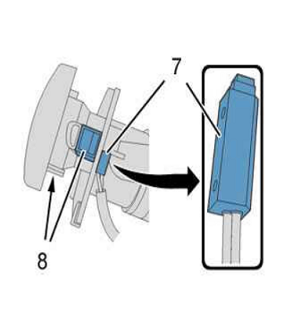

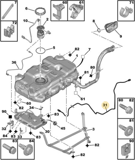

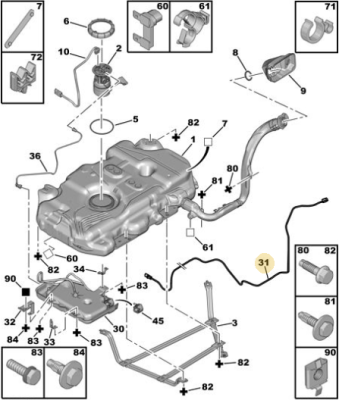

Your vehicle could of been supplied with or without a plug detect harness, that is shown below Item (31), part: 1503CH which is no longer available from Citroen.
If you do have this system you may be able to see if your fuel cap has a magnet as shown which may indicate if this system is used or not. The other differences is are that the older system that I mentioned above also has a separate DPF additive ECU, where the later vehicles make use of the engine ECU to control the additive pump.
Above you can see the end of the plug detect harness at (7) and the magnet (8) on the filler cap. Again - I can't be 100% certain, as they only show 2 types of filler cap - a locking one and one without a lock. So it could turn out that they both have magnets on!
Unfortunately, as these solutions changed through production, they don't specify which system your vehicle has. In cases where the later system is deployed (without the plug detect harness), the warning fault code may be triggered if it is not physically there. So I can't be sure on this.
