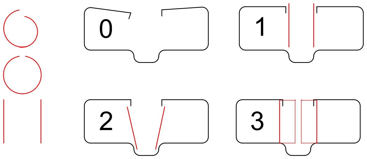

I had this problem when I had a Xantia. I fixed it successfully as follows, though the details are now very hazy.
I inserted a length of 110mm plastic drainage pipe in the tank, something like 150mm long, so that it goes top to bottom, and made with a vertical split so that it can be reduced or increased in diameter. The size is easiest determined with the tank empty so that you can check where it will sit inside. You measure and estimate the height it needs to be so that the top and bottom of the tank will be held parallel.
Make up the bit of pipe as above, coil it slightly to fit it through, then spring it out enough to locate. My memory is that it located round the lip inside the main aperture and was quite stable. Now when the lid/filter part is replaced, the force of the holding clip is supported rather than caving the tank in towards one side, and thus the seal once more works properly. I recall that it did not interfere with the filter, and that the slot when fitted expands to be big enough for free circulation of fluid, but all of the above needs to be checked carefully. It does avoid sealant which is never much fun on something that needs to come off periodically.
