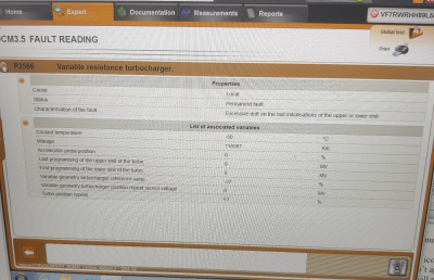

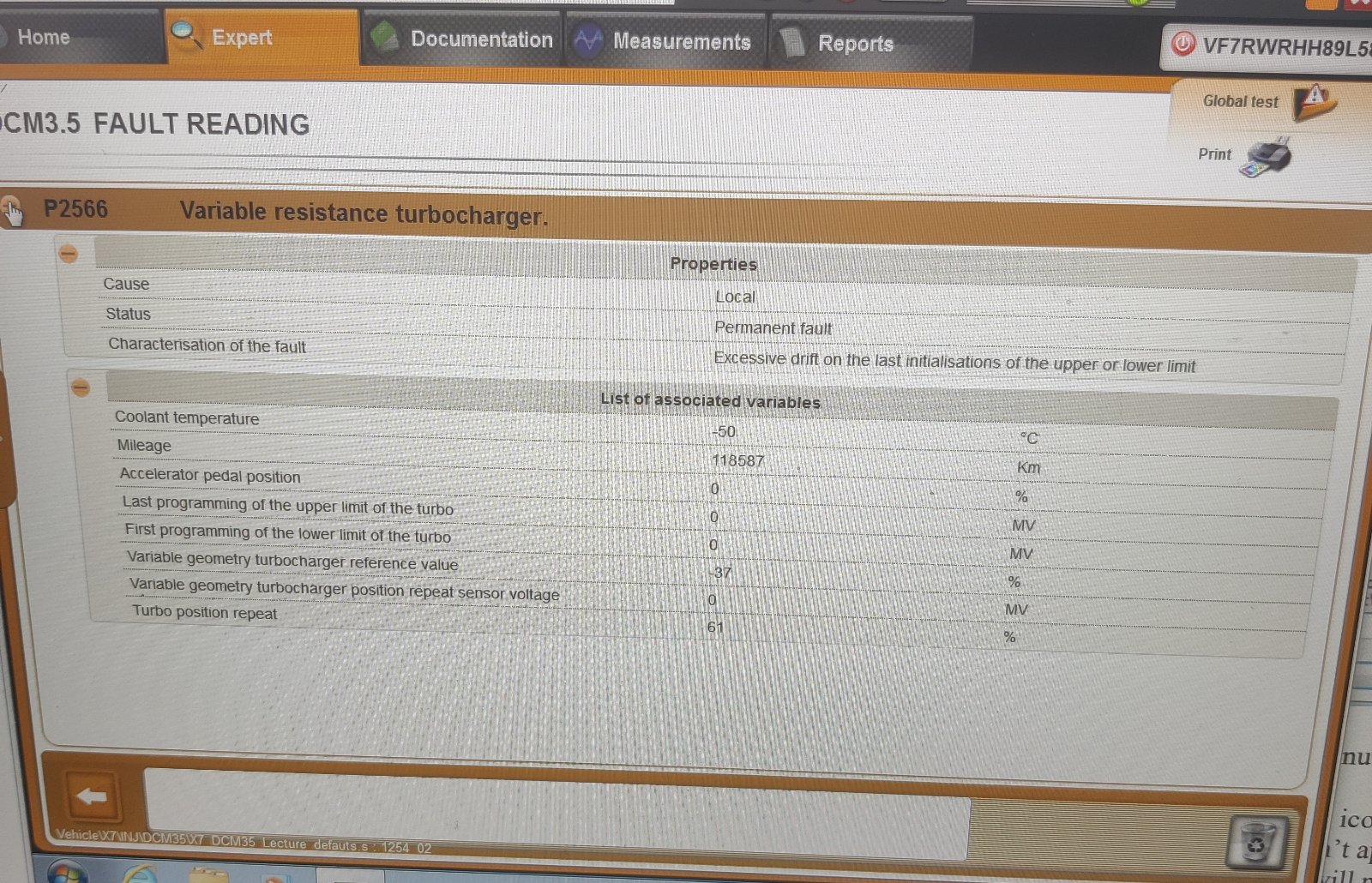

I recently ran my Diabox on my Citroen C5 x7 2010 2l, 120kw and found this fault. P2566 variable resistance turbocharger. Where I should look for the problem?
C5 x7 Diabox fault p2566

Hi and welcome. So this is for the DW10CTED4 163 engine.
Here's the fault code detail for you.
| Fault Code: | P2566 |
| Description of Fault: | Variable geometry turbocharger: Excessive drift on the last initialisations of the upper stop. Condition for appearance: Just after the initialisation of the upper stop.
| Conditions for Fault to clear: | 3 successive starts, allowing time for the network to go to sleep (Power latch) |
| Downgrade Modes whilst Fault is active: | None |
| Symptoms: |
| Suspect Areas: |
