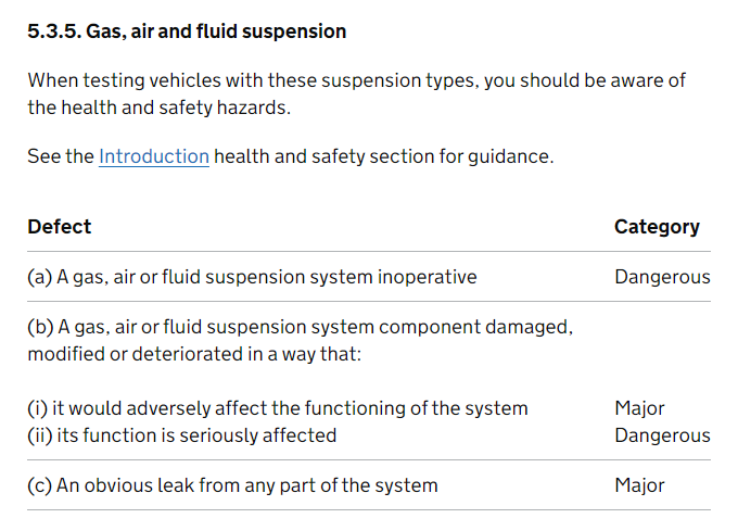

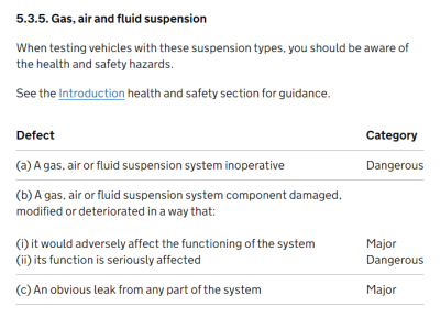

Here's the section to 5.3.5. of the MOT inspection manual pertaining to Gas, air and fluid suspension I think 5.3.5 is the most relevant, but have a gander at the suspension section, see if you find anything, I know I couldn't find anything for failing parts for being too cleanGiveMeABreak wrote: 13 Jul 2022, 12:02 That really shouldn't be necessary - can anyone show me the rules regarding failure of an MOT because a section is too clean? If it was me and there were no leaks, I would get it challenged and I'm sure they would reverse the decision. They can only inspect what is in front of them at the time. As long as it has no faults at the time of inspection, then IMO that's BS and they can't fail it.
Jay-Bruce
- Posts: 544
- Joined: 20 Mar 2019, 00:30
- x 280
Re: 2nd full MOT, car too clean.
PS, those are your only fails for fluid suspension, anything else would be an advisory 5.3.5(c) evidence of light misting but no visible leak at O/S/R shock absorber or similar wording should have been your advisory.
