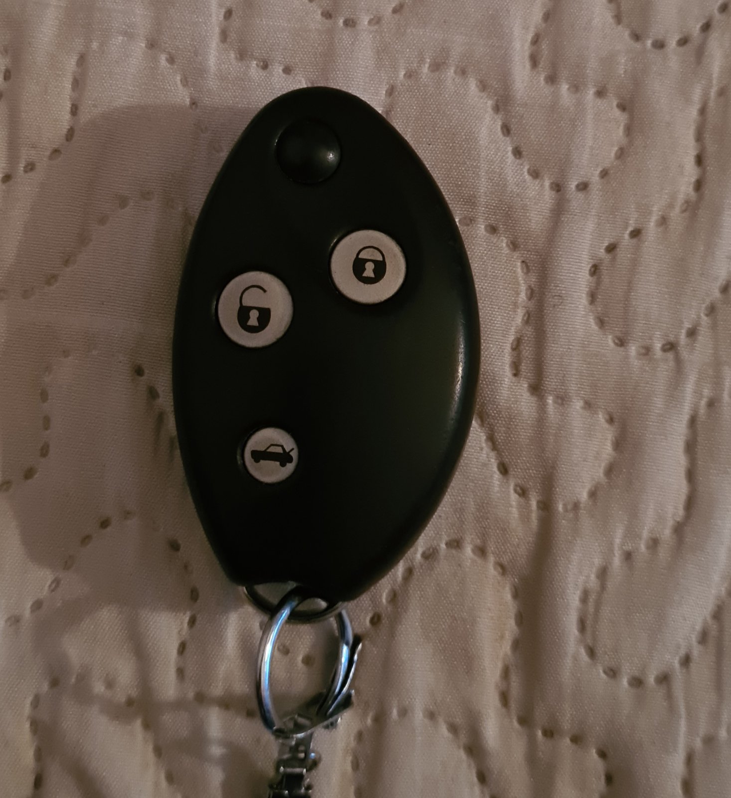

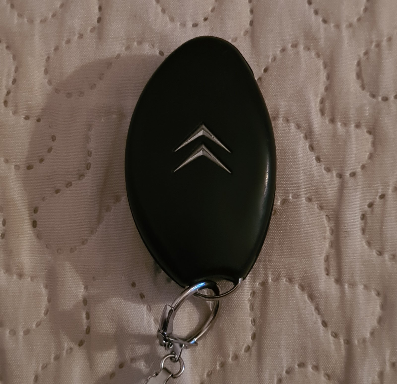

I am not quite sure if I should post pictures of my key profile on the internet, especially onto a forum where anybody from around the world could see it. I am sorry but in my eyes this would be a silly idea. Just look up a picture of Citroen C5 keys with remote. It should look something like the pictures shown down below.

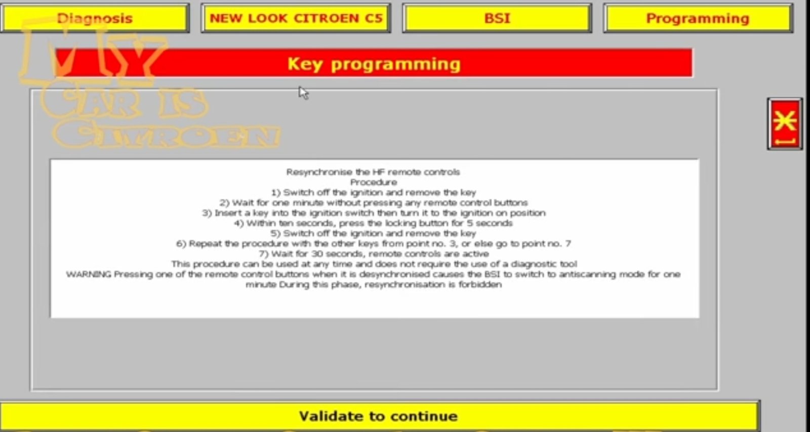

Normally when you switch the ingition on, you have 10 seconds to press and hold the lock button for 5 seconds to resync the key/s. As you press down the button, you should hear a "BEEP" sound, letting you know that the syncronisation procedure has started.
But for me it does not do that. Not even with the original one.
It even says you do not need a diagnostic tool to do that. See in the picture below:
The picture is a screenshot from the YouTube video of which its link can be found here:
The wierd thing is that I can not even resync the original one and I know that its signal is OK.

I have successfully done this procedure literally hundreds of times & never once have I heard a beep. Some other manufacturers cars beep or chime to let you know they are in programming mode but not PSA cars.Dav03k wrote: 10 Jul 2022, 22:27 As you press down the button, you should hear a "BEEP" sound, letting you know that the syncronisation procedure has started.
Might be worth trying a BSI reset then try to resync?
EDIT: I just watched the video you posted, the beep you can hear is just the beep you get when turning the ignition on.

I might try to reset the BSI, but you can clearly see and hear that at minute 4:40 an onwards in the video, the beep only occurs as you press the lock button.
