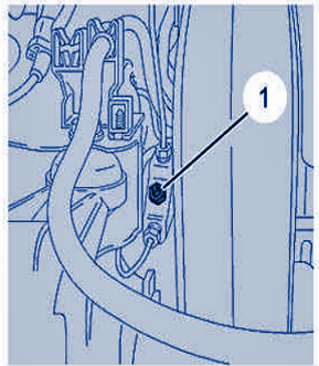

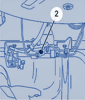

Re: C5 mk2 front one sided suspension stiff - change sphere?
The front and rear axles can be depressurised separately.
So the vehicle can be lowered and the front hydraulic circuit depressurised, then afterwards the sphere can be replaced.
For Hydractive H3 only (not H3+):
  • Start the engine.
  • Set the height control to the "LOW" position.
  • Stop the engine
Front suspension: Undo the detensioning screw (1) by one turn.
Wait for the pressure in the hydraulic circuit to fall fully.
Rear suspension: Undo the detensioning screw (2) by one turn.
bjocan
Unread post by bjocan »
Thanks for the explanation and the pictures. I have now located the bleed screw in the engine compartment. My next problem is that I can't get the sphere to move. I've read that it is best to "crack" it first with the suspension in the top position before you set the suspension to low, depressurise the system, and remove the sphere. But I could not get the sphere to move at all, even with a big oil filter removal tool.
