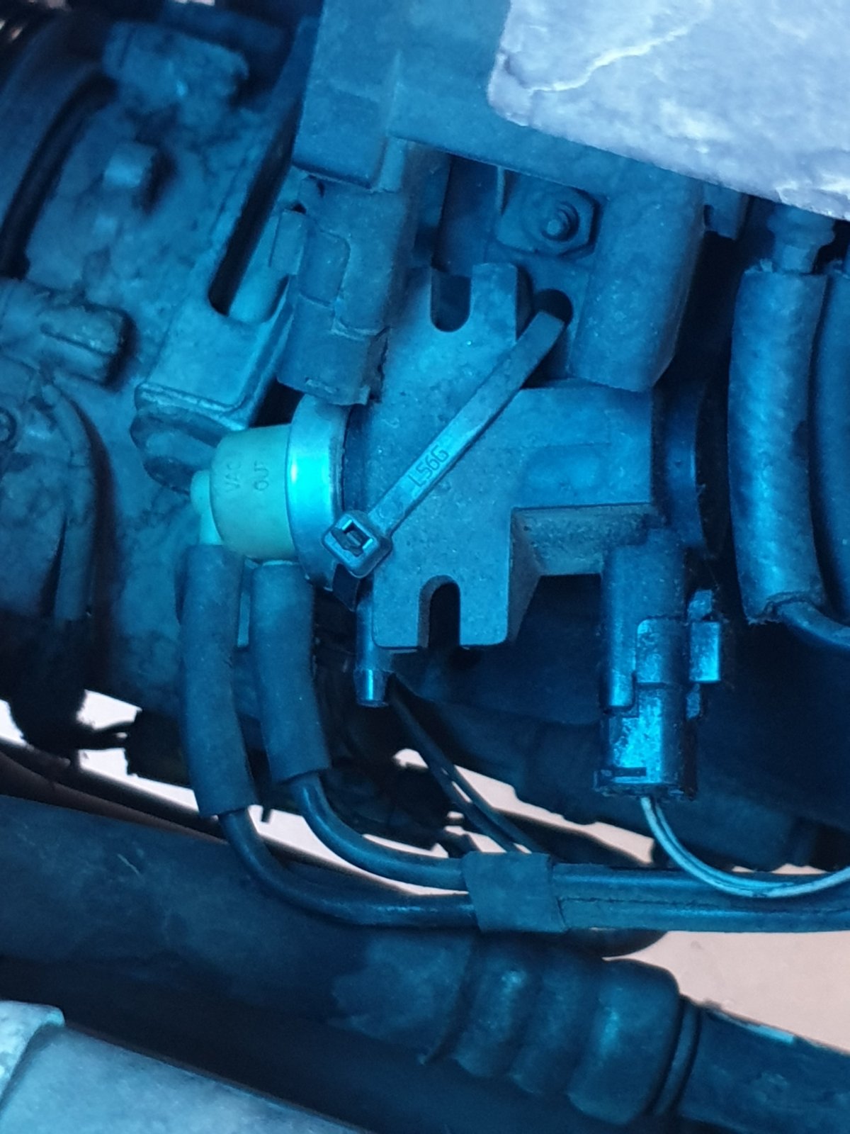

This is my first idea. Liquid (from my previous paragraph) entered turbo boost solenoid. Dont know what can I do about that, maybe you can help. But I'm sure I can reolace it myself if I find the spare part
Second option, this is my solenoid, I'm not sure if there was third pipe and if it fell off somewhere along the way, this is the pic of my solenoid:
If there was the third pipe, any clue where I can look for it can help me a lot, havent found it lurking around the bay

That boost valve has been fiddled with, sure it didn't leave the factory held on by a cable tie!
Unfortunately the only real recourse us to get it on a diagnostic computer and see what it's upset about, anything else is pretty much poke and hope.
