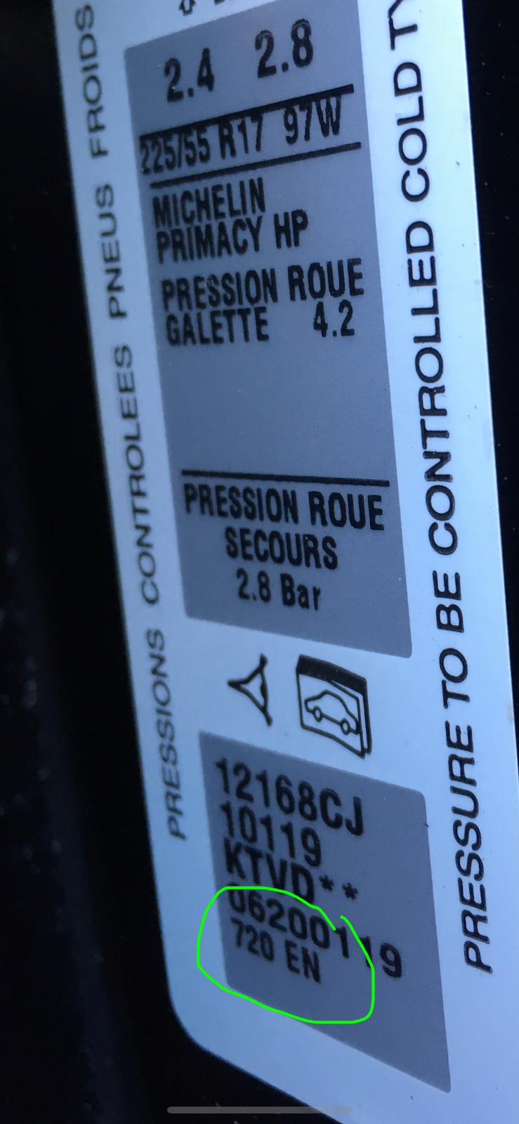

A few years back PSA started putting the battery spec on the bottom of the tyre pressure label.
As you can see this one is 720a EN & it was a regular flooded battery. If it was EFB or AGM it says this after the amps rating.
You can fit an EFB or AGM to a vehicle that was fitted with a regular flooded but personally I would only fit these if the car needed to have them. I my experience EFB & AGM dont have anywhere near the same lifespan as regular flooded batteries. I know you got 8 years out of yours right enough but im basing this on a lot of battery replacements.

many thanks for all your answers guys ! I did check the side door where the tyre pressure data is and no mention of EFB or AGM after the amp rating. thanks for putting my mind at ease
