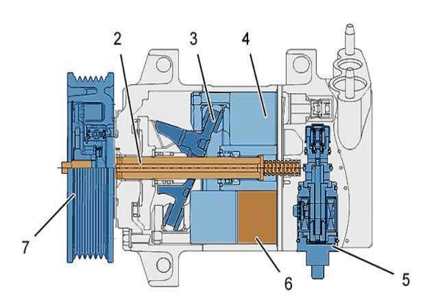

No problems, this is the A/C compressor without a clutch:
Key
(2) Compressor shaft.
(3) Oscillating plate.
(4) Piston.
(5) External control valve.
(6) No. cylinder.
(7) Clutchless pulley.
The clutchless pulley (7) is driven by the engine accessories belt.
When the air conditioning cuts in, the external control valve (5) permits modification of the pressure inside the body of the air conditioning compressor according to the temperature required by the passengers.
The modification of the pressure inside the compressor body has the effect of tilting the oscillating plate (3) so modifying the travel of the pistons (4).
The longer the travel of the pistons the greater the volume of fluid to be compressed, therefore the flow of refrigerant in the loop will increase in turn increasing the production of cold air.
When the air conditioning is switched off, the pressure inside the body of the air conditioning compressor is modified to allow the oscillating plate (3) to return to the position perpendicular to the air conditioning compressor shaft (2).
Note: When the oscillating plate (3) is perpendicular to the compressor shaft (2) the travel of the pistons (4) is equivalent to approximately 2% of the maximum capacity. When the air conditioning is not activated, the compressor continues to be driven by the ancillary drive belt.
