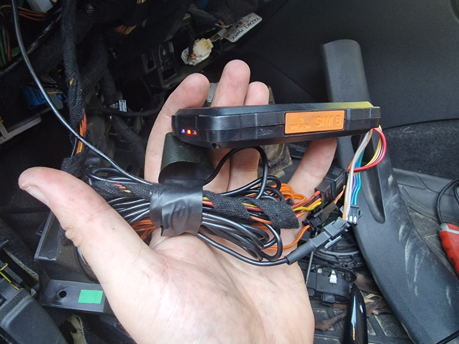

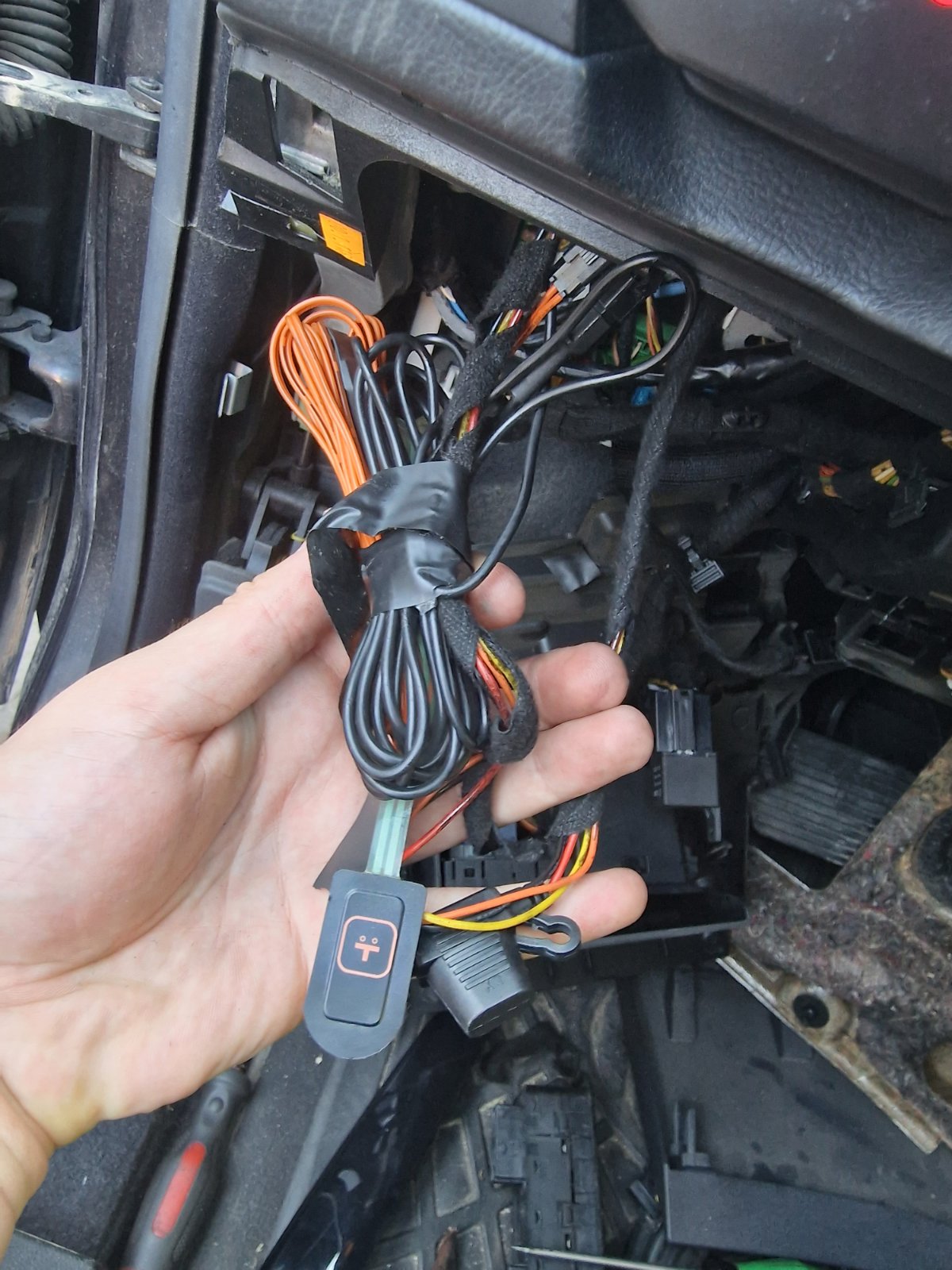

I rendered both clips to 720p i managed to attach both of them, i cant use mirascript to backup my sd card content, i pulled out content via windows i removed hidden files put sd cwrd back into module and tried runing mirascript on usb stick to backup on usb but it doesnt turn anything on, just black screen, if i got it right i can use empty sd card and bootable firmware on usb stick in car so it can make itself new partitions and new firmware? Btw i found this inside is this stock? Tracker, satelite phone what is it?

This forum can directly display YouTube videos - so if you have uploaded your videos or have them in Youtube, just paste the URL links in your post.Zn1 wrote: 21 Jun 2022, 23:59 Btw i found this inside is this stock? Tracker, satelite phone what is it?
Back to the questions:
1) No that is not stock. It looks like some sort of tracking or telemetry wiring for a black box or some other device.
