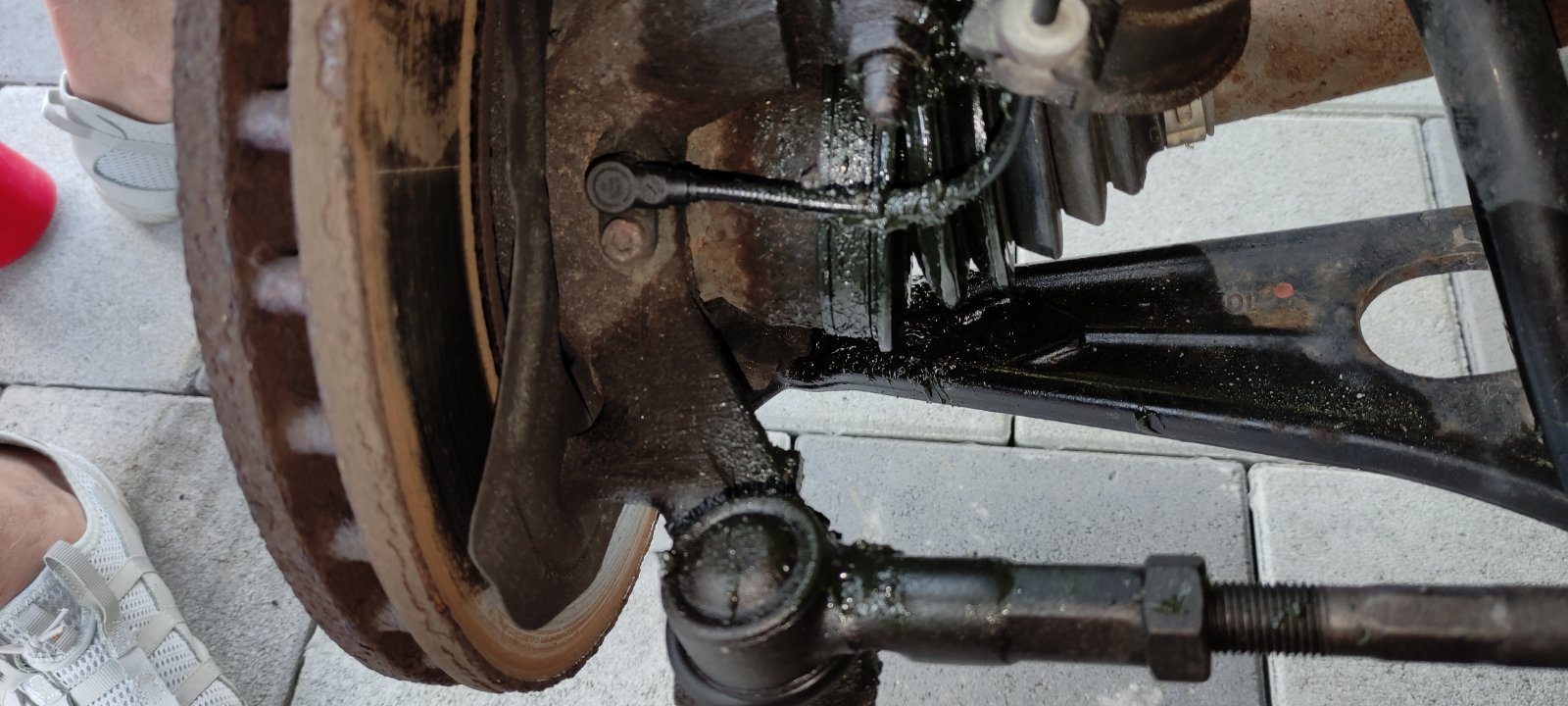

I have a Citroen C8 2.0 HDI 2011
I just changed the front rotors, pads + accessories (and leaky CV-Boot).
The pads came with cables, and I connected them to the cable plug.
However, when driving, I intermittently get the pads worn alert.
Did I make something wrong maybe?
Or do I just need to reset something somewhere in the car?
Thanks!

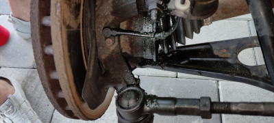

Re: C8 - Reset brake pad wear alarm?
I'm not sure what relevance the picture has?
Those aren't new rotors and the only cable showing is for the ABS sensor not the brake pads....?

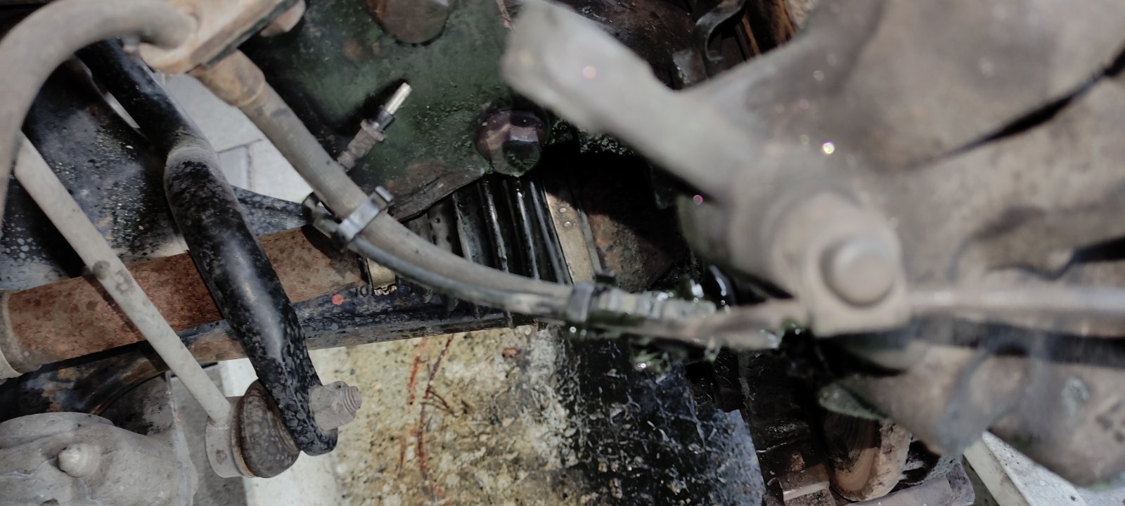

Hi Mark, I placed another picture with the pad cable.
That's the brake setup BEFORE I changed things.
x 6950
Ok, the other picture was missing when I replied.
The only thing I can think of is that there is a short somewhere along the brake pad wear indicator harness causing the warning. It is not uncommon for these harnesses to become damaged over time. I would check back along the harness and make sure there aren't any exposed wires anywhere and again, where the harness plugs into the adjoining harness.
Unread post by Rp0thejester »
If intermittent it must be a dodgy connection or wire break somewhere. Nice to see a fellow C8 driver here. But not nice if you know what I mean :wink:
