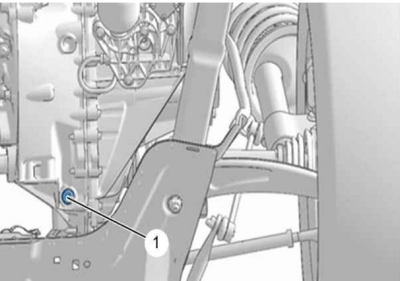

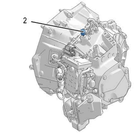

Re: Partner 6-speed gearbox oil top up
I don't have your specific gearbox available, but this is for an MC gearbox (note ignore the additional parts on the second picture as this shows the piloted version with actuators that you won't have).
Normally you would remove the plug at (1)...
... then refill at 2 via the vent hole. It should be similar, but I can't tell you the exact amount of oil to replenish for your gearbox from drained - some are 2.1 litres after draining and only allow for +/- 0.1 of a litre difference. I just don't have the data for your gearbox, so can't advise.
